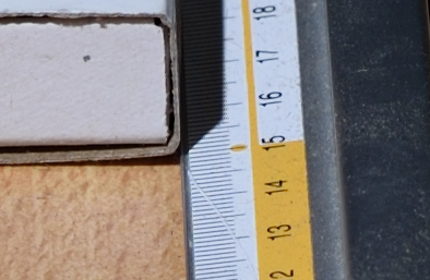

JPG, cropped from raw.
85mm at 4,9 ft (1.5 mt)
With crappy tripod but speedlight and 1/200 SS, f/8 and ISO100
Looks razor sharp to me, considering that those are tiny millimiters...
Amazing.

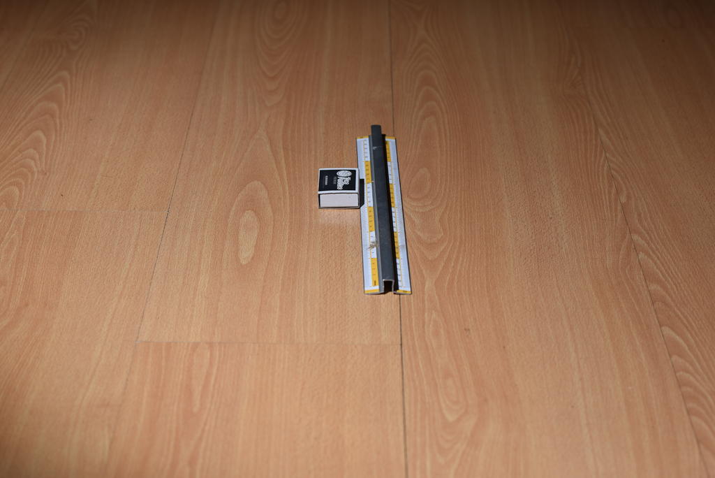

Dear all... I casually discovered the origin of the "ghost" issue... Is not the tripod...
Mirror slap or shutter shock... This explain the vertical motion blur that create two images.
I did some test with hand held camera and when i use viewfinder I get motion blur. When I use live view (mirror up) the image is sharper.
This is quite visible up to 1/80 I'd say and even with a 35mm.
both 35 mm / ISO 100 / f10 / 1/50
Viewfinder vs live view
(the bigger text is around 4 millimiters)
