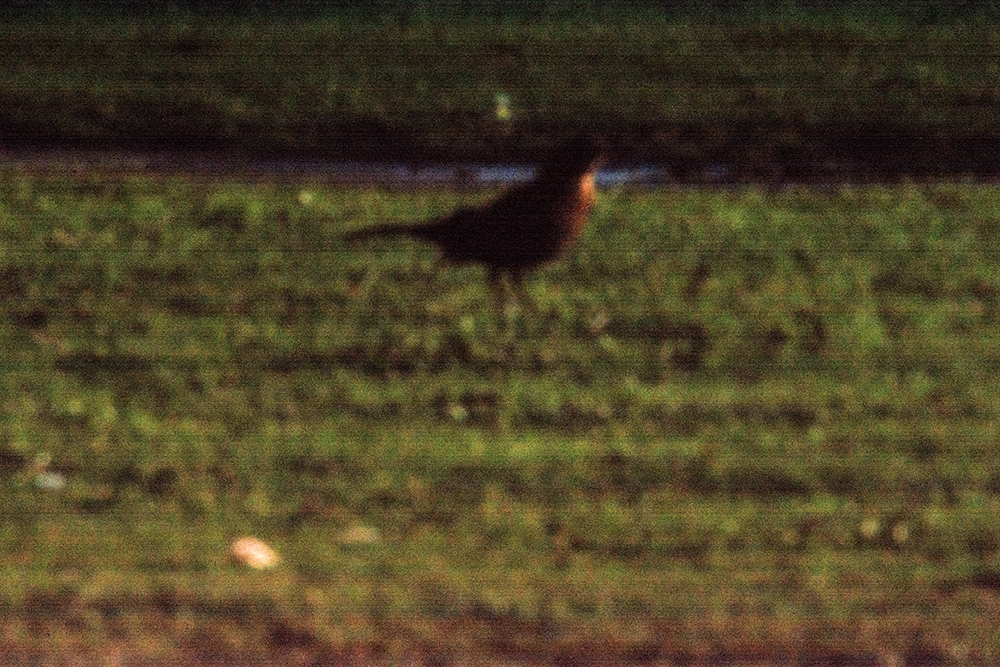

When i got back today i had two black frames that coincided with the first lock up,there is an image on them but its well underexposed and the exif has recorded the shutter speed but not the F stop so this points it back to a communication error between the lens and camera.
This is one of the black shots as is and after PP.
I Like the First shot Better :) It looks like one I would Take :) It has Color and Composition :) :)
