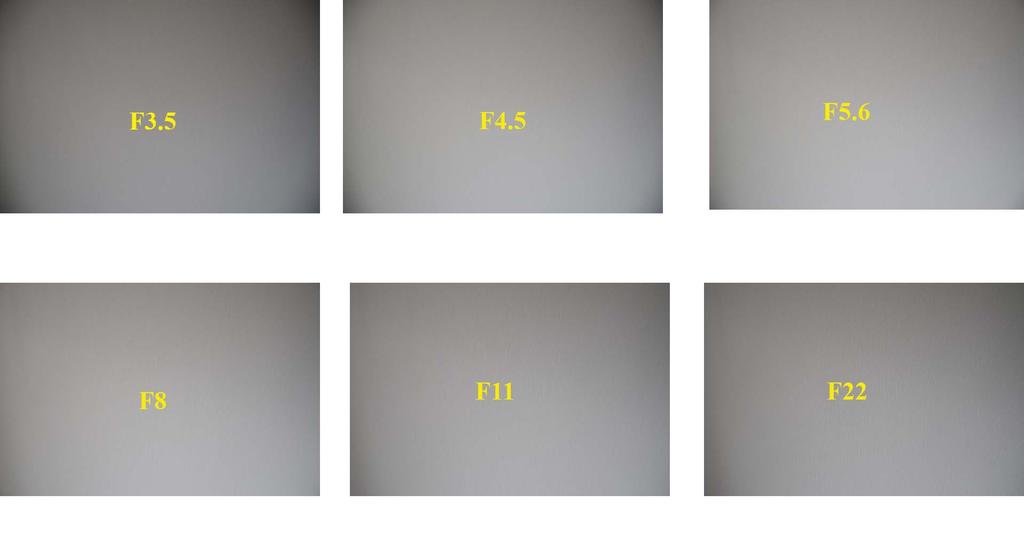

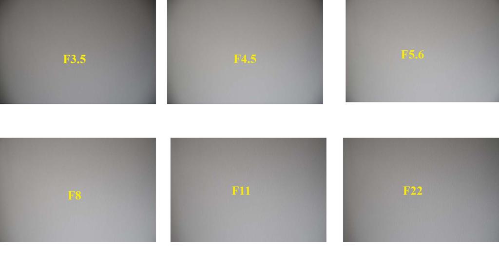

Funny, I was slightly skeptical when I first read your original post and then became concerned after looking at my own photos. I think I had already mentioned something about overexposure in another thread but assumed it was my fault for not having set the camera up properly.
Anyway, I think that the way I presented the photos in the table may have made them look more similarly exposed than they are. I have flipped the f22 image and put it next to the f6.3 image so that they mirror along a common edge and then again, vertically, to give a better idea of the difference.
I removed the images because they only appeared in a useful configuration on certain sized screens but I could not find a way to remove the attached images which were added accidentally, so I have dleted the post and reposted it without any images.
Instead, the X & Y mirrored images can be seen below the table of images on the URL posted earlier:
Nikon D5500 Exposure Test

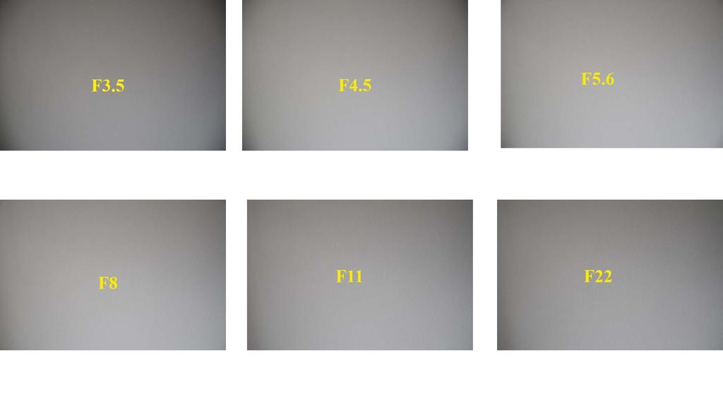

Hi Okulo
I've managed to duplicate your photos on my system - see the results fro yourself ! Results are very similar to yours !
Brian

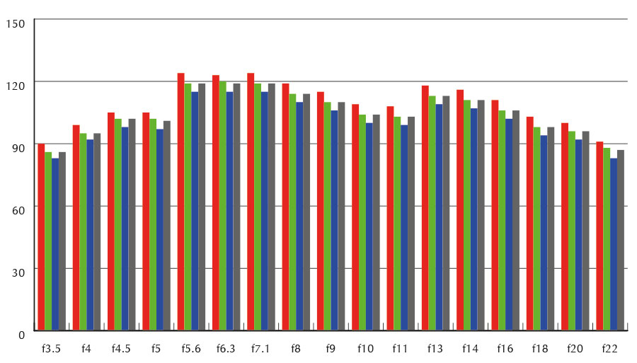

I'm afraid I haven't got around to speaking to Nikon yet; too many balls to juggle at the moment, But I have created an exposure graph which I want to produce before I phoned them which I have added to the page I posted previously.
I took an 11x11 sample from the same point on each image (bottom right) using a grid in Photoshop to ensure I got the same area. I then took the RGB values and an average to plot the graph. It's not as smooth as I expected but there are clear increases in exposure in the mid f-stop range which approximate to 33% higher than the extreme f-stop values (f3.5 and f22).
None of this is completely scientific as RGB values in Photoshop do not equate to exposure but it is indicative of exposure inconsistencies.
