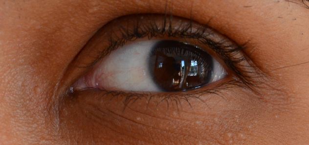

@Mr Rexer John:
i watch a video on youtube "picturing" the same issue that you are relating..
am posting a picture below.. i focussed on the eye, and witness no issue with it.
care to explain the real issue.
a simple tutorial that will put forward the issue that you discussed will be helpful;
thanks..
f8 - 1/320 - iso1600

@Mr Rexer John:
Before I adjusted the camera, when focussing on any object, the focus point was perfectly in focus.
So why make any adjustment I hear you shout.
Well... The focus point was in focus, but the depth of field was 2 thirds in front of the focus point and 1 third behind.
I believe this is called front focussing or front focus bias.
Have a look at this link
My camera would focus great in live view but on normal auto focus, it would focus on 2 & 1 in front of the and 1 behind.
I guess I was a bit picky because all lenses have their own bias but my lenses were varied between correct and a front bias. Now they are much more centred.
