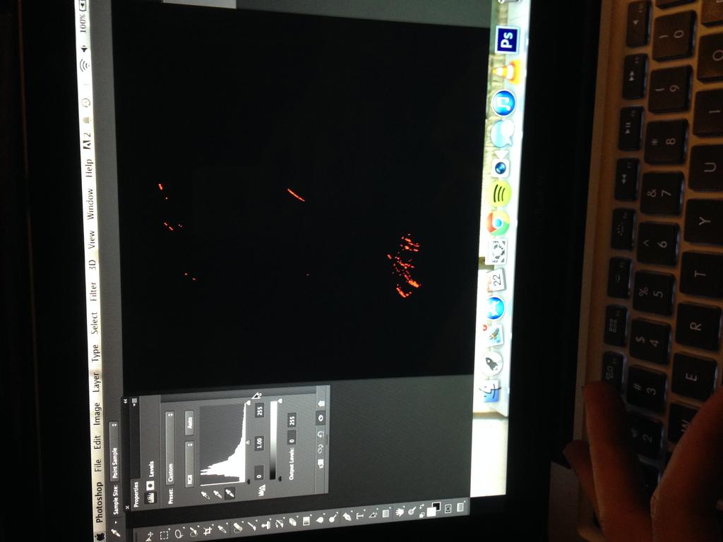

On the top image (which is less seriously clipped)... Hold down ALT or OPTION key and while holding, then slightly touch the Levels White Point slider (you do have to move it, but only the slightest amount), and the preview image goes all black, except ONLY the bright lower red leaf is shown. The full lower bright leaf, and several more higher above it.
That is saying those pixels are being clipped at the, say 254 position of the slider, which says those pixels you can see are brighter than the 254 (or whatever value). Which if 254, those pixels are clipped (perhaps just one channel, red here).
Yes, I just Copied and Pasted (clipboad) your two images to my editor, and used the levels tool there.
Also try it on an image that is NOT CLIPPED, and you will see you have to slide the slider very much lower, much less than 254 probably, to see any pixels other than black. This is then telling you the pixel value of those pixels.
The regular color Eyedropper can also tell you this. That bright lower leaf is about color (255, 0, 74), which is clipped in the red channel.

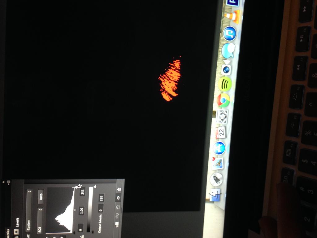

Ok so this is what I see when I do what you're saying:

Ok so we're seeing pretty much the same thing on that picture except yours appears to show it's clipping more than mine does. I'm going to guess and say that has something to do with your screen grab of the pictures and me having the raw files? Maybe the reds appear slightly more exposed on your computer than mine.
So now how would I fix the remaining areas that are clipping without reducing the exposure too much or would I just live with what I have now?
