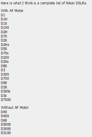

Hope this helps anyone wondering about motorized bodies and non motorized bodies:
ckm
This is great news. I must have been thinking of the D60. I'll run over and check out my suspect lens on my sister-in-law's D90.
