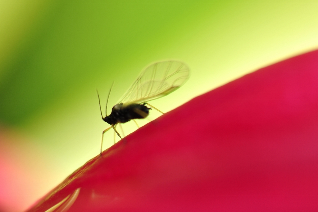

slowpoke
I use my 18-55 kit lens and reverse ring on my D90.I wedge the aperture open with a piece of plastic.Put the D90 on manual and have fun. 211 (1024x685).jpg
Just a thought.
