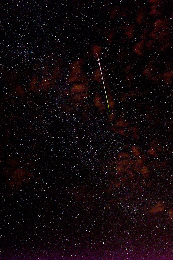

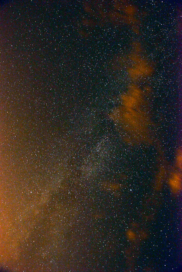

Here are a couple stills from the night:
