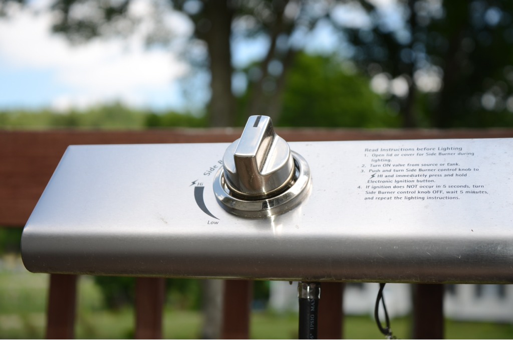

Let me see if i can post a couple now. It says my files are to big.
