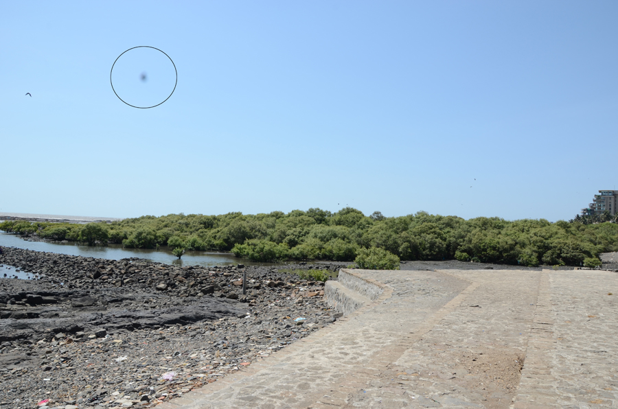

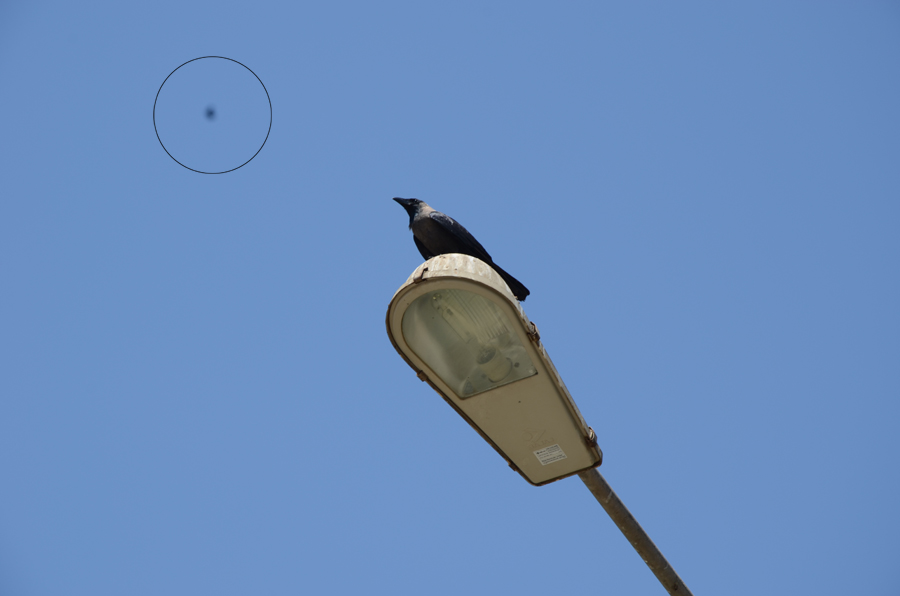

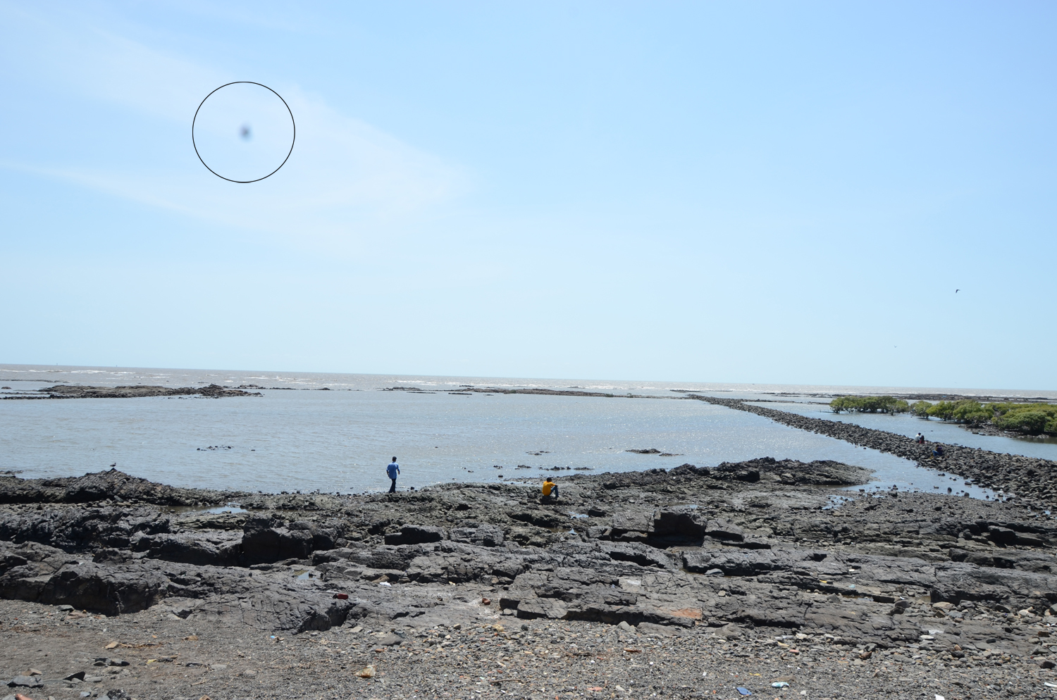

please help me...whats the wrong with my camera...there is a blue dot in upper left in every picture. is this because of dust or problem in sensor.
thanks.

Yes, this sure looks like dust on the sensor.
Cleaning will take care of it.
You can have it done or do it yourself if you want. Google sensor cleaning and you'll find many tutorials on the web that explains the process.
After reading all this, I still had it done on mine but insisted to assist so I actually watched how it's done. Now I do it myself.
But if you are lucky, sometimes just a blow of air can dislodge it so you don't have to resort to wet cleaning.

If it happens with only one lens it could be dirt on the lens or inside the lens. Otherwise, yeah, it's dirt on the sensor.

It's something on the sensor - at f/7.1 it's larger and fuzzier. At f/13 it's smaller and clearer. Try cleaning the sensor with a blower first, if that fails, you'll need a wet clean. I wet clean mine every few months - it takes about 5 minutes with the right tools for the job.
