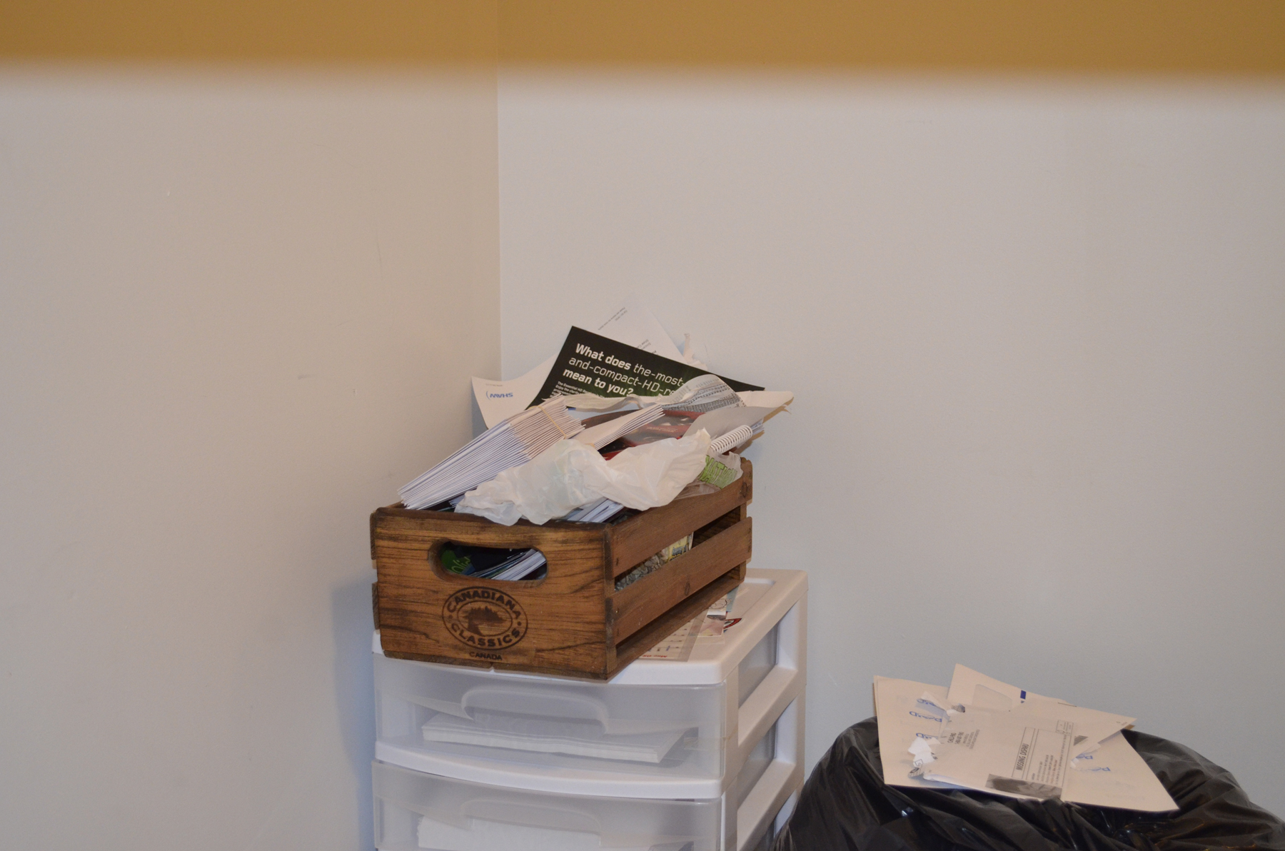

I'm hoping someone can help me out. I have a D5100 and lately when I shoot with the built in flash, it leaves a shadow across the top (is shooting landscape format) or down the sides (if shooting portrait format). Can someone tell me why my camera is doing this and how to resolve the problem????

I am using my shortest lens (18-55mm) without the lens hood. Also, I just added the SB 700 and its not helping. I have read elsewhere that it my be that the shutter is not releasing properly? Any other suggestions?

Oh, and I should add that it is a rectangular shaped bar across the top or side of the photo...often it runs the length of the photo...

I just took this about 5 minutes ago...you can see what I mean about the shadow. I shot this using Auto mode. In experminting with Shutter Priority mode I noticed that the slower the shutter speed the less shadow there is. The faster the shutter speed the worse it gets.

Generally you have to shoot between 1/60 and 1/200. I can see you shot this at 1/60, is there a setting on the flash?

I'm a beginner at this so bear with me. The flash is set to Auto at the moment and the photo was using the built in flash not the add on.

This doesn't look like a flash shadow to me, as a flash shadow would be dark. Looks more like it could be a shutter sync problem. Hopefully it's still under warranty. I would suggest you take it to the dealer you bought it from, show them this picture, and see what they have to say. I'm inclined to believe it's a mechanical problem with the shutter.
