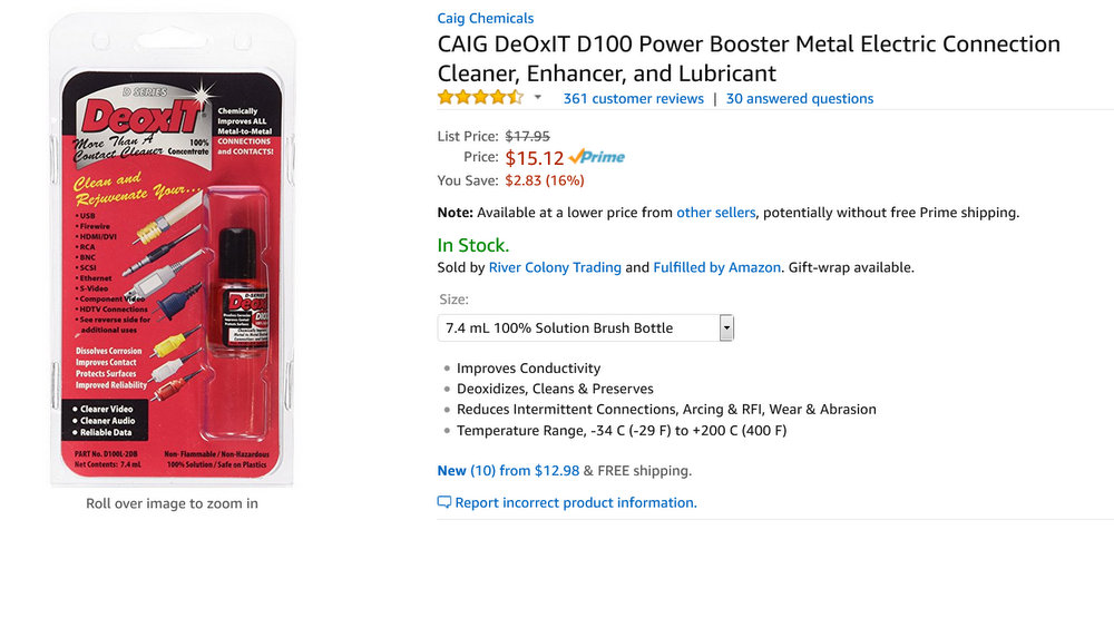

So, the product, DeoxIT-100, bills itself as a "metal electric connection cleaner, enhancer, and lubricant". The TG's referred to it as, "damn near miraculous." As instructed I applied a tiny bit of this stuff to a microfiber cloth and sat down to clean the contacts on my camera bodies and lenses. Before cleaning them, every contact appeared quite clean and shiny to me; nothing appeared visible to the naked eye, not even with my readers on. This being the case I was VERY surprised to see how much brown and green "gunk" came off of every set of contacts DeoxIT touched. After wiping down the contacts specifically, I wiped down the rest of the mount. Very little residue came from this, but there was some.
Now, that being said, I can't say any miracles occurred. Nothing fantastical happened to my camera bodies or lenses after using DexoIT but neither has anything else I've used showed the kind of result DeoxIT did. And again, every contact appeared to me to be perfectly clean to begin with. I tested DeoxIT directly on the plastic of my lenses and I got nothing from it; so it's not doing anything to the plastic that I can tell; all the gunk I saw came from the contacts themselves and too a less degree from the rest of the bayonet. Maybe some other product works just as well but my TG's swear up and down DeoxIT is the best thing for electrical contacts since sliced bread.
For anyone interested here's the exact product I have: DeoxIT D100. The bottle is really small (7.4ml is .25oz) but a tiny bit goes a long way. This one bottle is enough product to last me for years. Based on my experience I'm very impressed. If you're in the market for something to clean your camera/lens contacts I think DeoxIT is worth considering.
