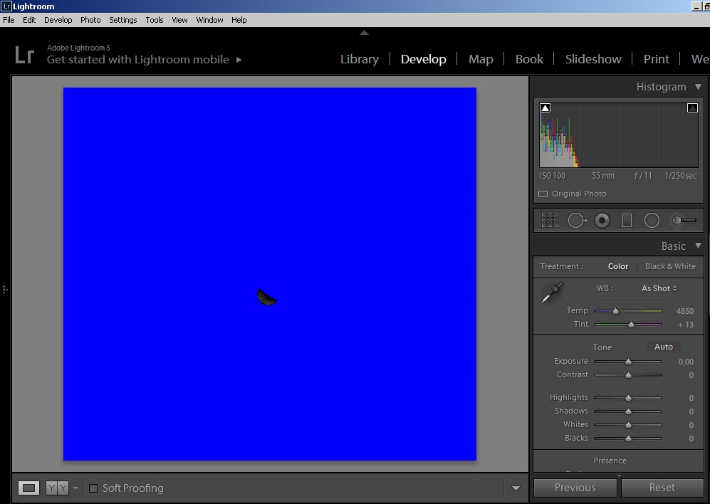

Hello, I am trying to fix this shot of first quarter moon, 52%. This is a nikon d5300
But when visualized in Lightroom, it shows everything blue. Now Ive got confused with the clipping and highlight stuffs. Looks like the histogram is all messed up. Any tips on what to do on this photo? Thanks!

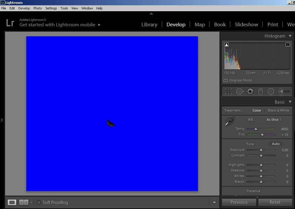

In the histogram, the upper left corner turns on shadow clipping. Basically, anything totally black in value will show blue.
It appears that you have shadow clipping enabled, and you have a very dark image that you are displaying.
