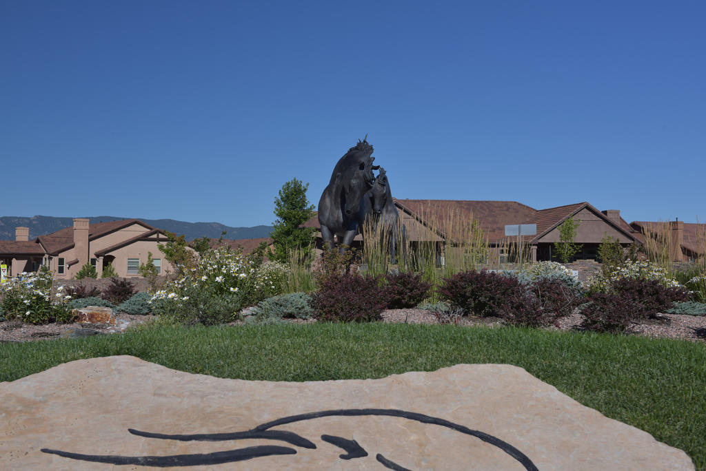

I held back posting for a while to get some shooting under my belt before making any comments.
And I will say that in a "lot" of cases the meter is getting it correct - but in strange cases it is not.

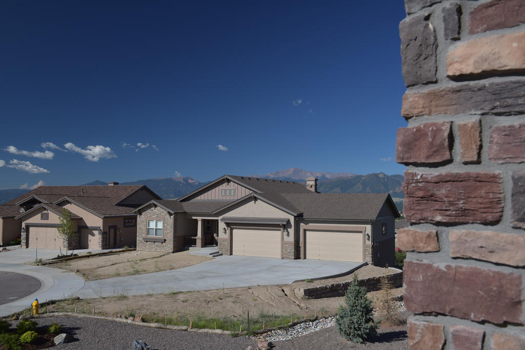

Here are some examples - I shot some real estate photos, outdoors in bright sunlight with both my D700 and the D810 and the D700 nailed it every time - the D810 - not so much.
It seems that the D810 is 2/3 stop underexposed most every time with these kinds of photos? And this is evident because the following day I had to finish the shoot, and so that I was not wasting me time - I bracked with 5 shots at 1/3 stop ea and consistently - anything with sky and ground under exposed
If I shot the trees in the forest - it did fine.
I shot some auto races on the infield of a NASCAR track - and it did fine.
I'm totally confused as to whats going on and why it's acting the way it is? I'm sure it's something I am doing - I just can't figure it out?
In matrix metering it is seeing the sky and compensating by cutting the exposure to compensate for the brighter sky. In your house photos the sky looks great. You can change to center average and it will shoot more fore the houses or you can use the exposure compensation to bump it up. What I would do in these shots is just bring up the shadows in post by 2/3 stop and get the sky and house just where I wanted it.
