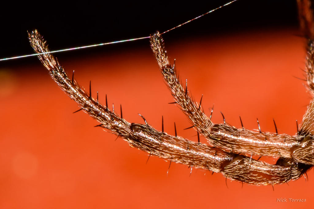

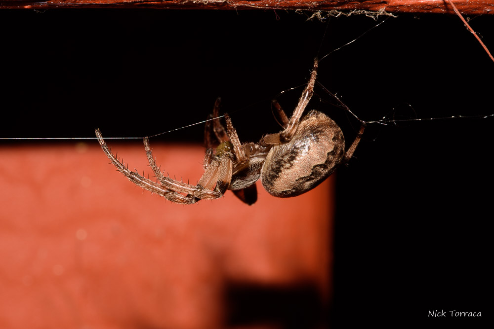

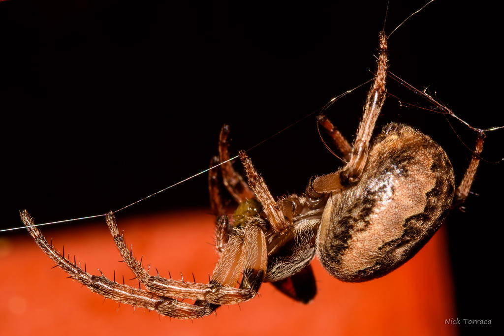

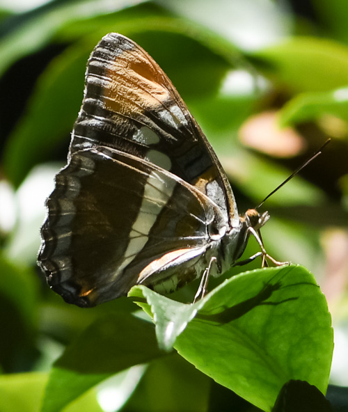

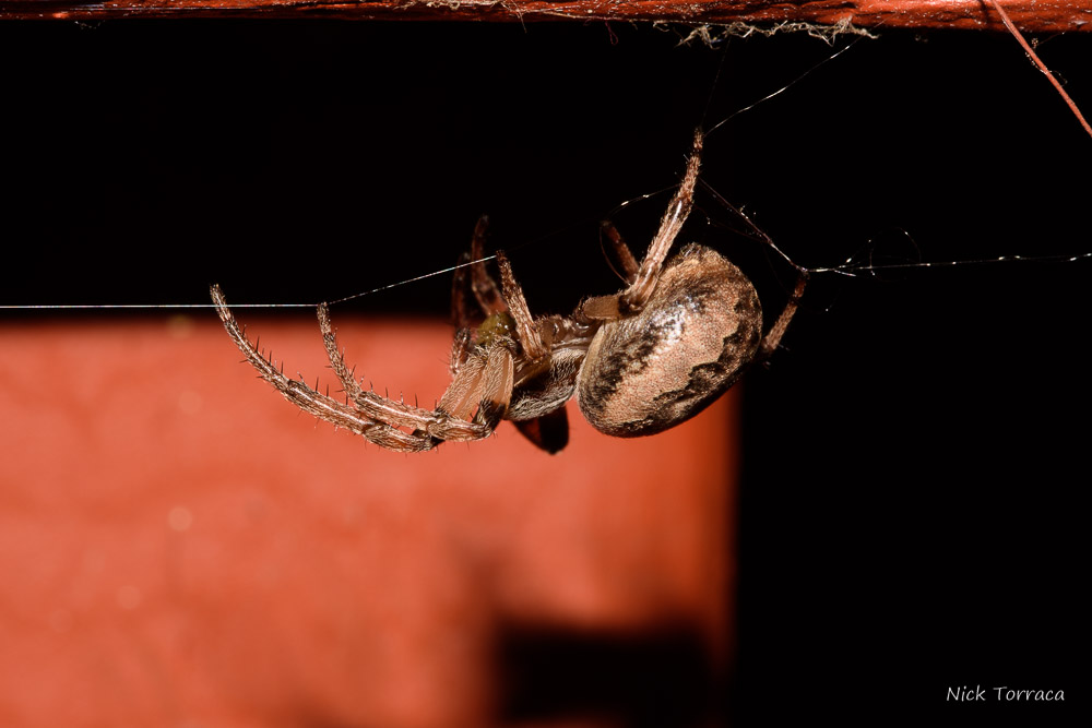

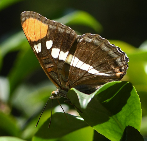

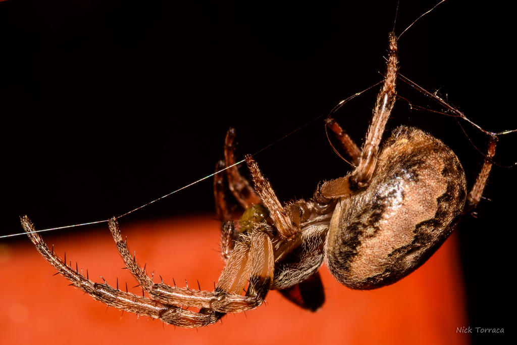

I am really impressed with this camera. The camera and the lens are a bit heavy but you get great pics. I am on the fence on whether to purchase the D500 or the D7200. The menu system can be intimating on the D500. How do you guys setup the F1 button and F2 button for Macro and Birding photography? I do have a question about lenses. I plan to go for the Sigma 105 Macro lens, do I need to purchase a teleconverter from Nikon or Sigma? Here are a few of my photos. I would like to get a little closer. Any suggestions would be great.
Whiskeyman
If you want to get closer, get extension tubes in order to allow focusing at smaller distances. If you want to enlarge the subject image upon the sensor, get teleconverters.
WM
nickt
Also, an extension tube will not degrade the image, there is no glass in it. A teleconverter will degrade some. But with the extension tube, you will lose infinity, that is, you won't be able to focus at a distance. So you will be stuck doing macro when the tube is installed.

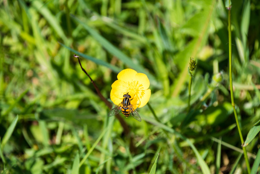

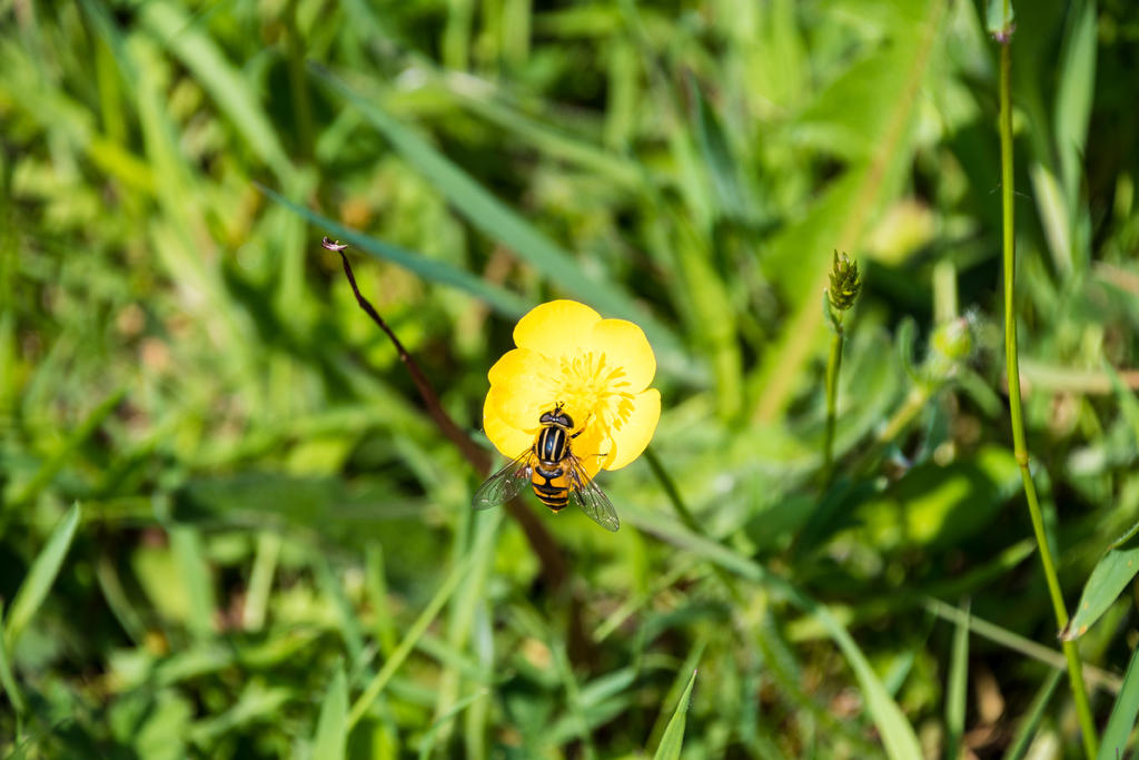

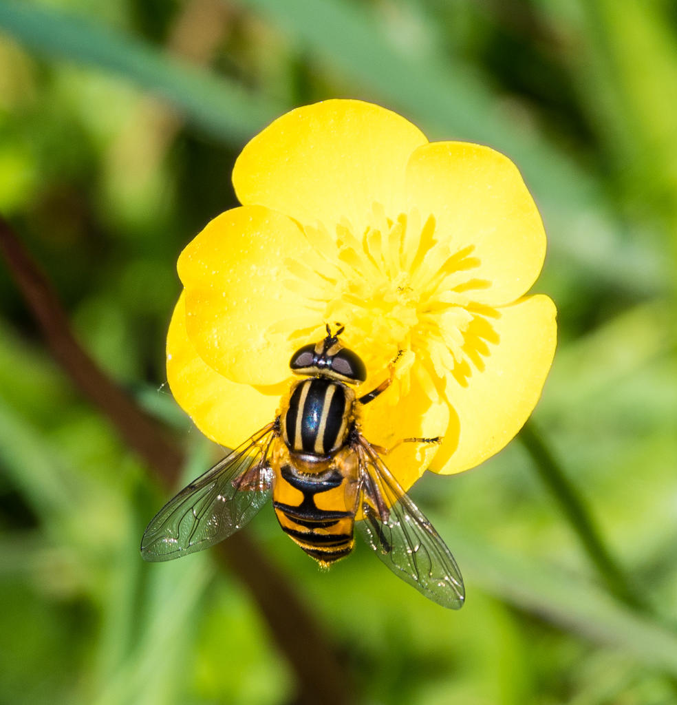

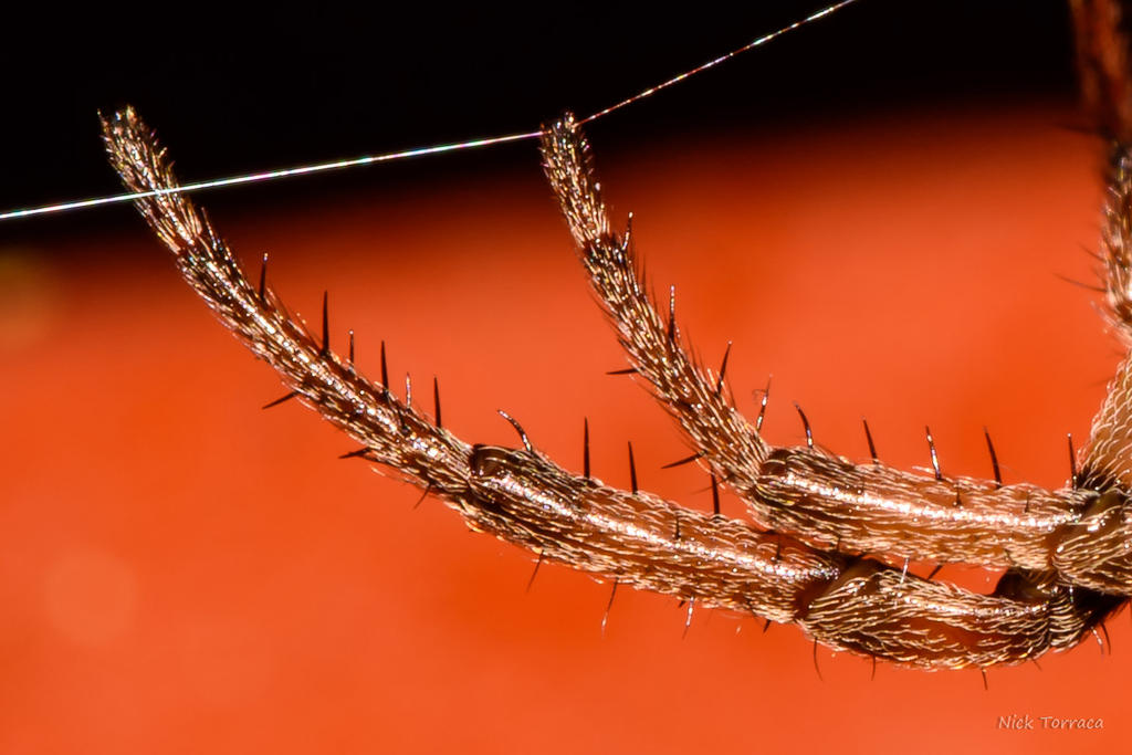

How close do you want to get? Here is a shot with the Sigma 105 and d7200. Original and two crops of the same shot.

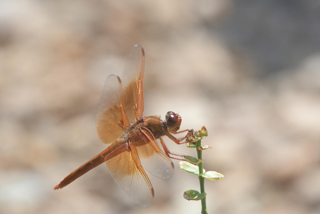

I don't have the 105 Macro lens so I am forced to use my 200-500 for bug pictures. :)
This from about 7 or 8 feet. No crop straight from camera.
This looks somewhat better at full 7.57 file size.
