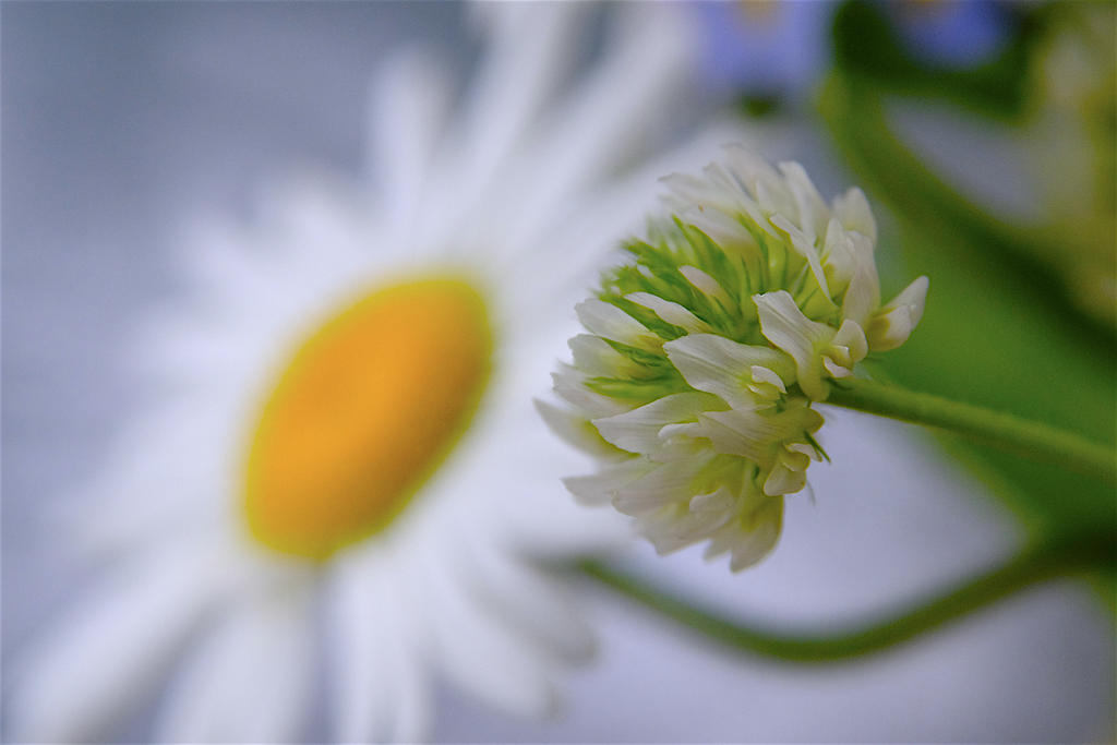

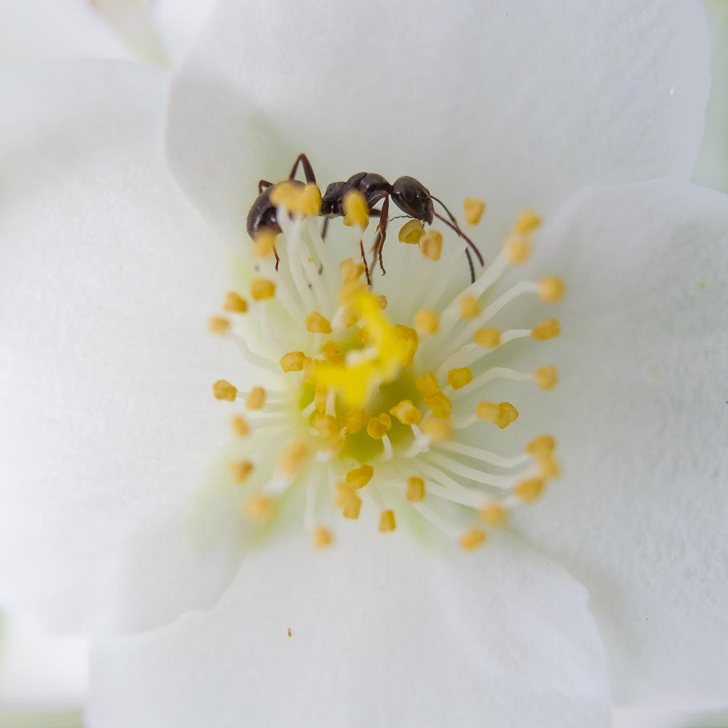

[MENTION=6277]Don Kuykendall[/MENTION], I don't know if you did get the tubes for you better half, but I thought I'd give you some example shots done with the 20mm extension tube and my 125.00 $ Tamron 28-200 3.5-5.6 lens. The thing with ext. tubes and a zoom lens is that the shorter the focal length, the closer you can get. For example, for the ant picture in the flower, the lens was about 1/2" from the flower, and you get a bit more dof with a shorter lens.
Pics were done with my Fuji, but it's an APCS sensor so close to the 7100.
This one was done with the lens at 200mm
This one at 28mm.
