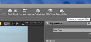

I'm not sitting behind my home PC at the moment but I'm pretty sure if you open an image in ViewNX 2, and look to the top right, isn't there a "Convert Files" option showing? If you click on that button I'm pretty sure you'll get a slider-bar that allows you to adjust for output quality of your .JPG files as well other options.
I am going by memory here (and I'm not a huge fan of ViewNX to begin with) so... I could be totally wrong on this.
