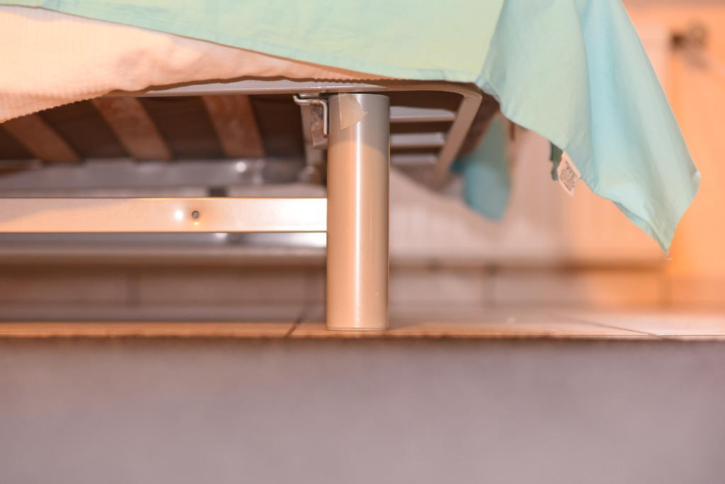

I made an example to show you my problem and I hope it highlights successfully what my problems are
I am at matrix metering at f/2.8 iso 800 (that is typical for indoor). AUTO ISO is off. Shutter speed is around 1/8 that allows enough light to register. According to ambient light meter I am at +0 which is what I am going for.
Lets see the shot now, that is a typical shot with ambient light. Some light is coming from the living room bulbs and thus the orange color and some color behind the bed giving that blue hue at the back
now I plug the sb-700. And I see the image TTL BL. I dial in camera FEC -2 (I also tried with FEC 0 at camera at -2FEC At the flash body). Both settings give the below shot.
I tried with an sb-500 as well with FEC -2 and I got exactly the same shot
Now to me this is not a FEC -2 but closer to FEC 0. Unfortunately I do not know thow to share the histograms of those two shots here.
For me FEC -2 is fire that much flash to lift shadows from the black point closer to the mid tones.
What I get is closer to what I think FEC 0 should be. The shadows are lifter over midtones. This flash shot above has blinking highlights as well.
Where I am wrong with that then?

WayneF
FWIW, Exif says ISO 1600 in the first one.
I assume Incandescent white balance, or Auto WB giving similar, so the blue background is window light, Daylight light, wrong for Incandescent WB. Mixing light sources is generally impossible, WB can only correct for one of them. Any try at a "compromise" WB will simply be wrong for both then.
FEC in camera and in flash body simply add to a total, so these two are the same thing, they add to the same total. And camera EC also adds to it, unless overridden in D750 menu E4.
Regards
Alex
The camera meter we see (indicating 0 EV now) is only reading the ambient exposure. It is not affected by flash. Flash has not fired yet, and flash has its own invisible metering system anyway. But flash will contribute to total exposure.
It does seem a bit bright, but you are fully exposing the ambient with ISO 1600 and 1/8 second and f/2.5. Any additional exposure from flash adds to add to be more than that existing full ambient exposure. -2 EV flash compensation will add and lift fully exposed ambient by 25%, which is 1/3 stop overexposure of the near foreground affected by flash (flash percentage calculator at Flash pictures are Double Exposures- Outdoors ).
Remember that you are affected by Nikons TTL BL automation. If the scene is brightly and fully illuminated (as here, with your ISO 1600 and 1/8 second and f/2.5), then it automatically provides less flash fill, trying to minimize overexposure by adding flash. Automation interferes with your own efforts, automation knows what it is trying to do, and it can sometimes tend to ignore you.
Saying, in this TTL BL case, I really doubt you will see any difference between -2 EV flash compensation, and 0 EV flash compensation. Automation has its own goals. I am agreeing with you, but you may not like my reasons.

alaios
So I have spent one more evening trying.
I think I get closer to what might be the problem. I think it is not that the camera ignores my -3 FEC but it does not have any more latitude for weaker flashing.
Let me try to explain
at f/2.2, 1/200 iso 1600 and subject being around 2-3 meters if I turn to manual my flash and fire it at 1/128 (which is the weakest output) that simply blows out completely the shot. With all the histogram being from the middle area to highlights area full.
When I turn to flash to TTL at FEC -3 I get a better shot that looks just properly exposed (like +0 FEC) which I guesss hows that my flash can not simply flash at a lighter intensity (and this also explains why FEC -3, FEC-2, Fec-1 and FEC 0) are all alike.
Now the tough part would be to know in advance when I get on these "areas" and being able to make aperture smaller or reduce iso.
Since I use manual mode so to have my shutter speed at 1/200 it is still a question on where I should have my iso to still
1. allow my background to register
and
2. being at a region where my lowest power of my flash would not make shot to be blown completely.
Last question since I am using manual mode to have a shutter speed I need, I wonder since I have my iso fixed and aperture, then turning the EC dial would make it equivalent to FEC.. right? Since now the EC only can change flash output since everything else is dialed in.
Let me know where I am wrong in all above
Regards
Alex
