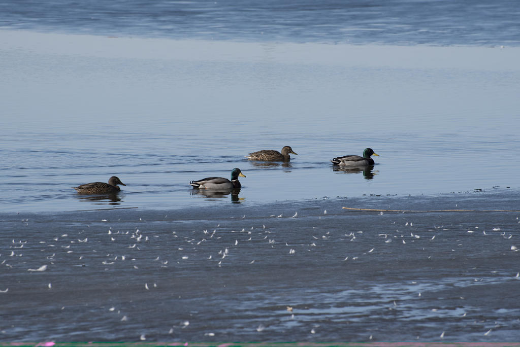

This afternoon I took several images at a local park with my D750. Slot 1 is NEF and slot 2 is jpeg fine. When it came time to convert the NEF to DNG, this one file cited an error and couldn't be converted. The slot 2 jpeg image doesn't have the banding at the bottom like this NEF image. The NEF image was only resized and converted to jpeg. No other editing was done to it.
The card was formatted prior to shooting any photos as I tend to reformat between outings. Thanks for any ideas.

Obviously something caused an error while the file was being written to the card, but it makes me wonder if it was the card or the camera. This was only the 2nd shot out of 23 taken at that time and the only image to have this problem.
General question for anyone: will the card be okay to continue using after it is formatted again, or might the card be corrupt? In other words, once this happens with a card, does it tend to continue happening? Or might it have been a one-time fluke? The card is a Lexar Professional SD card, 32GB, Class 10, 600x speed.

Likely a write error. I had a card go completely bad on me. Thankfully I can read it in my MacBook's card slot, but it will not format in any camera I put it in. First card I've ever had go bad on me that way.
Would I continue to use it? Not without changing slot two to be a mirror for slot 1 instead of for JPEGs. A single failure is always a crap shoot with regard to predicting recurrence. Cards are relatively cheap, but some images are irreplaceable. I'd at least swap the primary and backup. At least your NEF file was readable.

I can open the NEF which is what I used to covert the above image to jpeg. The file just won't allow conversion to DNG. The image itself is simply OK but isn't one I particularly want or need to keep.
HOWEVER, there is something oddly familiar with seeing this greenish pink band along the edge. I'm sure it happened a long time ago...most likely with my D90. At the time, I didn't give it much thought and can't remember if it was a jpeg or NEF.
