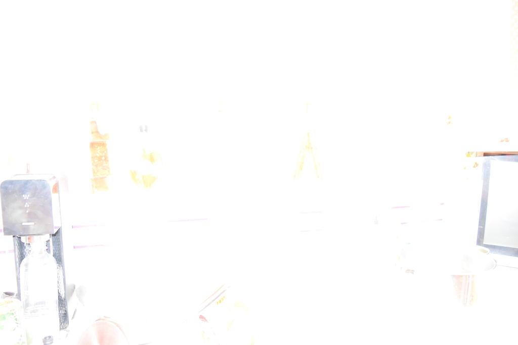

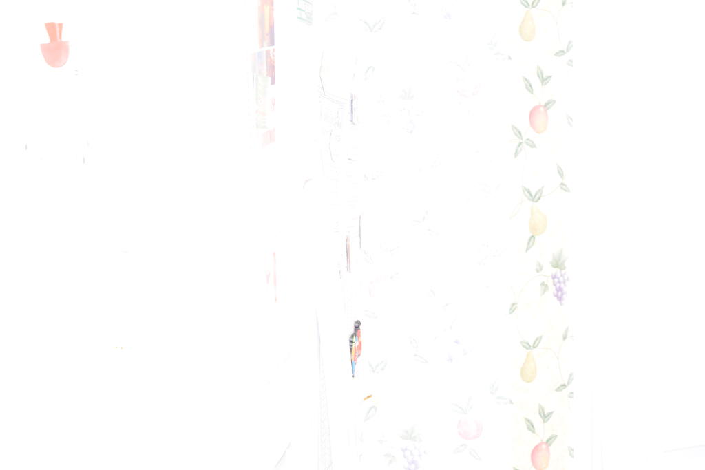

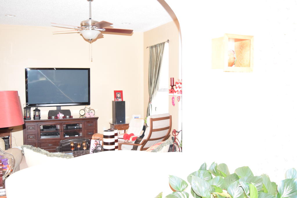

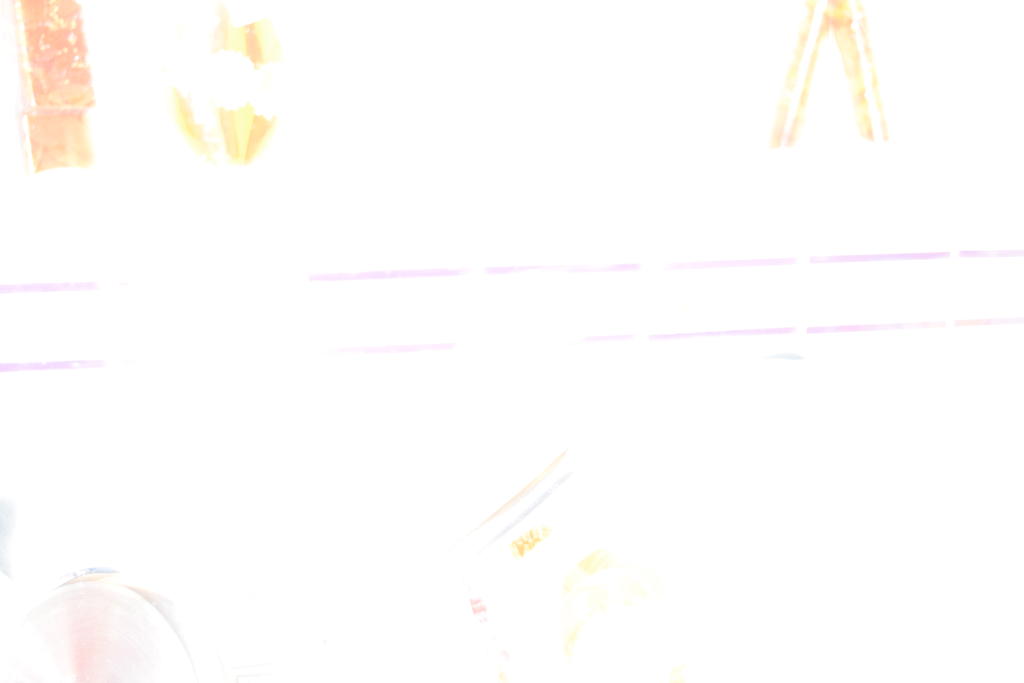

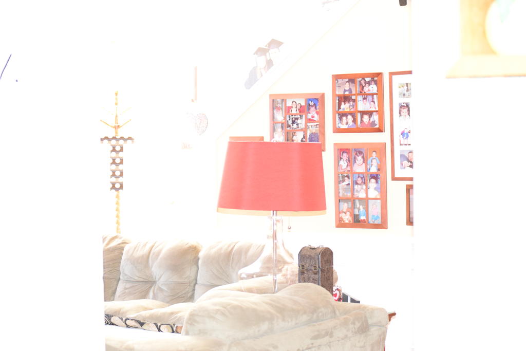

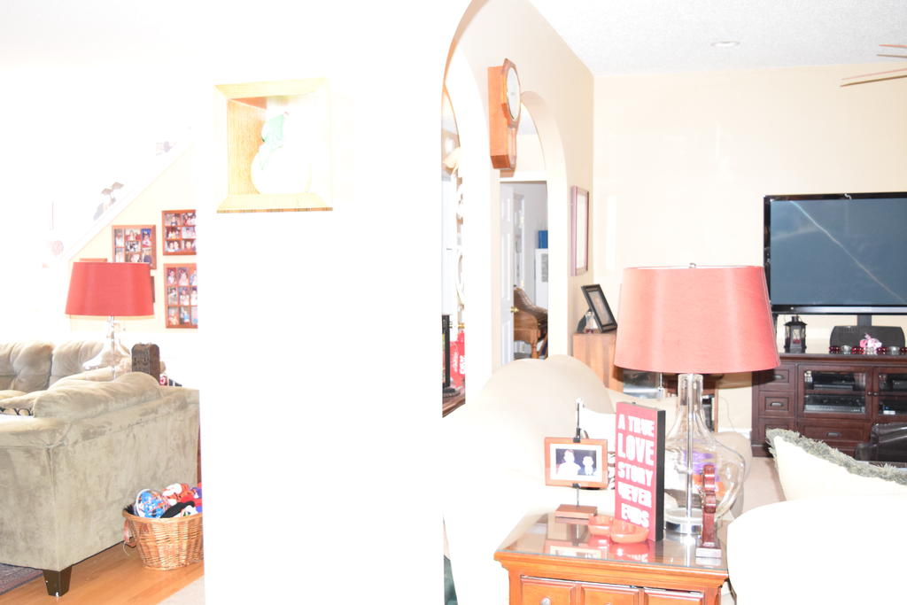

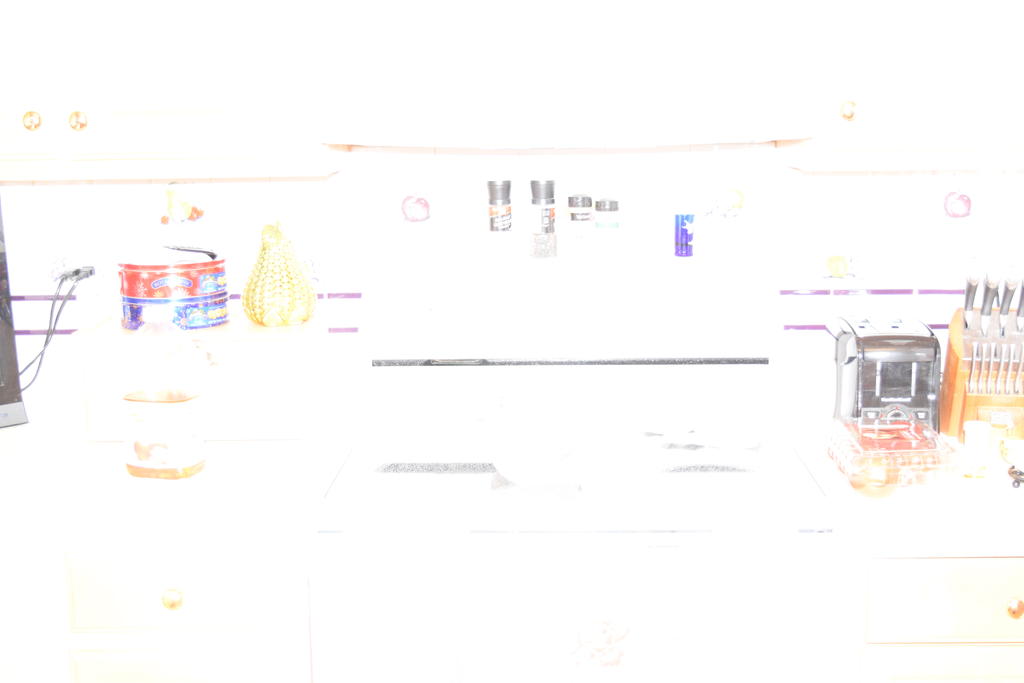

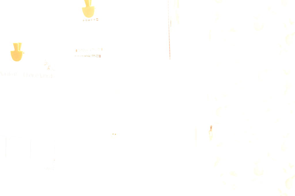

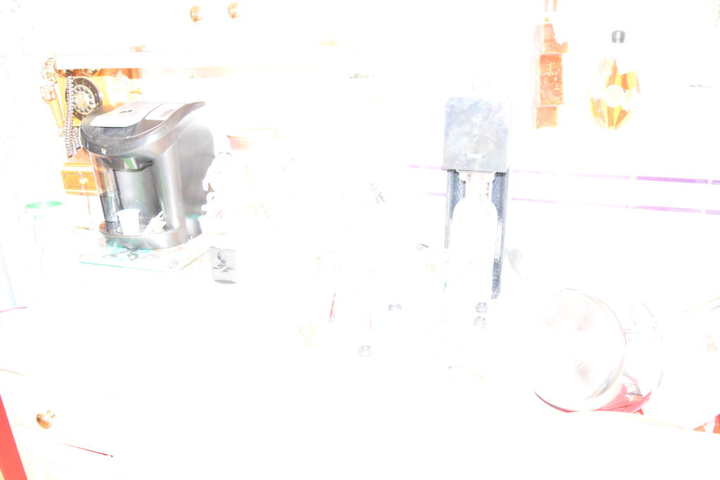

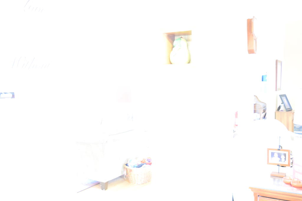

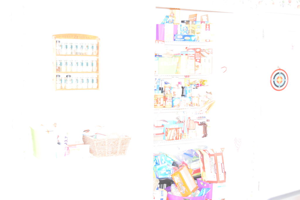

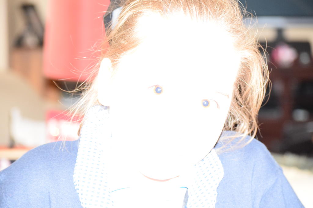

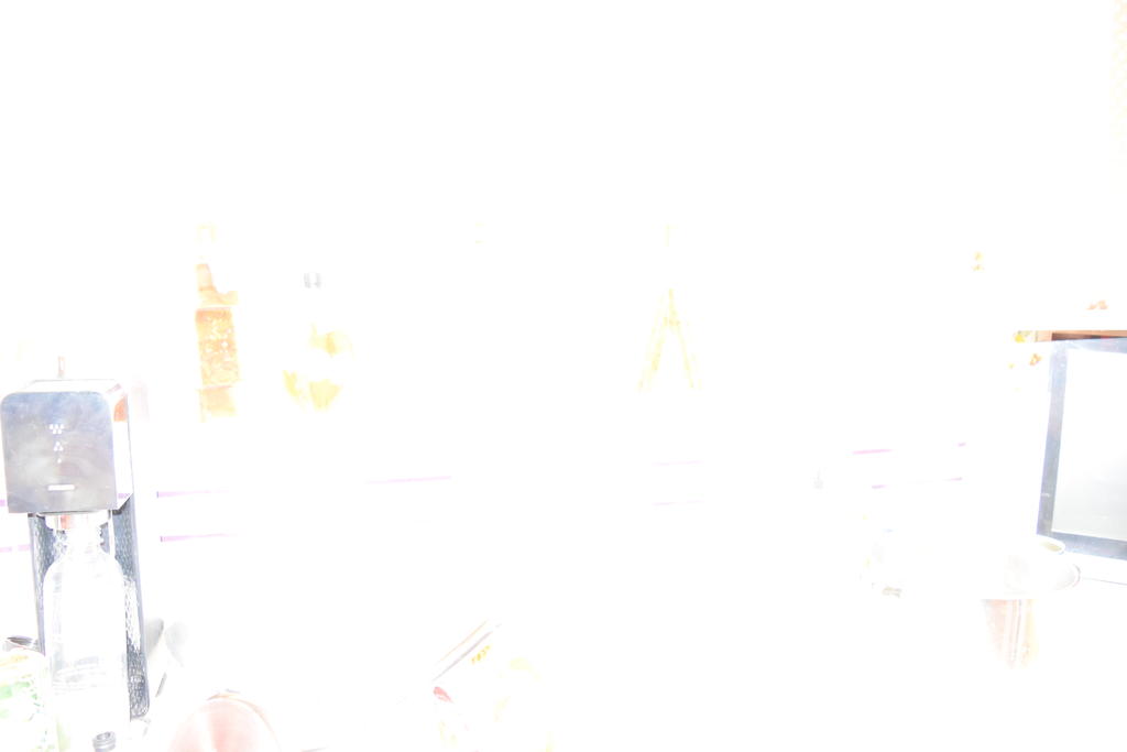

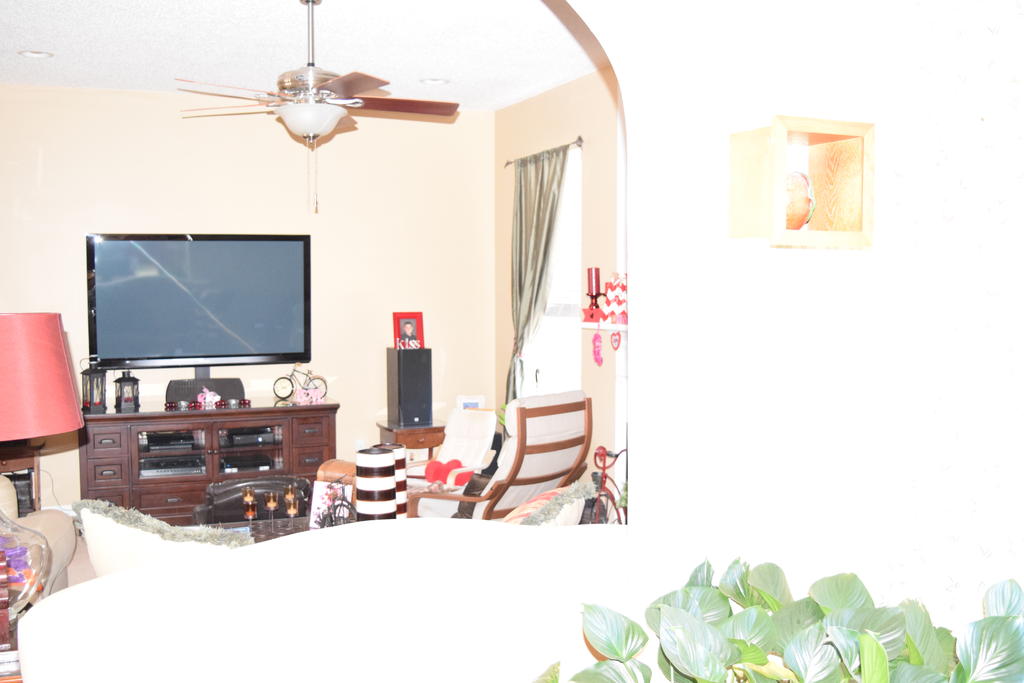

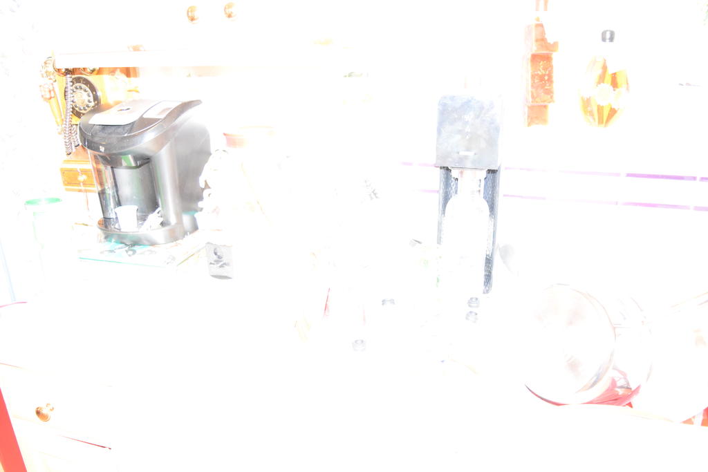

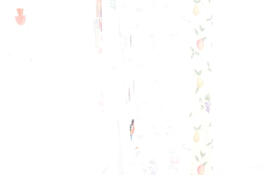

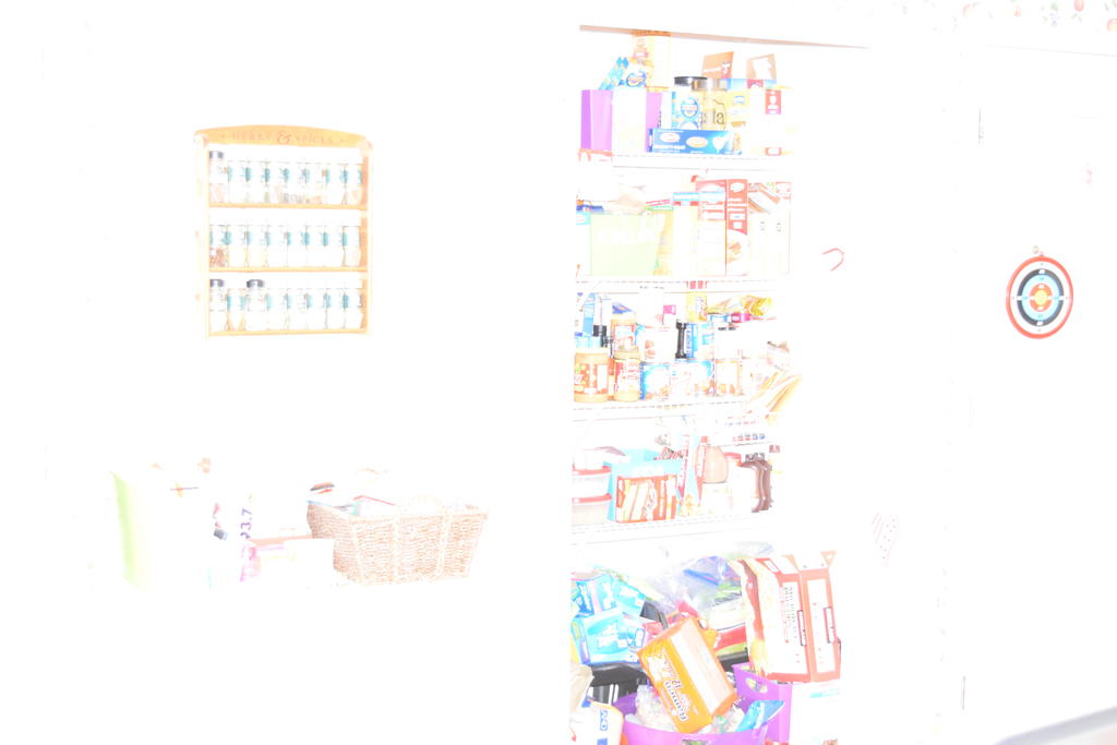

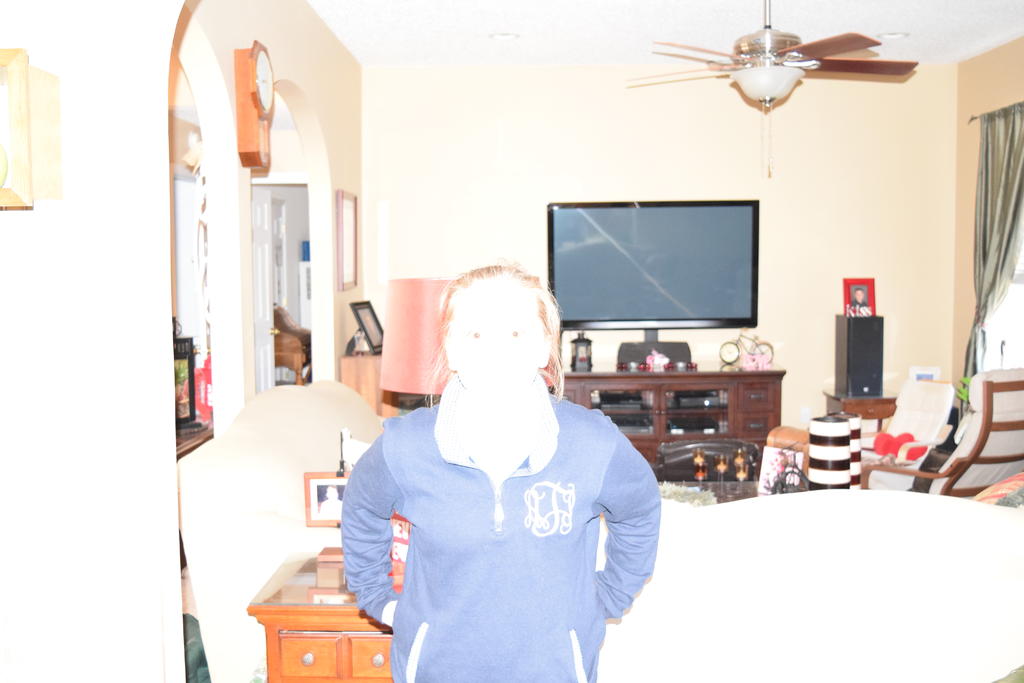

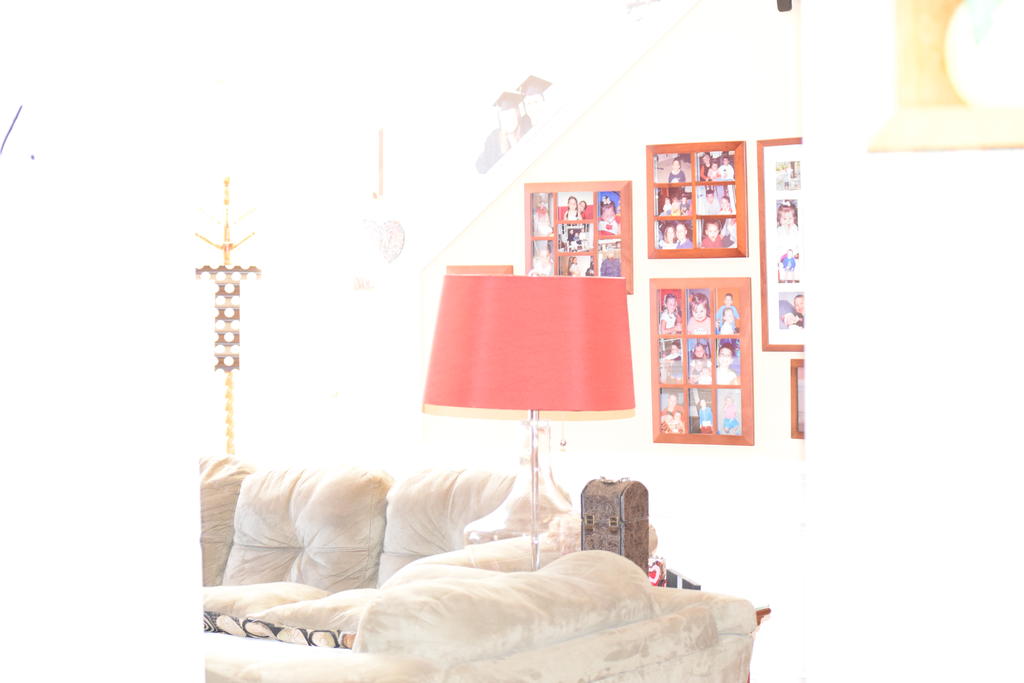

DSC_0002.jpgDSC_0021.jpgDSC_0018.jpgDSC_0015.jpgDSC_0006.jpgDSC_0003.jpgDSC_0023.jpgDSC_0019.jpgDSC_0016.jpgDSC_0012.jpgDSC_0004.jpgDSC_0020.jpgDSC_0017.jpgDSC_0013.jpgDSC_0005.jpgI just purchased a refurb D3300 with a shutter count of 252 images...every picture I take using any of the 2 kit lenses or my prime 35mm lens shows up with a crazy amount of overexposure. it's as if the shutter is staying open too long. I also can switch the dial to any other "mode" EXCEPT for manual and get the same type of super white pictures. The only time I get a good picture is when I swithc it to MANUAL and then I can get a decent picture. It's driving me crazy. I have an older D40 that I'm moving from to the D3300 and I've tested the kit lenses that came on the D3300 on the D40 and they work fine. I then try the old kit lenses that came with the D40 on the D3300 and still come out over whitened. I've reset the shooting menu and setup menu and can't for the life of me get this camera to shoot in anything decent but manual which will not work very kindly when the wife arms herself with it.
Here are some example pictures. Does anyone know of this being a problem? Like I said this is a refurb I just picked up from BUYDIG with 252 shutter count, I'm wondering if I have a dud...

A few things going on here, you ISO is WAY too high, you are using flash when it looks like it wouldnt be needed and the combination of the both are giving you these images ...
I would say go to Aperture or Shutter priority to start with, will be better settings than Auto and take the flash away, you either need a higher ISO or a lower one with flash, not both :)

I'm shooting all the modes as well as the preset modes and most of the pictures still come out super exposed with white, it only seems to do this when the flash is used however it does it occasionally without the flash but only when the shutter is staying open more.

I agree...however when I switch to AUTO I can't get anything decent to come out that is remotely what I'm seeing. I even went outside late afternoon to try to take some shots and those too even looked brighter than what it appeared to be at the time of day, it was just getting dark...again the flash was used and it appeared that the flash might be not timed with the shutter??? I hope I'm saying that correctly.

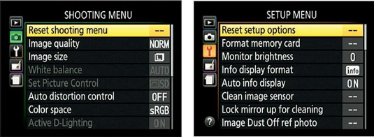

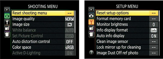

To eliminate any possible settings issues with the camera body, I suggest you do a couple resets. I don't know that it will help, but it won't hurt.
Press the menu button and use the reset options found in the Shooting and Setup menus:

check your manual for "reset" you should have 3 - default - shooting - custom. Check your manual for auto iso sensitivity control.
I tried resetting the camera almost immediately after seeing the photos. Unfortunately this didn't help and the pictures are still coming out the same.
Okay, good.
Well, I agree with everyone else that the EXIF data in your first post clearly indicates the ISO is waaay too high. I don't share Don's distaste of Full Auto, it's rather helpful in situations like this. "P"rogram mode is fine for this as well, I suppose. but what we really need to know, is if this is camera error or camera-operator error. I would tell you to put the camera in Full Auto and go take some shots outdoors in full sun and see where that gets you.
