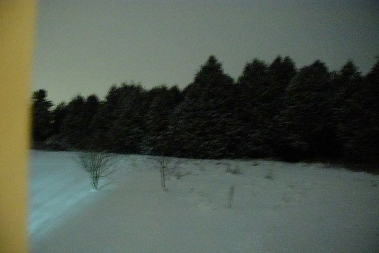

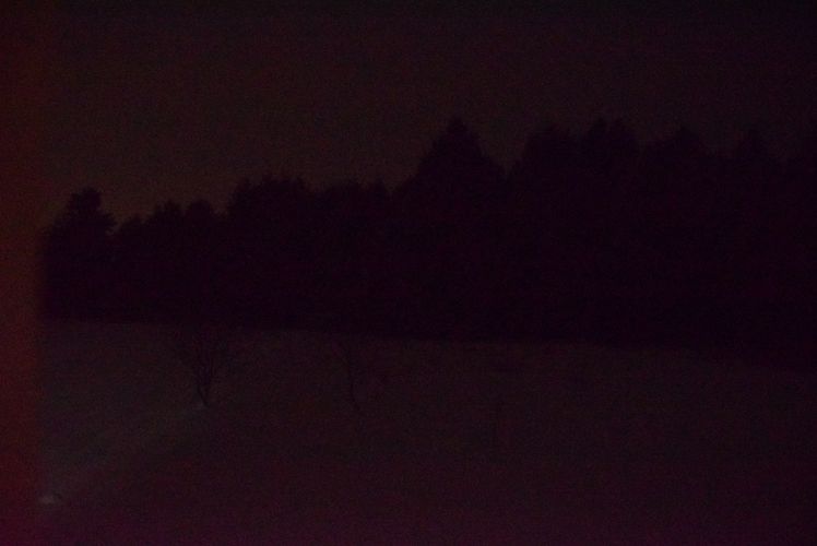

I like to take photos at night and was excited about how much less noise the D3300's sensor has compared to my D40
So I set the ISO to 12800 and the mode to matrix and P and got this!
Setting it to M and giving it 1.6 seconds instead of 1/6 of a second and got this:
Using P, A or S I have to dial in about 4 stops of "over-exposure" to get a decent picture?!
Is it because the meter is only good to about -1 EV, that it won't go below that?
cheers!
Dominic

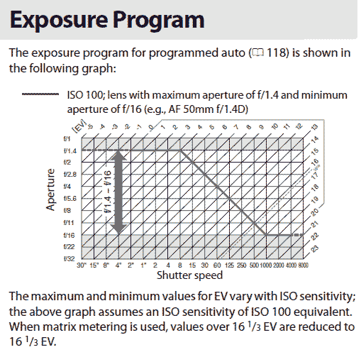

I don't think the D3300 manual includes the chart, but here is a P mode chart from a D800 manual. For example, if ISO 100, if P mode chooses f/4, it will also say 1/60 second (from this chart). We should never confuse automation with intelligence. :) Just meaning, we may of course have reasons to choose other values, but P mode does not know them. :) And P mode won't go below EV 4 (at ISO 100). The D3300 P mode will be a similar idea (I don't know if the same exact values or not, but should be fairly close).
P mode chart shows near EV 11 minimum with a f/3.5 lens.

Looking deeper, your Exif in the second Manual picture says ExposureDifference +3.5 EV. That is the difference in the actual exposure used, and what the meter thought it ought to be (if the meter could affect Manual mode). That seems very unusual, I'd say the picture was a couple of stops UNDER exposed (-2EV), but +3.5 EV says it is far the other way, overexposed.
Continuing that, the first black picture in P mode says ExposureDifference 0 EV, claiming it is properly exposed. Which it should normally be 0 EV when the automation modes handle it, but I think this one is not properly exposed. :) And that is also your complaint.
Makes no sense, something seems wrong. Why, I dunno. Says 18-135mm lens, which should be very compatible. Says Exposure Compensation is 0 EV. Says Bracketing is off.
It might be explained where it says Light Value is -1.8, which is pretty dark and out of range. But it seems to have measured it anyway? I'm not sure the numbers are supposed to make sense there. I'm sorry if this is just a confusion.
