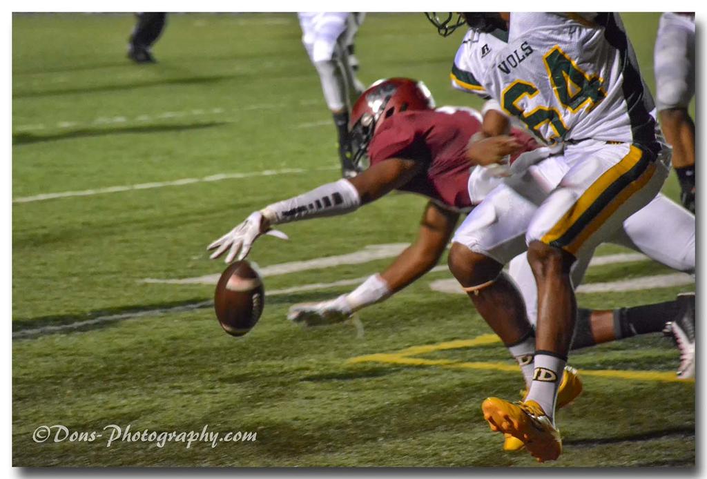

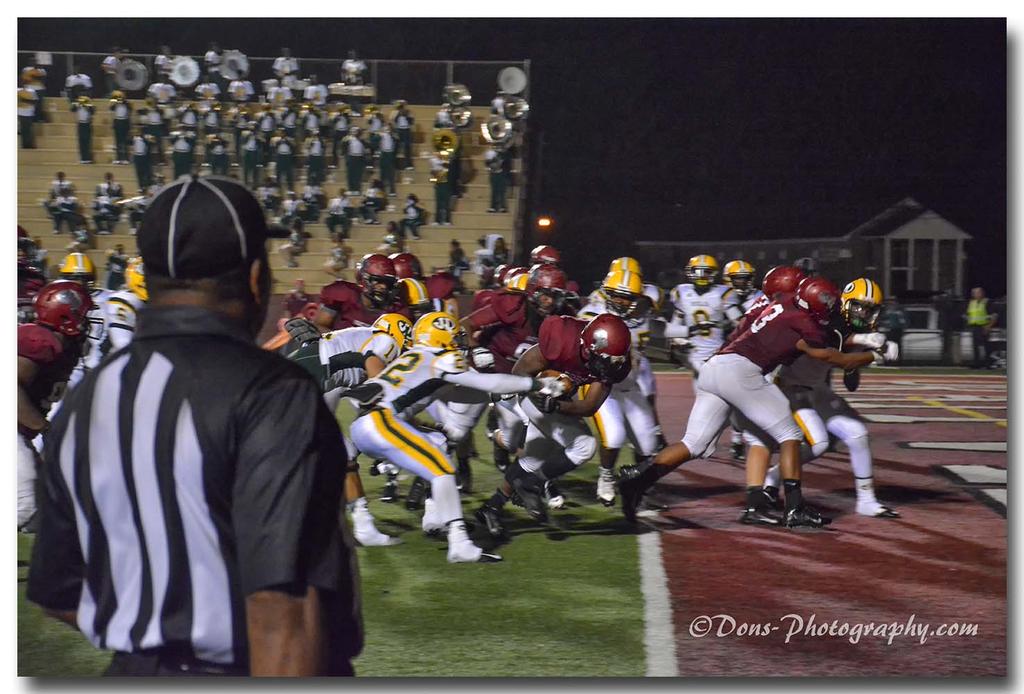

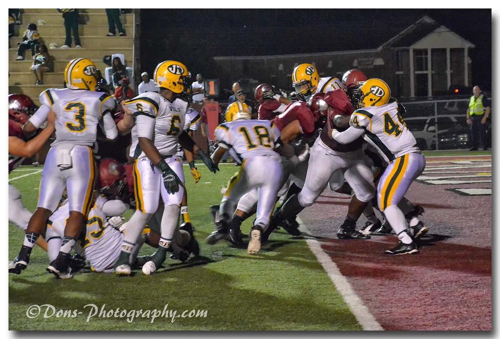

These were shot with my D7100 at our local high school football game. The D7200 will do equally well. The nice thing about the D7200 over the D610 is that the reach is better on the D7200. Also lenses for the D610 are much more expensive.

Those look pretty good. I would be satisfied with those. What kind of ISO were you using?
If you put your cursor over the photo you should see a pop-up over the photo that shows all the EXIF data. That will work on most of the photos on the site if the person uploaded has processed it and not stripped out the data and if they followed the directions for uploading.
The first shot was at ISO 5000 and the other ones were at ISO 4000. If you really need better low light capabilities then skip the D610 and go for the D750. Right now it is the king of low light in the Nikon line.
