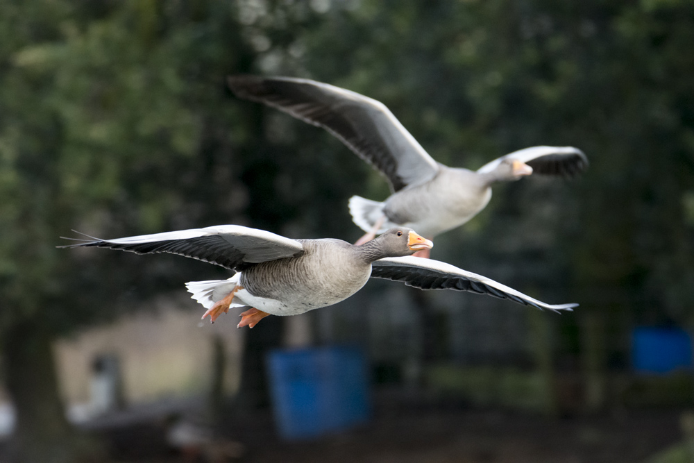

I would love to stick with the base ISO but most of the time the camera would be in the bag,not the greatest quality but a 6400 sample.
