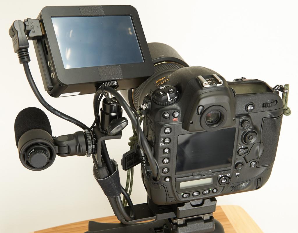

My early Christmas present to myself is an Atomos Ninja 2 video recorder, which I will be using along with my D800.
I'm looking for recommendations on equipment to use to rig this gear together.
I'm considering various configurations of cheese plates or multiple hot shoe brackets.
I already have, and will be using, a Manfrotto tripod with quick release head plates.
I intend to connect up the camera, the Ninja 2, an external microphone (and I'm asking for recommendations for that, too) and optionally an LED light source.
I'd like to be able to quickly remove the camera from the rest of the rig. And quickly remove the whole rig from the tripod as well.
I suspect I'll be stacking two Manfrotto QD plate units. One for the camera in the rig, the other, for the rig on the tripod.
Beyond that I am completely open to suggestions. I'd like to keep it cheap but with good quality hardware.

I've decided to go this route, pretty much. It avoids the usage of "cheese plate" type hardware in types that are difficult to find.
I was thinking of a hinged mount system that allows the Ninja to flip down below the camera.

I ended up getting almost exactly the rig shown above. Not different in any significant way. It works well.
I have found out for myself that while any given random 2.5" SATA hard drive MIGHT work with the Ninja 2. you really need to make at least a 20 minute test video to be sure. If there are no clip terminations or skipped frames or glitches in a 20 minute video, then that drive is likely to be trustworthy. Atomos has drive recommendations on their site and they're a good place to start.
You will really WANT USB 3.0 on your computer for reasonable transfer times from the dock. If you don't have USB 3.0 in your computer, and it's a desktop, you should get a USB 3.0 adapter card. One that plugs right into the motherboard via an available PCI-E slot.
I wish I'd gotten the Ninja Blade with its higher resolution and calibratable display, but the Ninja 2 is still pretty nice. But dark details get lost on its display, going black too fast, and its lower resolution makes it difficult to judge focus. You just have to learn that black levels look better on the recording than they do on the unit's own display.
