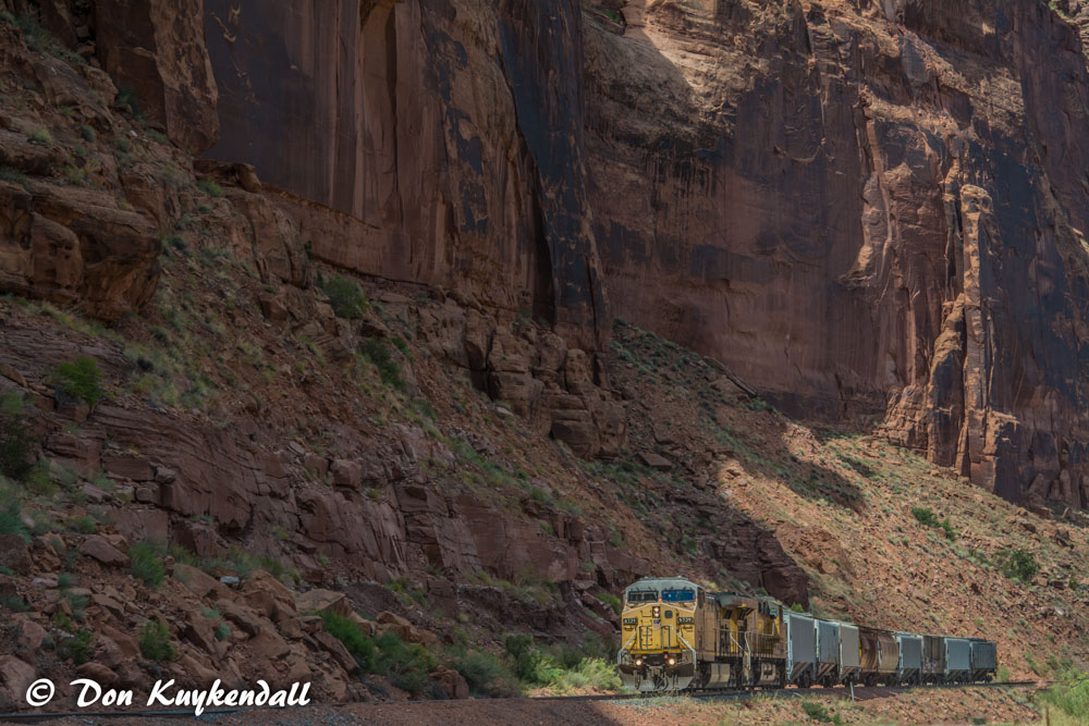

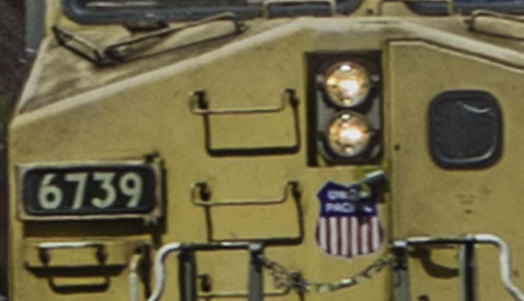

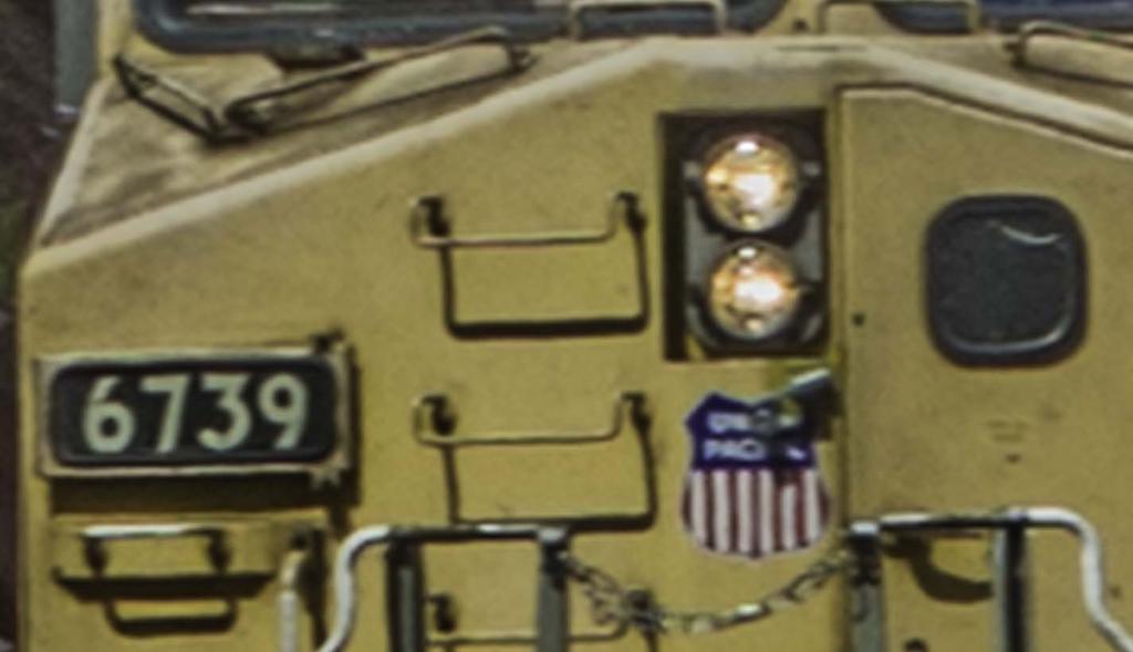

Here is a section of a photo that I shot with my D7100. This is a well exposed shot and at any normal blowup it looks good and sharp.

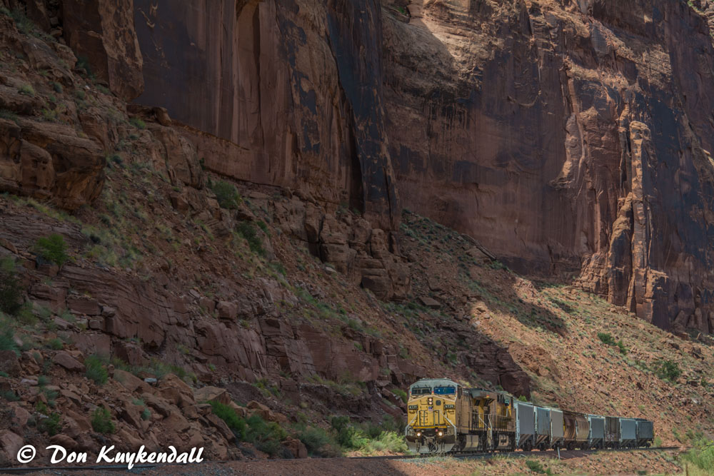

here is the edited shot it came from
NIKON D7100 - 24.0-120.0 mm f-4.0 - 1-500 sec at f - 5.6 - 38°33'20- N 109°39'13- W - .jpg
NIKON D7100 - 24.0-120.0 mm f-4.0 - 1-500 sec at f - 5.6 - 38°33'20- N 109°39'13- W - 3891.1 ft_

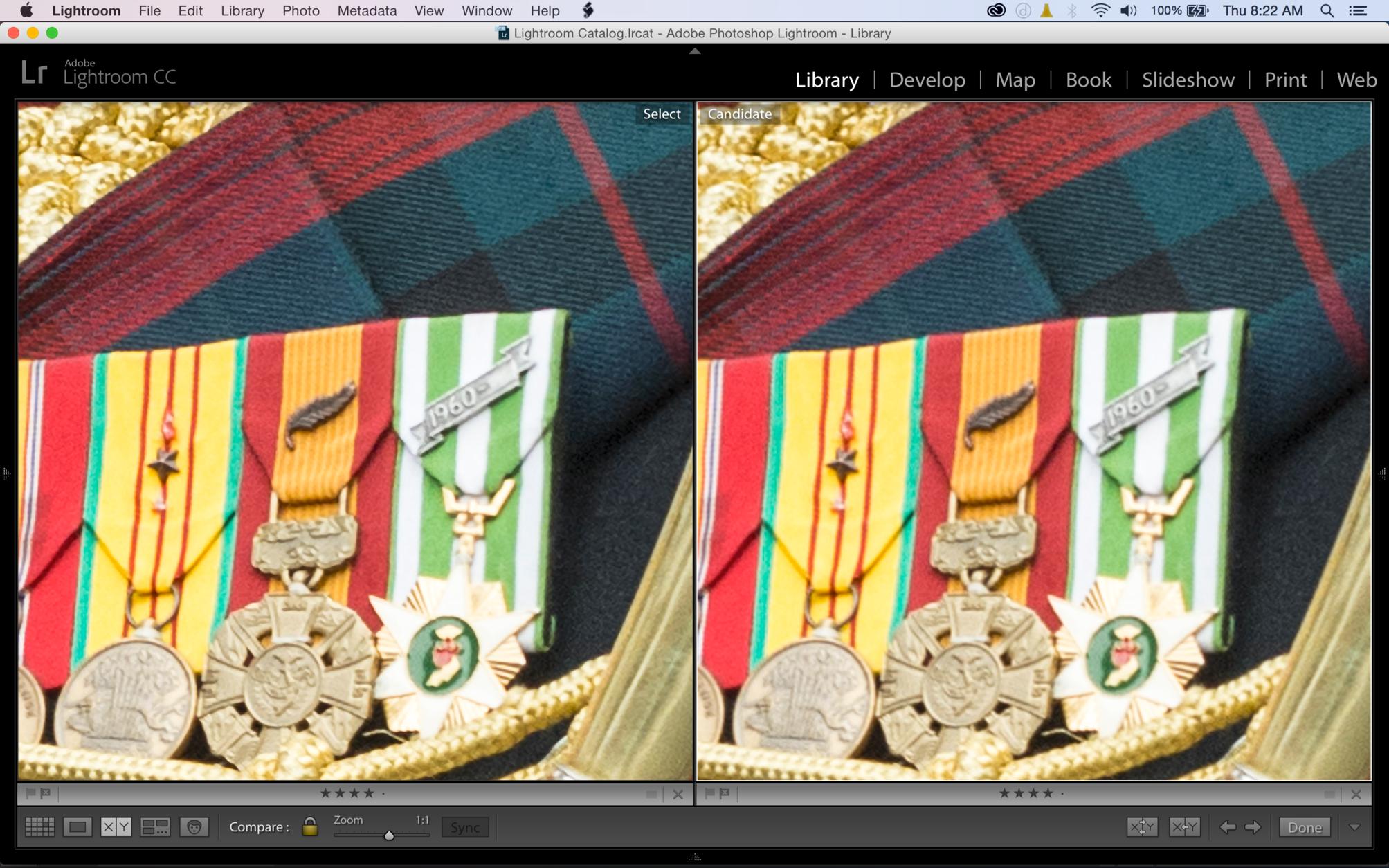

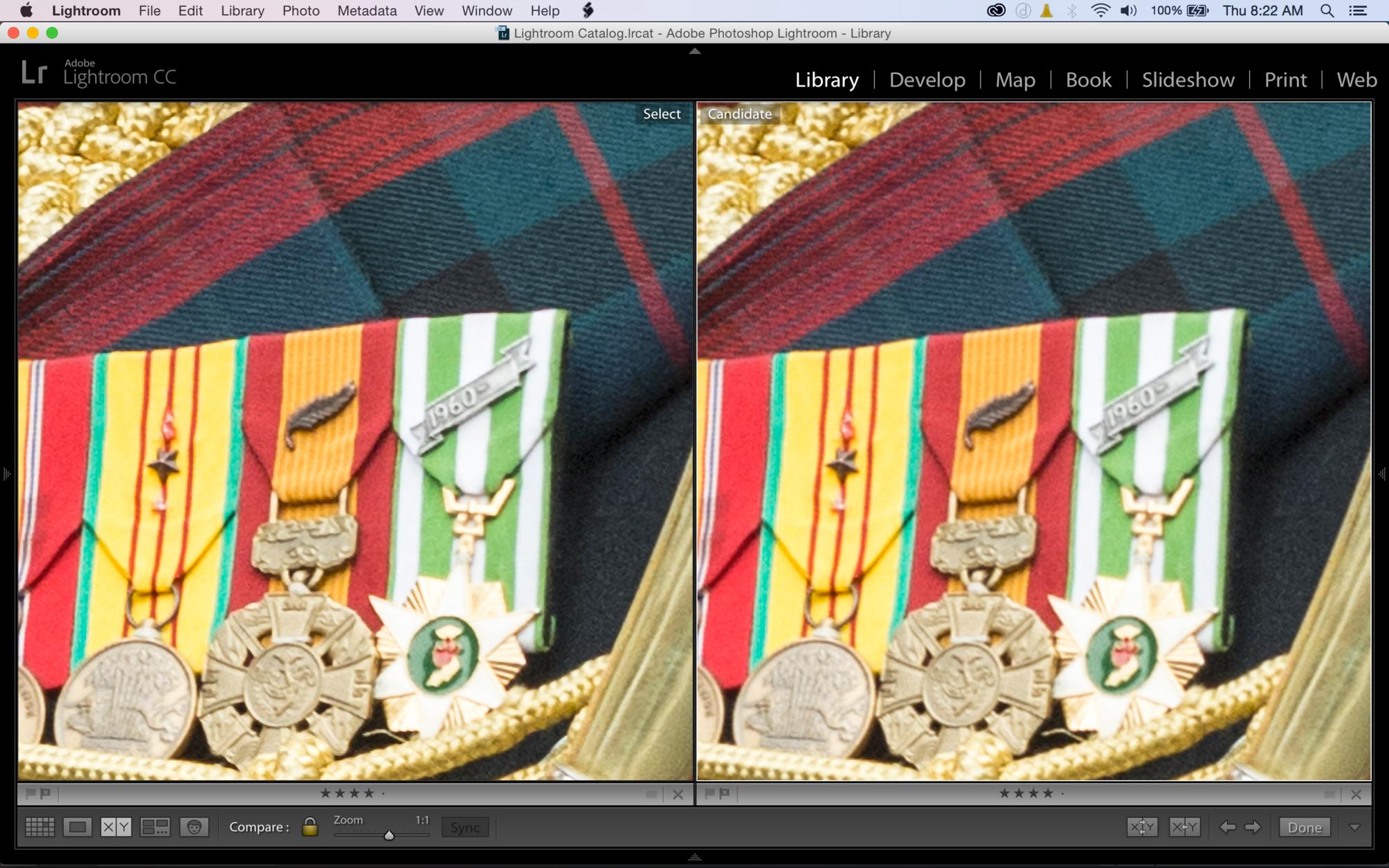

With that said, one of the best up-sizing programs I've ever used is Adobe Camera RAW. Seriously. Don't believe me? I took the same 24MP RAW file (from a D7100) and used ACR to enlarge it to 10 feet on the long side (your dimensions) at 120ppi and did the same with Perfect Resize 9.5. Here's a 100% zoom side-by-side from LR (screen shot - but that should suit considering you're sticking it on a wall and people will be at least a foot or two away)...

Care to guess which is which? :)
Again, not badmouthing the program, I'm just saying that you can probably do the same thing with the tools you have. Perfect Resize is on the left and shows a little more detail, but I suspect that this could be closely replicated post-resize. My point is, if you're not going to be doing this a lot or don't want to spend the money (after the free trial) there are very good alternatives.
