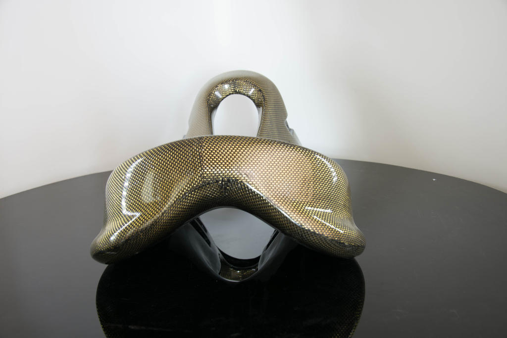

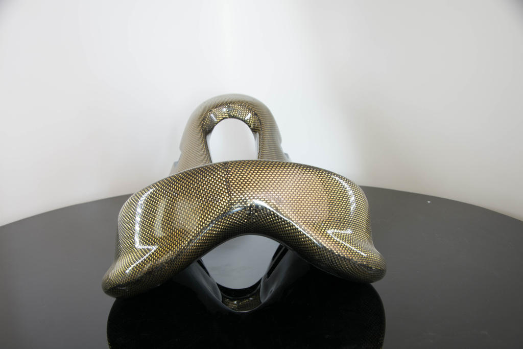

I have a Nikon D7200 and recently tried a new project, 360 degree product photography using a homemade turntable and shooting a product a friend of mine makes, carbon fibre horse saddles.
I had the camera mounted on a very sturdy Benro tripod and used an external shutter release, however on all the tests i did i came across a puzzling problem.
It appears that the mirror (maybe) is moving slightly and altering the vertical postion of the shot, compare the two shots below.
If i looked thru the viewfinder whilst taking the shots i could actually see the movement, it wasn't a 'fast' drop, more a slow 1/4" sec slide down.
Can anyone suggest a reason for this and how to fix it, in the end i post-processed the dozen or so shots that had dropped and aligned them as best i could, the results are here (yes, i forgot to polish the acrylic, but it was just a proof of concept to show my friend).
Gold2

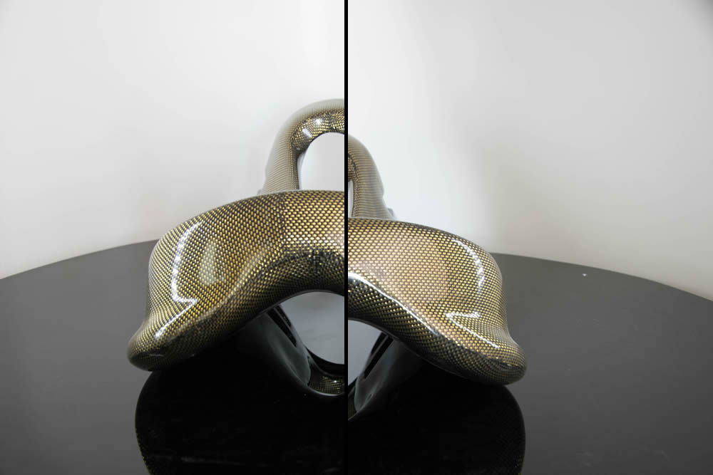

Hi Marcel
It's not too obvious unless u over lay the two images together in PS or similar.
Below is a split of the two images posted earlier, the body doent move but the image on the right has moved down..

Now if the image has dropped down it means that the camera went up... I repeat my question: Is the saddle exactly in the middle of the pivot point of the turntable? It's either this or your tripod is not stable enough.
Marcel
Happily retired
If you just do a simple test, put a white dot on the side of the turntable and one in the middle. Now, take several pictures while you turn the table and you will see the border point going up and down while the middle point should not move.
