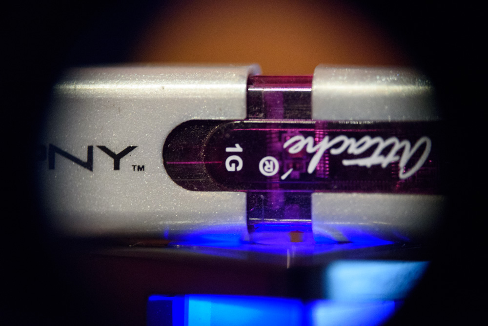

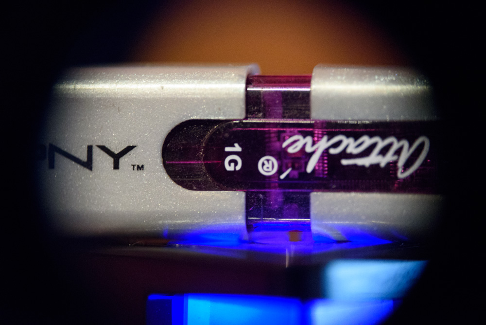

WOW! Thanks guys for the quick responses. here is a shot. OH BTW. I love this new 28-105mm D lens.

My line of thinking... Some lenses the glass sits in different locations in the tube. For example, on our Tamron 90mm the end glass is set back quite a ways. Other lenses the last piece of glass is right at the end of the tube. With this one lens that has the heavy vignetting I'm thinking there is something specific to this lens and how it is constructed that maybe it pulls from farther out on the edges of the glass, relative to the Raynox, thus picking up a heavy vignette. That's my best theory.

Have you tried it at 105mm at different focus distances?
Yes Scott. I tried it every which way I could. It is really a shame, because I really like this lens and I got the Raynox with that in mind. I could walk around with the 28-105, and if I see something that I might want to take a macro shot of, it would be an easy snap on for that purpose. Oh well!.
At least the 28-105 is a half a macro in itself, It has 0.5X magnification between 50-105mm with a flip of a switch. I tried it already and it works fantastic. I can't wait to try it out tomorrow in daylight outside.
