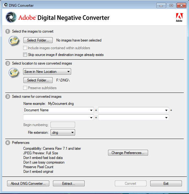

I tried and use this: Adobe - Adobe Camera Raw and DNG Converter : For Windows : Adobe DNG Converter 8.7.1
I can add a folder at once and output in a DNG folder

Thanks Michael,ACR will remember its edits but off course when you go into Elements it doesn't,i just find the DNG converter another step,I download into View,go through them deleting what i dont want,if i want to edit one i can convert it to Tiff within view,i just couldn't see the point in keeping two files and as the Tiff is a lot larger i wondered if it was the best to keep.
