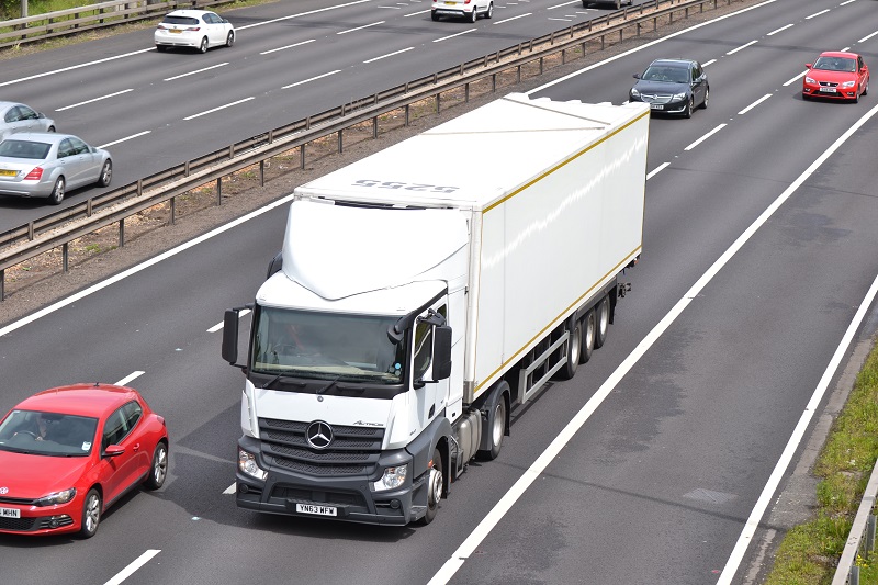

I`m a big truck photographer, and for the past year, I have been shooting trucks on my D3100,superb camera, but when the sun shines, and a WHITE truck gets snapped, the whites seen to burn out.
I have set my white balance to "preset manual", yet it still does it, after I`ve set it up. A friend of mine who i go out with, he has a Canon, and his does not do this at all. We both shoot in the "M" mode, but it does it in all modes also.
Can anyone please help,as I have treid my Brothers camera as well, an Olympus, and this too does not do it. I`m getting to the stage of going to trade the camera in for a Canon, which I don`t really want to do.
I enclose a picture to show you what I mean.

We'll need some more info to help you, here. Are you shooting RAW or jpeg? What kind of post processing are you doing?
BTW, I see detail in the truck and only a small part that looks blown out to me.
mikew_RIP
No need to swap cameras its an exposure issue,just needs a little less exposure,you could bring it back a bit in processing.
rocketman122
exposure. looks like you tried correcting it but im certain the image was OE as it was shot in camera. the dynamic range is off. the red car (seat? not the VW)and silver car(merc) would not look that if it was exposed properly
J-see
The histogram spikes at the right. You lost some information there because of overexposure. It isn't much but it's loss nonetheless.
You can lower it a bit in post but there's no way to recover that data.
Felisek
As everyone said, it is an exposure issue, it has nothing to do with white balance. White balance controls overall colour cast of the picture. I'd keep it in auto, unless you measure your preset WB with a grey card.
You can either use spot metering and measure exposure off the white truck, or leave it in matrix and perhaps introduce EV correction until you get a satisfactory result.

Looks like you tried correcting it” The image is untouched.
Re “OE”, I`ll have to question this, asI have tried dropping it down a stop/half a stop, and it still does it, I`ve tried in Auto/Manual, still does it.
I have loads of others like this too, the background is perfectly exposed, yet the truck is burnt out.
I`ve downloaded a few pictures, and taken them to my friends house who has stood next to me, the exposure in the background are the same, yet his truck is spot on, mine is burnt out?

A quick glance at your histogram could have prevented that. Learn to use them and you'll start nailing exposure every time.
Also, you do know you can look for the "Highlight Overexposure Warning", what are called "blinkies" when reviewing an image on the rear LCD, right? You just press the four-way selector up/down through the different screens while reviewing your shots. Blinkies, as the name implies, blink on the screen when you you have highlights that are blowing out. Then you can adjust your exposure on subsequent shots until you no longer see them.

It may also help to change your exposure metering setting. If you're shooting on full matrix mode it's probably compensating more for your background than your already super bright subject causing some OE on it. Try shooting in center weighted or spot metering modes and play around with exposure settings when in those modes to try and lock down a good setup for shooting white trucks in the daylight.

What metering mode are you using? (get the feeling that this might be the issue)
If shooting in manual exposure mode, what settings? And what does the camera do in A/ P or S modes?
Also - do you have exposure compensation on?
wtlwdwgn
The light meter uses an average 12% gray as 'normal' for exposure. If the scene or subject is brighter than normal go to EV +1 or more and if darker go to EV -1 or more depending on the conditions. Just my $0.02. :rolleyes:

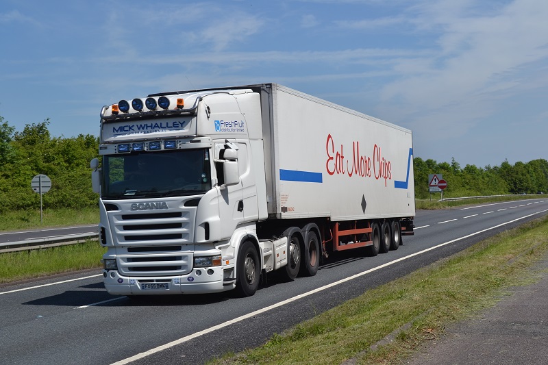

Just wanted to say thanks to everyone who took the time to reply.
As the sun was out again today, Thought I`d have another try with the camera settings you have told me, and very pleased with the results.
