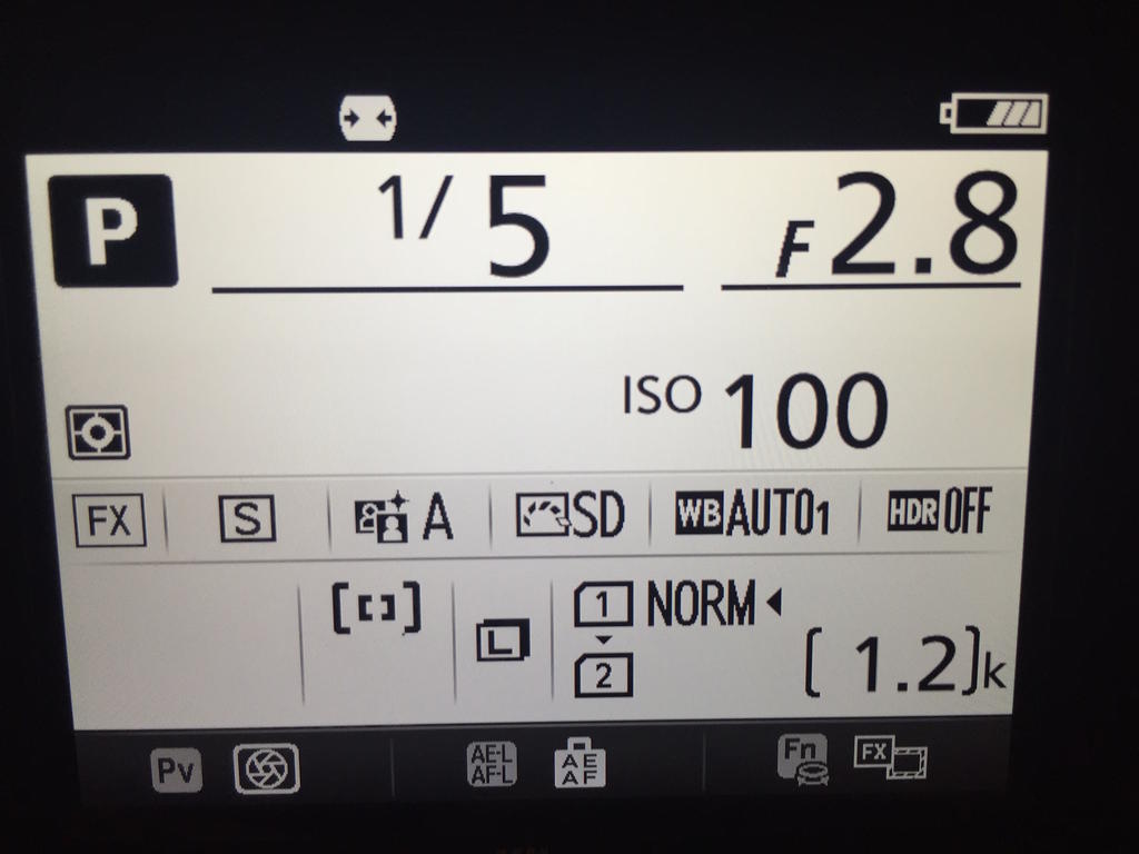

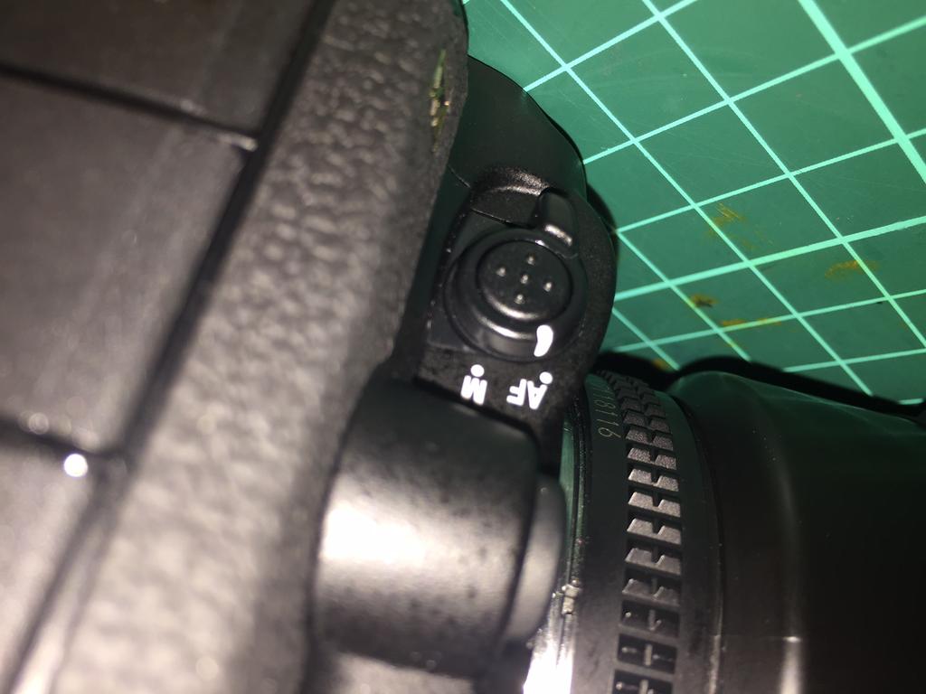

I have got a new D750 few months ago, I was happy as, but I realised few days ago, when I switch to "AF" then the camera is not doing any autofocusing at all, when I click on "Info" button then click on the middle button on the front (the button is in the middle of AF/M switch) doesn't give me any Auto Focus related info. There is no AF functionality at all on the camera right now. My firmware is up to date C 1.01 L 2.005, the camera functions well. Do you have a similar experience with D750? I tried to reset in every screen to back to the factory settings instead, do you have any suggestions that I did something wrong or the camera has a defect?

I'm checking the cam and menus right now and will give all options that can affect focus:
The AF/M switch next to the lens mount.
The A/M switch on the lens.
In your settings changing the function of the AE-L/AF-L button on the back. You can change focus from the release to the back-button.
Check those three first.

I follow all your instructions, all done but there is no change. When you click on "info" button then press the middle button at the front (the button located in the middle of AF/M handle) do you see any Auto Focus related menus on the back panel? I don't see anything unfortunately, and also id your firmware is as C 1.01 L 2.005?

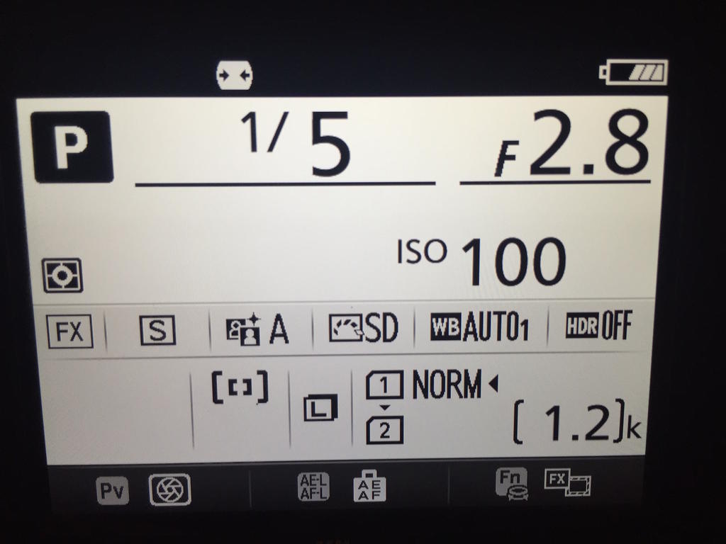

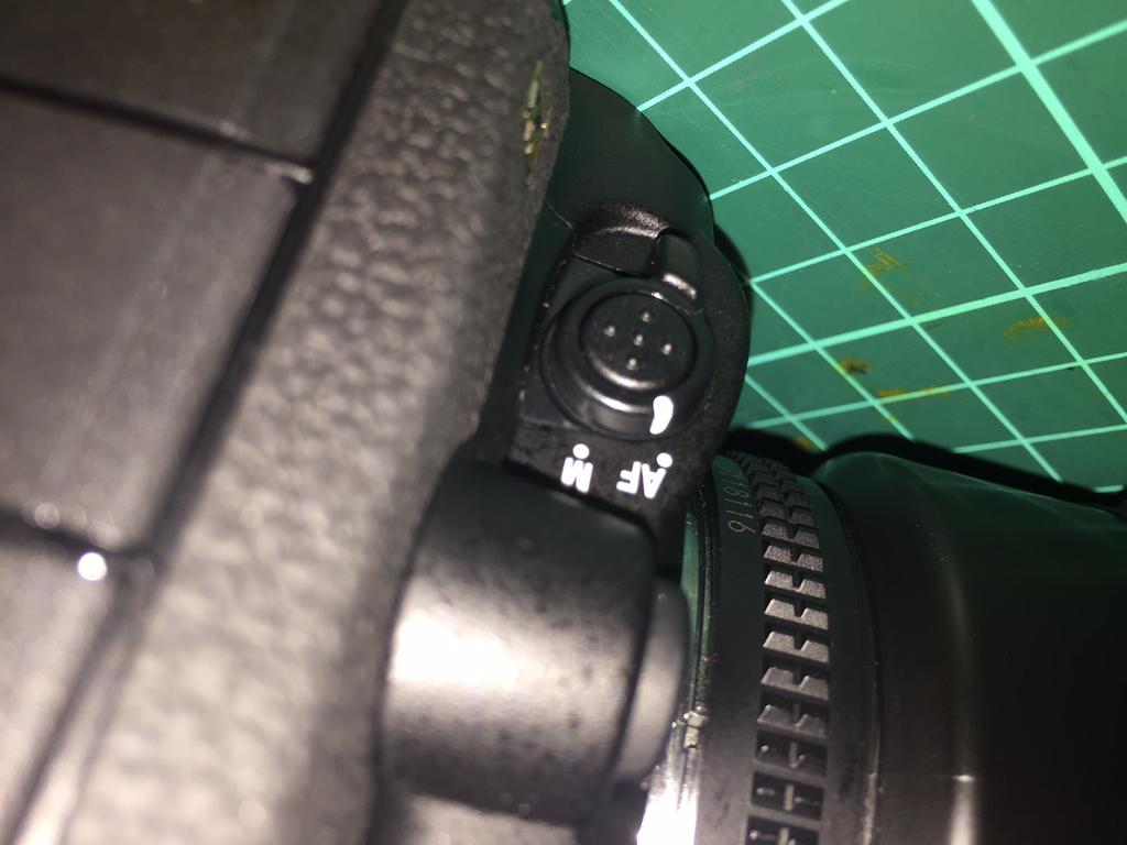

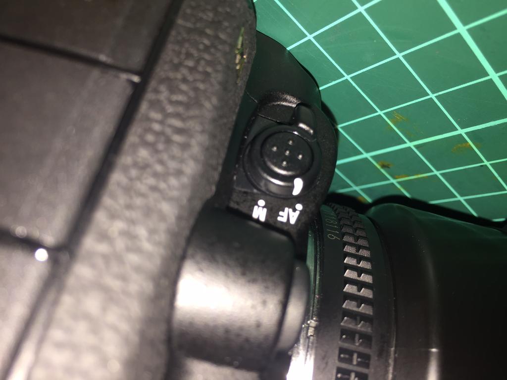

Here is the button, in the normal cases when you click on "info" button at the back then press the button in the picture, should give you AF options.
If all is set to normal, or you reset, and with several lenses you get no focus display, the cam's AF is switched off. There could be several reasons for that from a faulty AF/M switch to something internal. But that's something the repair guys have to find out.
