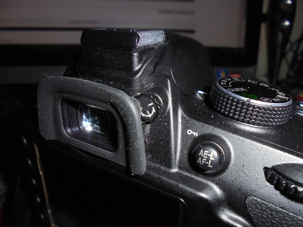

weebee
Sorry for the dusty image! Notice the dial right behind the viewfinder rubber eye cup? That is where you adjust the focus to meet your eye sight requirements. Turn it clock or counter clock wise until you see through the view finder clearly. It works great. I don't need to wear my glasses when I take pictures.
