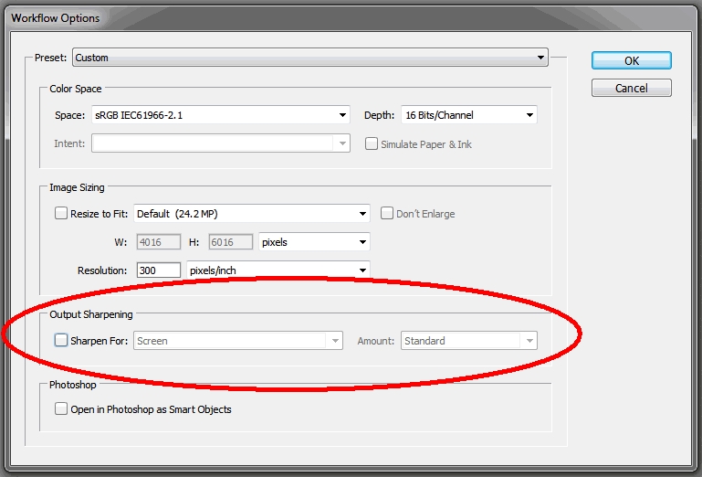

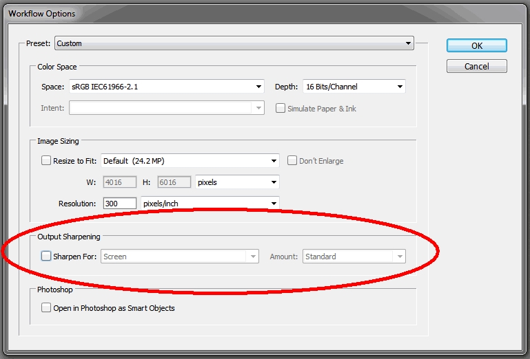

While watching one of the free videos on Lynda.com, she is talks about working in Bridge before sending a file to Photoshop. In this video, when discussing output sharpening, she says not to add any sharpening in Bridge if the file is going to Photoshop because PS automatically sharpens the edges (1:53 is where the discussion of output sharpening starts). Is this true?

She was specifically referencing not checking the output sharpening box in Bridge IF the file is going to Photoshop because PS will automatically sharpen.
Horoscope Fish
I don't think PS automatically sharpens but... There is that link at the bottom of the page when a RAW file gets passed to Adobe Camera RAW that does output sharpening before opening the file in PS, if the box is checked "On".
I wonder if this is what she is referring to?

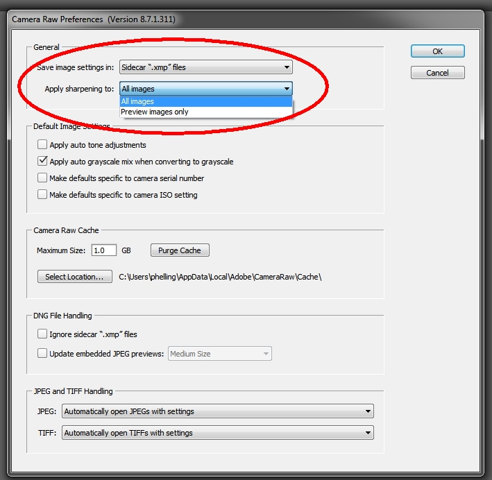

EDIT: I also found this menu in Bridge, under Edit/Camera RAW Preferences. Still, we're talking about ACR, here, not Photoshop itself doing some kind of Auto Sharpening upon import. That PS would do that just doesn't make sense to me, frankly. I mean, I'm open to being proven wrong but that really sounds off to me and if it *is* going on, I want to know about it.

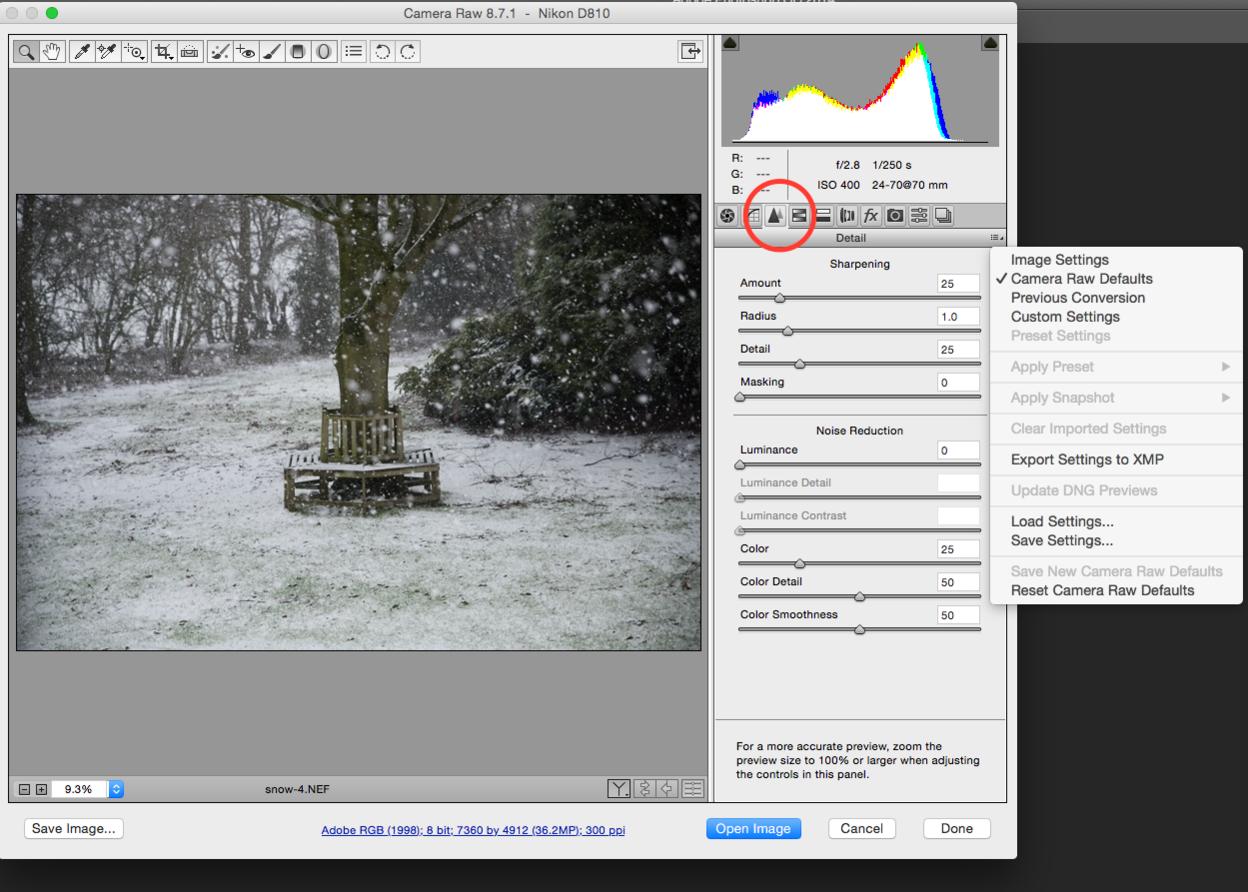

wornish

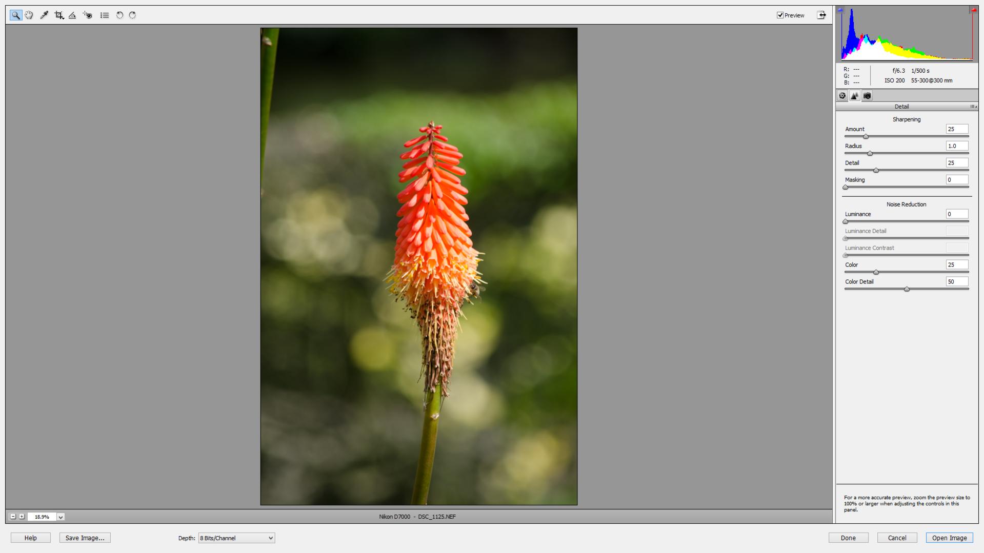

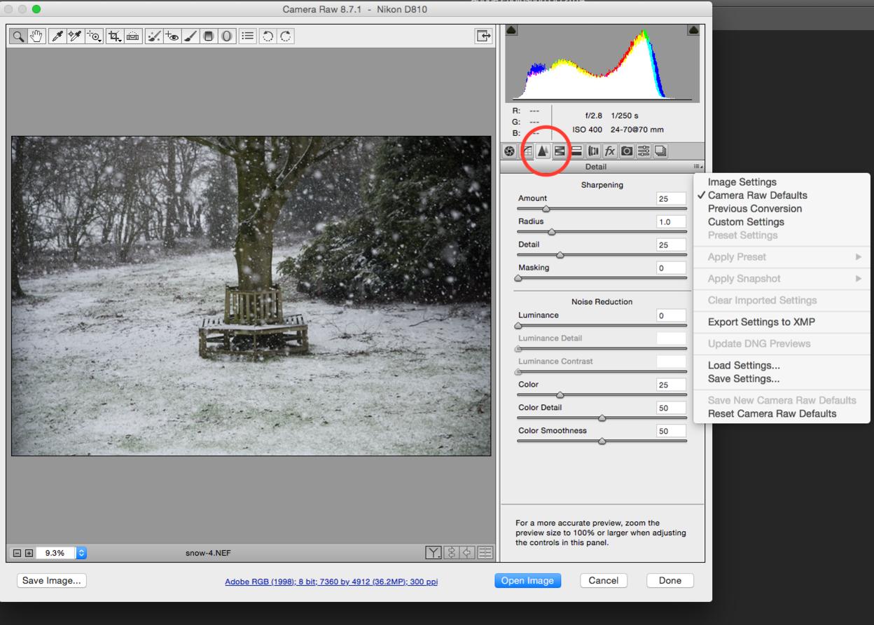

Never noticed this before as I don't look at the other tabs when opening a raw file.
If you are opening a raw (NEF) file in PS and look at the sharpening tab then the default is to apply sharpening at 25 as it loads into PS.
I guess thats when it is converted to a PSD file .
it seems you can also select custom settings.

Just so we're clear, that isn't Photoshop; that's Adobe Camera RAW applying sharpening before exporting to Photoshop. I think that's an important distinction to make.
Further, you can bypass ACR, if you went, when opening a RAW file (it's an option the Preferences for Photoshop) but again... That's not Photoshop applying Sharpening, and I don't think Photoshop does apply sharpening automatically. Adobe Camera RAW does, Photoshop (to my knowledge) does not.

She showed that box and said not to check it if taking the file into Photoshop because PS will sharpen it anyway. It just doesn't make sense. :eyetwitch: Maybe I will send them an email and ask.
Horoscope Fish
It doesn't make sense to me either... I'm thinking when she said, "Photoshop" what she meant was Adobe Camera RAW.
