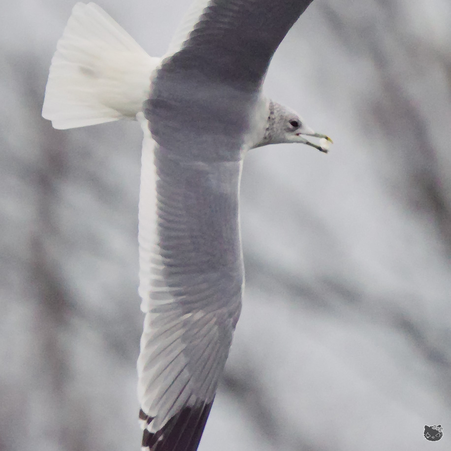

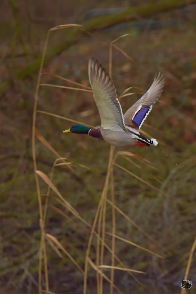

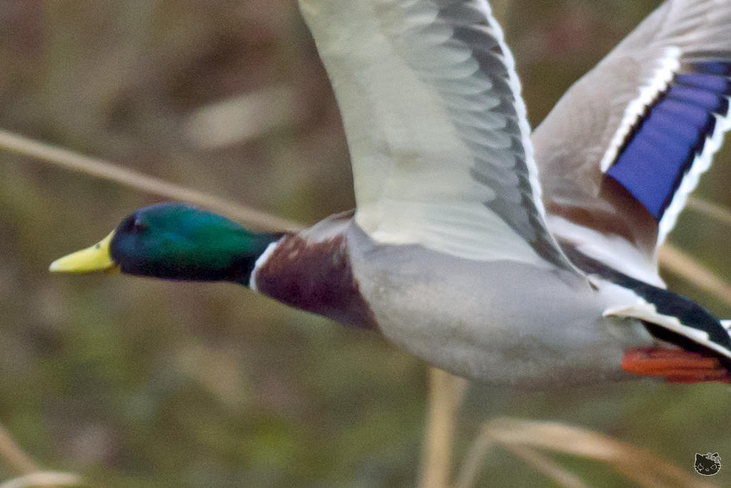

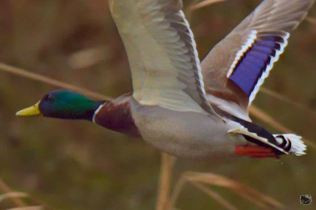

Here's a shot I did using the LR/PS combo.
I ran the same NEF through RAWTherapee which is about as hard as it can get for an editor.
This is the SOOC:
This is what I got out of it without really knowing what I was doing. I need to work on the colors.
Since the shot is a high ISO equivalent, let's see how LR noise/sharpness does vs Therapee. I don't expect miracles from these low light shots.
Not bad for a free editor.

Whatever "RE" is, are you not seeing the significant loss of detail and contrast in the "RE" processed shots as compared to the Lightroom versions?

There's actually little detail difference but because I'm a noob with RawTherapee, I need to figure out how to get the best quality there. It's not like LR where you got one slider for the highlights and shadows and they go up or down. RT is pretty complex, or at least it appears pretty complex at the moment. I'd say it certainly does a better job at the level of sharpening, noise, colors and tones.

In the flower image I managed to get rid of all highlights but I was that busy with the colors, I didn't even notice until I compared both. Of the two birds, the one having more color is RT and I'd say there it does a better job than LR. The head of the gull shows the difference.
I just used the standard sharpening of both without upping the values. But RT has a lot more options when it comes to sharpening/noise.

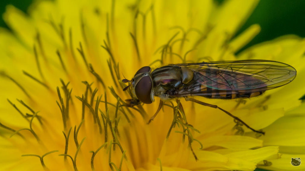

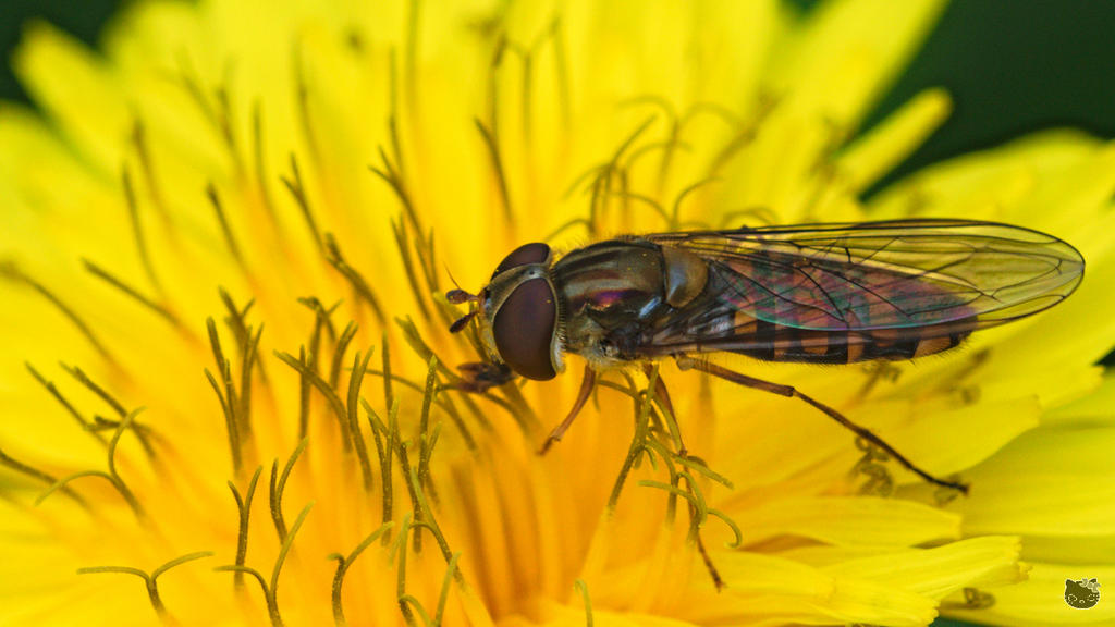

I reprocessed one of my older macro shots to see it at work in colors and details.
This is as I processed it in LR back then:
This is when reseting and quickly running it through RT:
More cropped:
I didn't use any noise reduction in RT which shows in the crop.
At first sight it looks as if the LR shot is simply underexposed compared to the RT but if you look at the bug, it is fairly similar in both, at least when it comes to exposure. If I up the LR by 2/3th, I simply can't get the same result. That would require a load of tweaking.
It's good and it is free. I'd advise anyone to try it. It's not for all but for those that love control, it might be a good addition to the post-kit.
