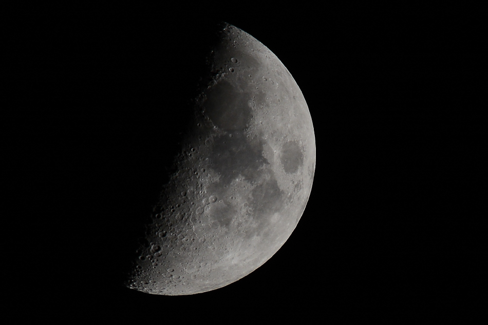

[MENTION=6277]Don Kuykendall[/MENTION] Nice shot of the moon. I'm so used to being in full Manual everything at night but will give this a try. On my D7000 I could zoom in and focus in Live View and with the Sigma 150-500mm @ 450mm the focus ring is so sensitive that just a touch to far and the focus goes off very fast. I'll give your suggestion a try though. This is what I managed on the D7100 so far.
