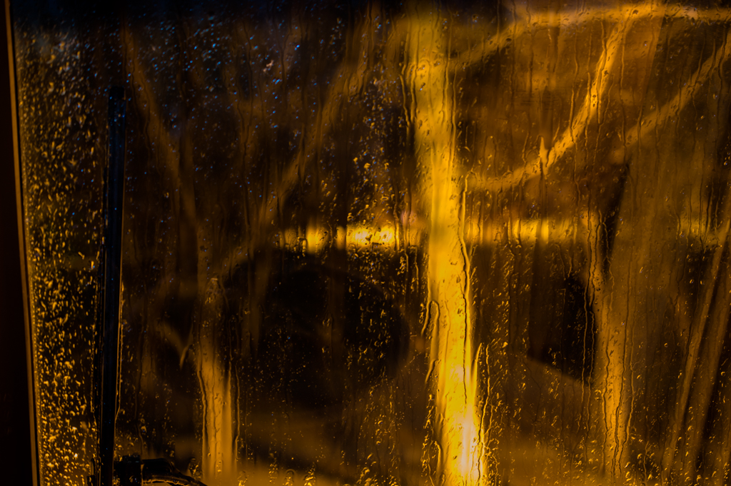

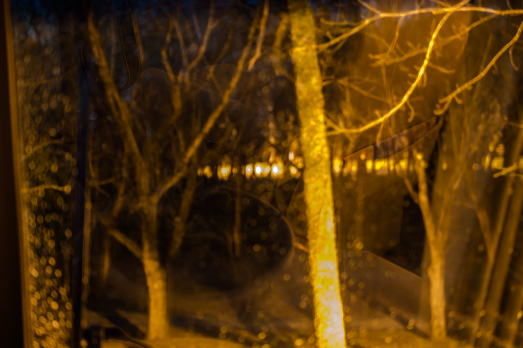

I figure go for the tough one first. This is EV -6 using f/2.8 @ 8 minutes. A night shot naturally, looking thru a window, thru the trees to a parking lot lit by overhead lights. The near trees were lit by a post lamp at camera right.
Eyelight
EV -6
Same shot focused on the window, which I think I like better. Also at EV -6, f/2.8 @ 8 minutes (480.8 seconds to be precise), which brings me to a thought to add, that the actual calculated precise shutter speed for using f/2.8 at EV -6 is 512 seconds.
dh photography
Certainly like no. 2 better myself. The first to me just didn't have any focus point to look at.
When working toward specific EV values, does it make a difference if the camera has an internal setting for exposure compensation set at anything other than zero?
Eyelight
The exposure compensation only affects the aperture or shutter if not in manual, but it does affect the exposure indicator.
This first was almost more experiment than attempt at real art. It's an area of photography I've never did much work (on purpose). I'm planning to do several more in the same EV range. Most of the trees were not visible and kind of interesting how much shows up in a longer exposure.
Excellent info, and something different to experiment with that I knew nothing about (not hard to find). I was curious how that worked since I had taken more bird pics for the weekly challenge, but didn't use them after seeing my exposure comp. was left at +3 from a previous shot. I was in M mode and wasn't aware it didn't actually affect the exposure when shooting in that mode.

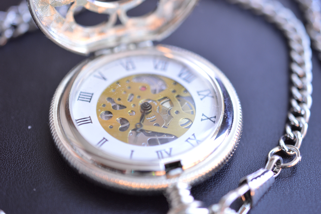

After the initial trial run, wanted to try something not usually seen with a long exposure. I had to add a few seconds to the shutter open time due to losing aperture diameter to the closer focus.
f/3.2 @ 646 seconds
f/3.2 @ 649 seconds

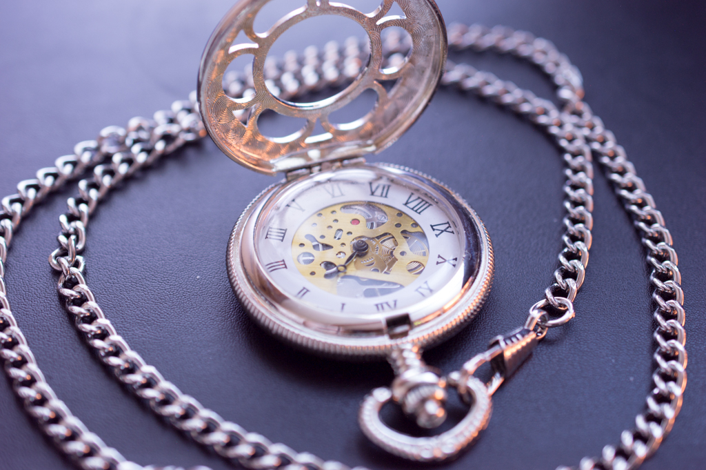

One more EV -6 before we move on.
The enlightening thing about these long exposures is how little light it takes and how well the modern digital sensor performs. The light for this shot was a combination of street light coming thru closed shades across the room and the laptop screen which was facing away.
I had the NR turned off earlier and decided to leave it off. There is some noise, but not real noticeable.

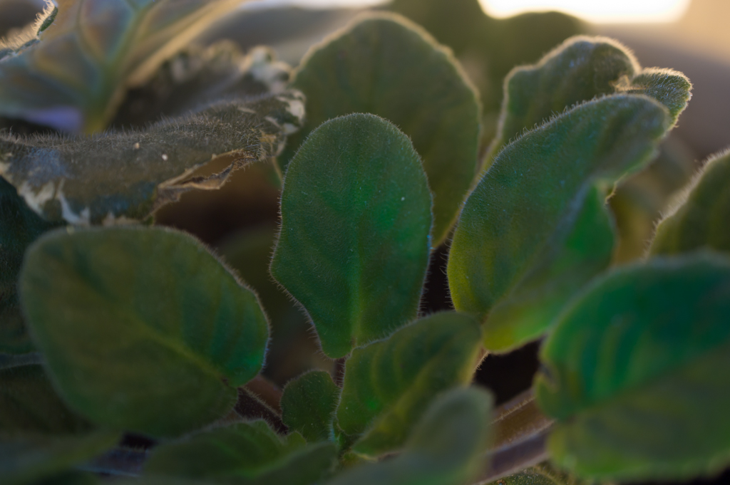

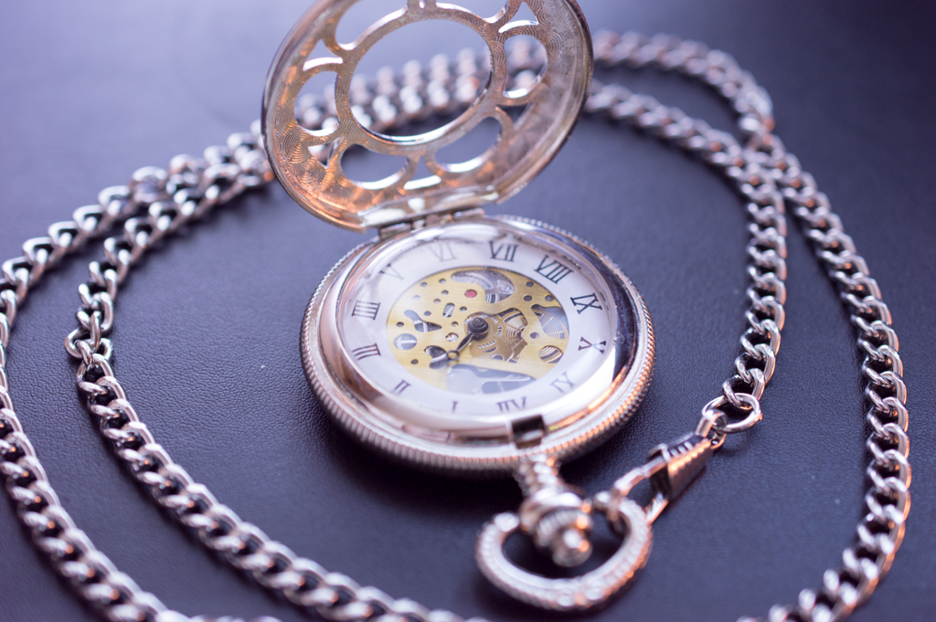

Eyelight
EV -4
Getting behind on this thread so figured I better get after it. This is one of a few EV -4 shots in a trial and error to see what light I need. This one a little dark and not much DOF
f/5.6 @ 8 minutes and 33 seconds (SOOC)
Decided I'm going to add some processed versions.
