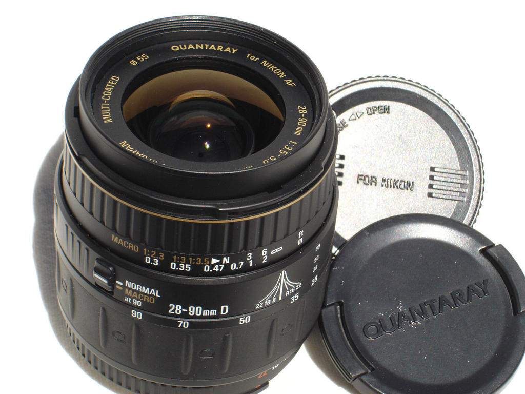

You mean this one?
Yes, it will. But it will not auto focus on your 3300. You should get a focus confirm though.
fotojack
Your D3300 does not have a built in focus motor. The lens you're asking about does not have a built in focus motor. Therefor, you can manual focus only. Your camera requires any lens you put on it to have a built in focus motor to auto focus, such as any Nikon lens that says "AF-S" on it. Other brand lenses that have built in auto focus motors will work, too.
Bensnikon
Thanks for all the helpful information. It was a steal on Ebay for $39 and I figured that I could live with Manual focusing, since I was going to be doing mostly macro photography with this lens....autofocus was not a necessary option.
The vender confirmed that I should be able to focus manually with it, so for the price it cost I see it as a nice complement to my lens collection with a limited purpose, but useful nonetheless.
Thanks again to all who helped me with this decision.
