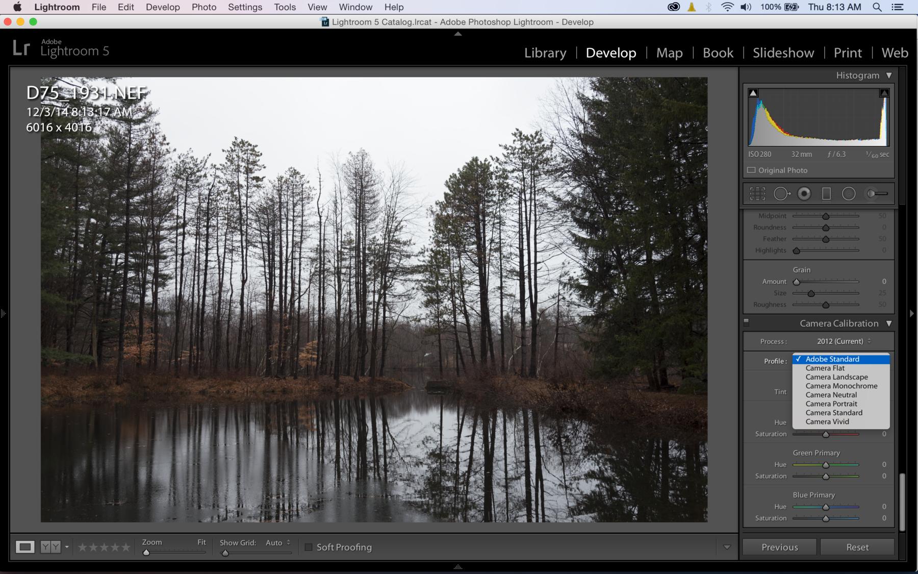

Jake, where do I find the area to change the Profile to Camera Standard? I see options to Enable Profile Corrections which gives me a choice of Default, Auto, or Custom but nothing else. Thank you!
BackdoorArts
In the Camera Calibration module at the bottom of the stack.
