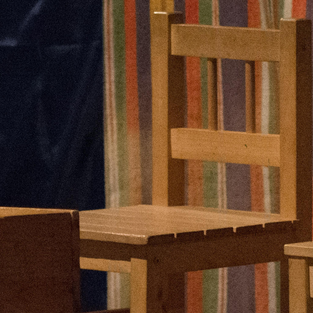

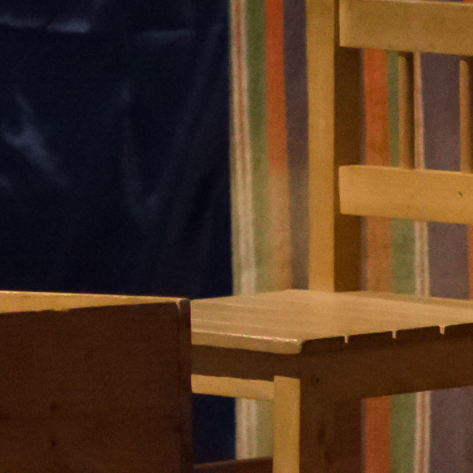

To add why I tweak the blue channel in cam calibration.
Some will say that adjusting the saturation in the blue channel (which contains most noise) will make things worse but in my experience it does help. While it doesn't necessarily gets rid of noise, it makes the colors over-pop noise and in that, it becomes less distracting.
Here's a shot with a normal blue channel and a second where I upped the blue saturation to the max. It's 100% so that always looks worst. In the full shot, the effect works best.
For many shots adjusting the blue channel does very little harm color-wise and it can help a bit with noise.

That does look better - I hadn't heard about the blue channel linked to noise - Another good tip! Thanks!

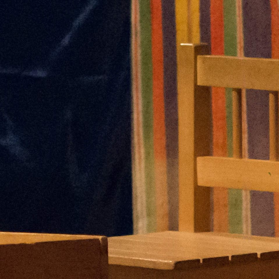

I saved as a TIFF and used the (non)practical noise reduction in the individual channels in my old PS. I did heavy reduction on the Blue, half of that in the Red and none in the Green. I then saved and went to LR again upping luminance noise to 20 and slightly increased exposure, contrast and a bit of saturation to compensate for some losses.
It's not completely gone but it doesn't rule no longer. With some fine-tuning you probably get better results.

That looks much cleaner J-see, I'll have a good crack at that tonight - It looks like working on individual colour channels is the secret! Thanks very much :)

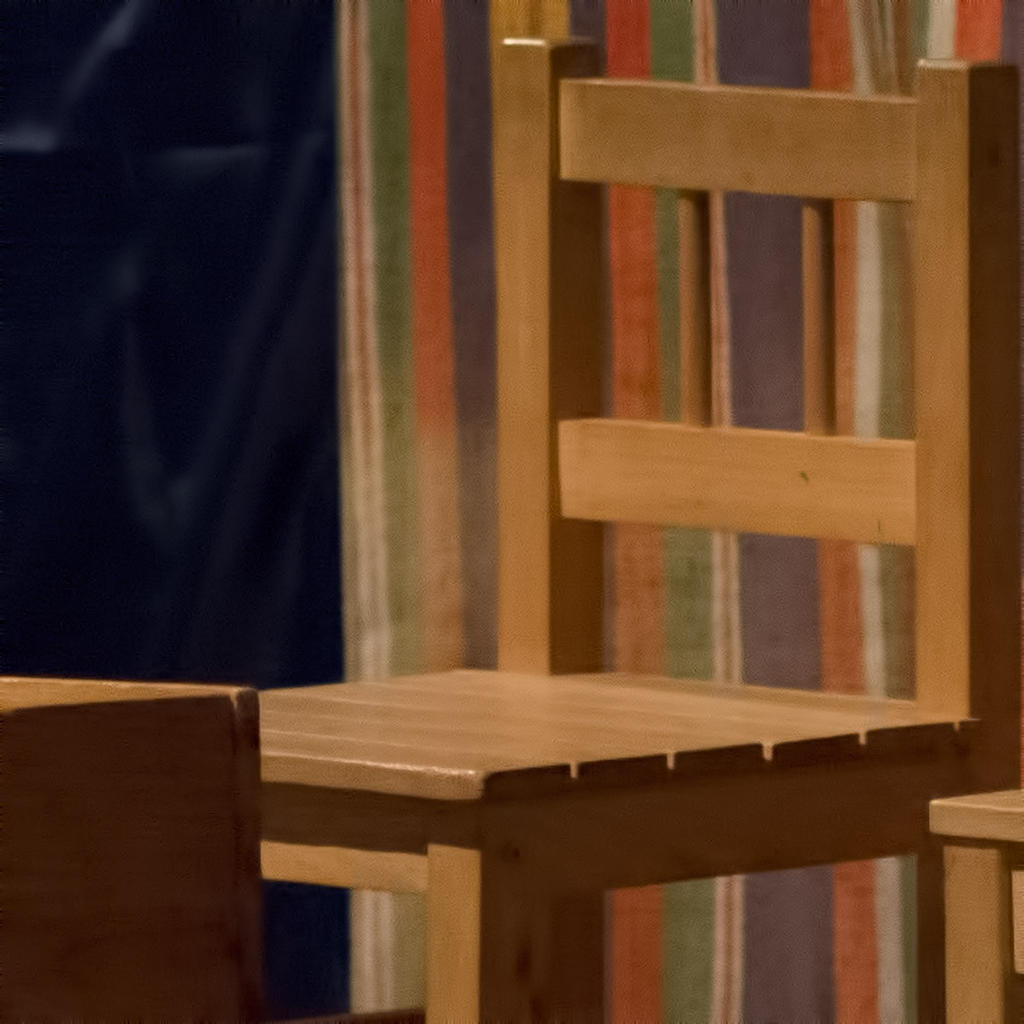

If you really want to process quite a lot of shots then here is what Topaz Labs DeNoise 5 can do in a single click.
These are 100% crops of your original
1st original
2nd setting set to RAW moderate
3rd set to RAW strong.
