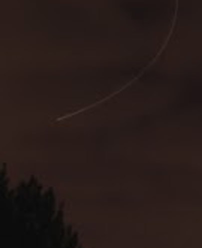

I bought my D3300 factory refurbished on BuyDig.com. I noticed there was a very big smudge spot on the sensor so I sent it in to Nikon for cleaning. Upon getting my camera back, I noticed these strange "black lines" running throughout all of my photos, most visible against smooth and dark backgrounds. Here's my best description of these black lines:
  • All black lines are exactly 1 pixel in width, and between about 1-100 pixels in length.
  • Most prominent against darker areas of the photo.
  • When shot in landscape orientation, lines run vertically. When shot in portrait orientation, lines run horizontally.
  • Lines are perfectly straight, at 90 degrees when vertical and 180 degrees when horizontal.
  • Noticeable at 50% zoom, obvious at 100% zoom, extremely obvious at 200% zoom.
I sent a complaint to Nikon support and talked with 4 different techs. 1 tech says he sees them as obviously as I do. 3 of them say they don't see what I'm talking about. Unfortunately my last correspondence was a supervisor and he says that while he does see them, they are "perfectly normal" and merely compression artifacts. So I am reaching out to the community to help me verify if these are indeed merely compression artifacts.
I've done my own research on this subject and downloaded some sample RAW photos taken with the D3300, and none of those photos exhibit the same black lines that I see in my photos. So I'm inclined to believe that the Nikon techs are pulling their answers out of their asses.
Keep in mind that I see these black lines on both RAW and JPG pictures. They are clear and easy to spot in RAW, a little muddy in JPG but still visible.
https://drive.google.com/file/d/0B2Eppt2fJu47bjVhZUV0WEJOYlE/view?usp=sharing (Look against the clouds)
https://drive.google.com/file/d/0B2Eppt2fJu47azU5TFhXeVRFTmc/view?usp=sharing (Most pronounced near the left and right edges of photo)
https://drive.google.com/file/d/0B2Eppt2fJu47cjRkOGJkalM2d0k/view?usp=sharing (Most pronounced near the left and right edges, where it's darker)

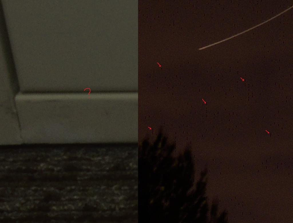

Here's a side-by-side comparison between the RAW photo the Nikon tech took, and the RAW photo I took. His is on the left, mine on the right. They are cropped at zoomed in to 200%. I've marked with red arrows the black lines that appear in mine.

I chose these photos because it's where the black lines are most obvious. Also, as mentioned, they only appear against dark backgrounds so you will not see them when taken against the bright sky.

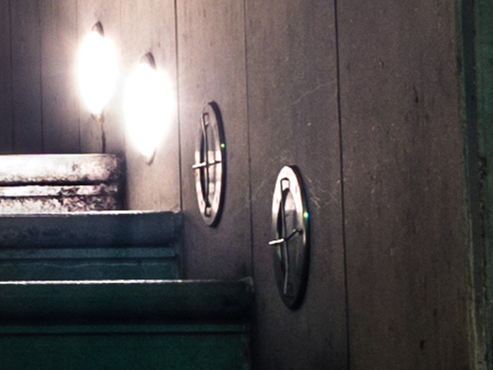

I've been looking at the shots in PS at pixel size and I seriously don't see what concerns you. I see noise at that level but nothing that looks like a pattern pointing to damage.
If there is any damage or dirt on the sensor, it should be visible no matter what you shoot.
TedG954
No body views photos at 200%. If the problem shows up at 50%, why wouldn't you post those? If you have to "hunt" for defects, there probably aren't any to be concerned with.
J-see
This is the shot at 300% when opening it in PS. I didn't change anything, just cut, scaled and saved.
No dots or lines on my screen.

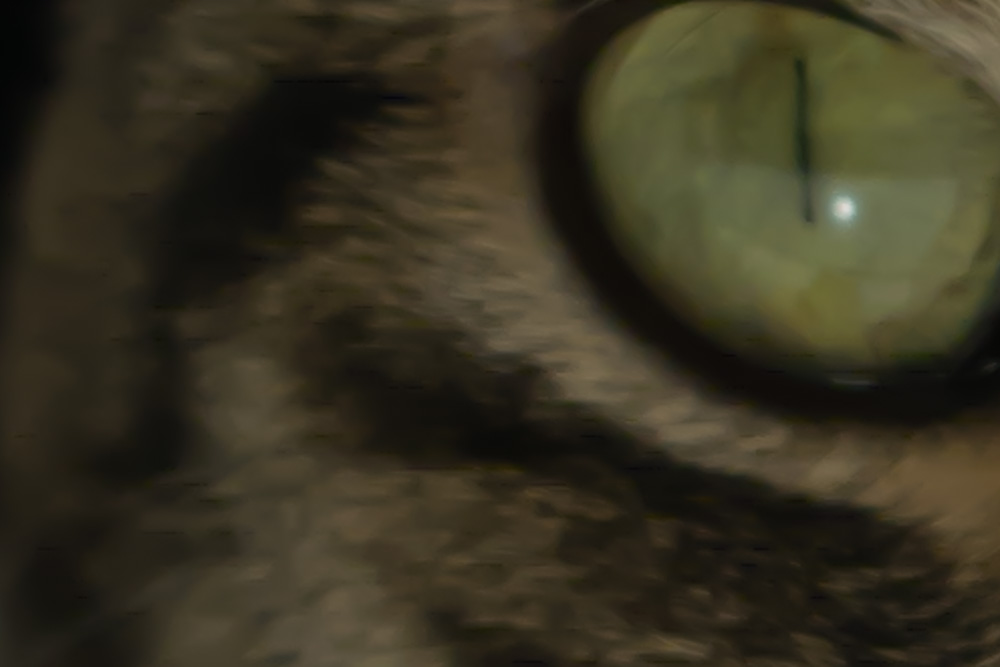

Alright, here's a "real-world" example (even though my night exposure shot is also a real-world example). This is a RAW image taken of my cat with bright white blinds in the foreground. Since there is such a wide dynamic range between the white blinds and the cat + interior, you'll see that the picture had to be under-exposed and taken in RAW in order to bring out the details in PP.
https://drive.google.com/file/d/0B2Eppt2fJu47N2RBOEs1VHN3TjQ/view?usp=sharing
Below is a JPG I've uploaded of the same picture with red arrows showing the black lines. In this case, since the picture was taken in portrait orientation, the lines run horizontal. I've also only zoomed in to 100% for the sake of argument.
http://i.imgur.com/KTxAtMK.jpg
EDIT: it appears as if attaching images on this forum reduces the size and quality, it's best to view on the imgur site.

Yes it is everywhere, I just pointed out a few with red arrows because people keep missing them.
Why do you think that's regular noise pattern? I've never seen noise like this before. Noise should be random, this is not random. Noise also doesn't present itself as clearly defined and perfectly black vertical lines. If someone is able to provide just 1 example of these black lines in their photo, I will be happy.
