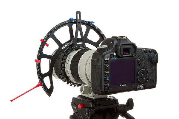

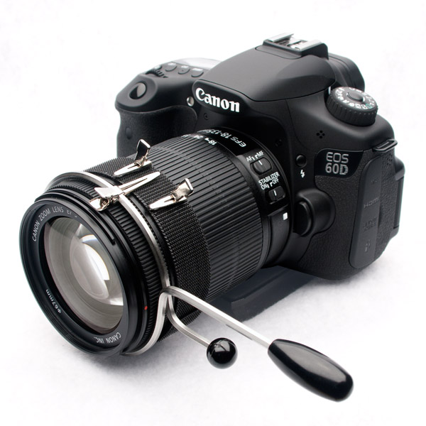

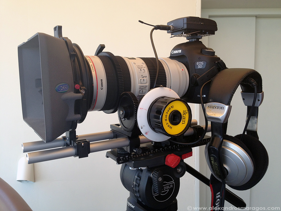

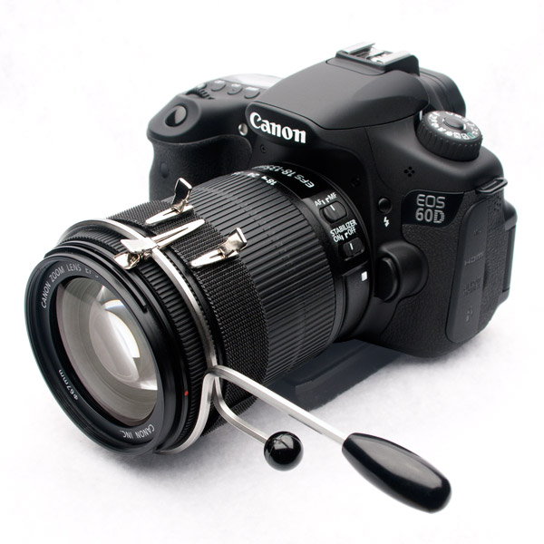

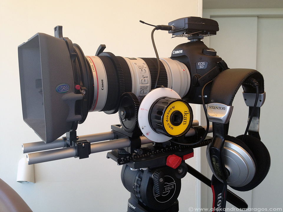

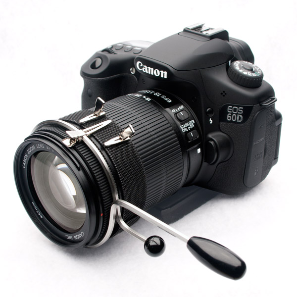

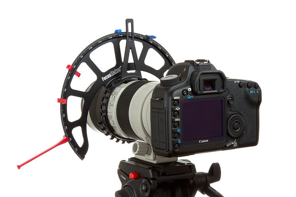

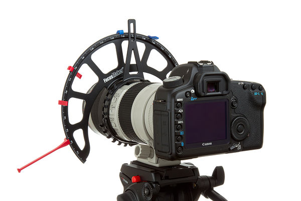

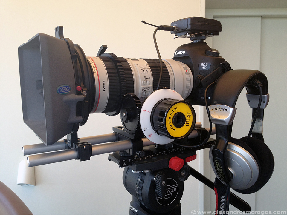

What about when you are videoing a subject that is moving - that's when you need to get a gadget call "follow focus" - to let you do a dry walk thru and then mark your focus points (literally with a marker or a paper clip) and when when you record, you can rotate the focus ring and not have to guess. "Follow Focus" comes in many different varieties, from cheap to really sophisticated rigs but that are all MANUAL Focus aids. Do NOT use AutoFocus!
I've attached some photos of follow focus rigs. Hope this helps.
