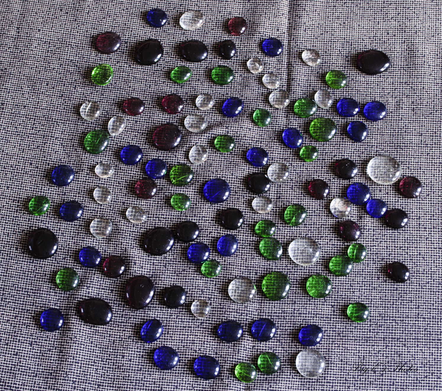

Need some comments of this image, please Did this for an exposure and metering Modular....... not sure if I got it right.
D5000
18-55 Kit Lens F3.5
1/3 Sec @ F11
No Flash
ISO 200
Many Thanks

I find it difficult to judge exposure with such a contrasty scene.
I suspect you were shooting jpeg and maybe your camera settings are vivid. You probably would be able to adjust the contrast with a post processing program (Photoshop, Paint Shop Pro, or other). I only find the black buttons lacking of detail.
Hope this helps,
Marcel

Proper exposure is more often a judgement call by the photographer. To me this shot looks to be a little underexposed. But a handfull of colored glass beads on a black and white cloth is not the best way to make an exposure judgement . What you need is a full tone scale white to black card to shoot. You also need a CMYK card to adjust colors. You can get a card with the B&W tone scale as well as the color scale and an 18% gray card for WB correction from: www.digitalimageflow.com

I agree in that this is not a very good subject to perform an exposure and metering experiment. The tablecloth alone is difficult to account for, much less adding multi-colored beads (and glass at that!) to the mix. In summary:
  • High contrast patterns (such as black and white) are difficult
  • Multiple colors are difficult
  • Glass is a difficult texture because of its reflective property
I also agree with Mr. Bautsch and think this appears to be at least half, maybe up to a full stop underexposed.
Your D5000 has an exposure bracketing feature, though I believe it is limited to 3 shots. Read up in your manual how use this feature if you don't know how already.

I agree with Joseph and Anthony. The tablecloth is the part that I found difficult to account for. There's a mixture of blue, black and white in there. Too contrasty for making a judgement on. Try the recommendations by Joseph and Anthony, Big E. A grey card would be helpful, too, to set your metering.

Hi all thanks for the help, guessed I was out, have ordered gray card set as suggested will run camera metering tests when it arrives. I feel the d5000 is a bit out tried home made gray, black, White as test, to get real black had to go -4 and White +3 , gray was -1 or +1 will see what happens with proper ones.
