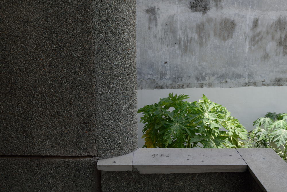

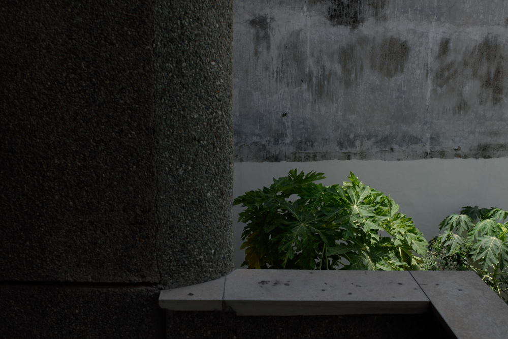

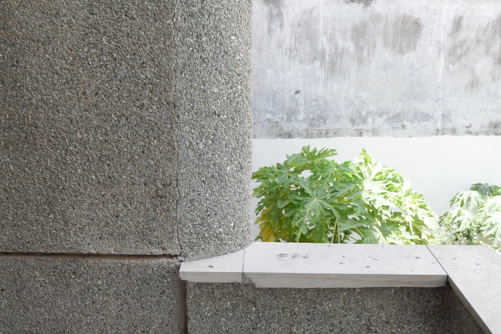

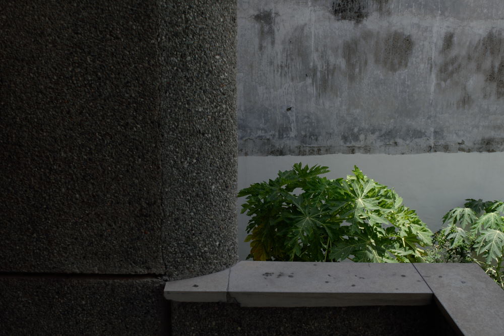

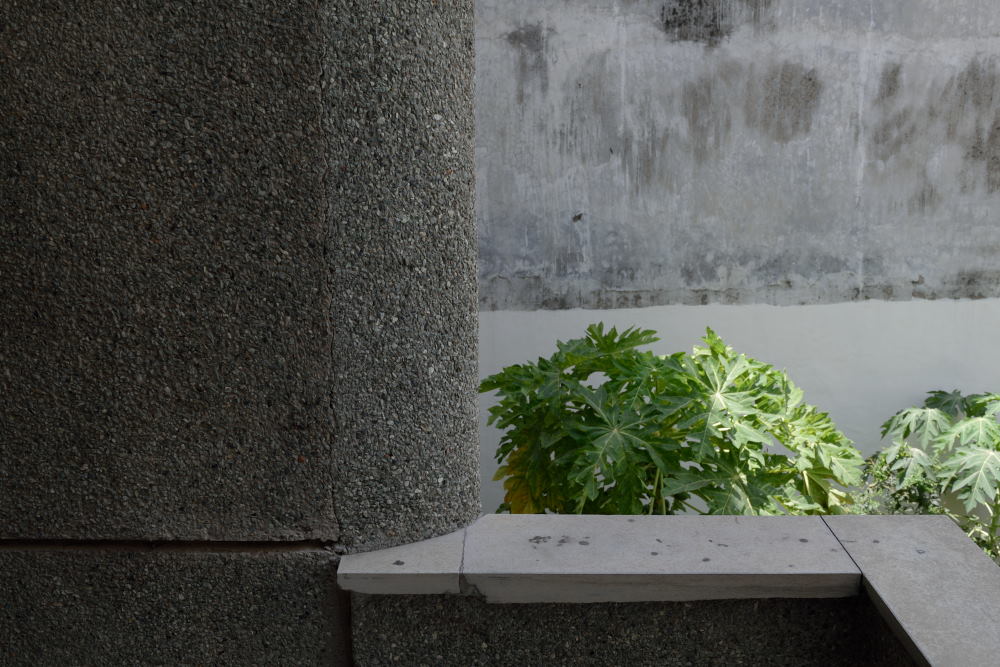

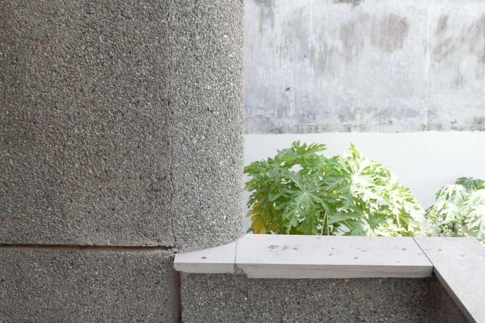

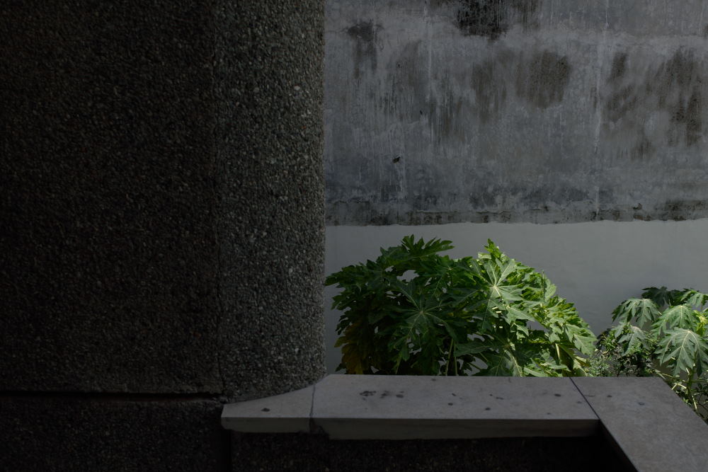

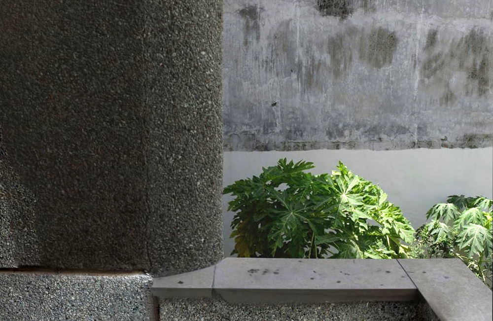

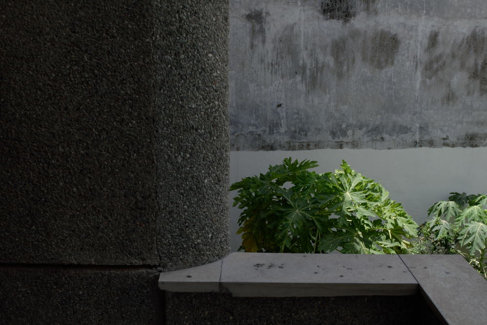

For D3300 the manual states 3.5mm circle centered on selected focus point. Just checked it. Framed a scene with graded light - extreme left dark wall, extreme right bright sunlight with brightness dropping from right to left. In aperture priority with ISO 100 and F11 selected, the speed varied from 1/100 to 1/15 as I kept moving the AF point from right to left.
So if you use spot metering option it will meter at the selected spot, but you have to select single point AF and AF-S modes.
here are the shots
Stiched image
