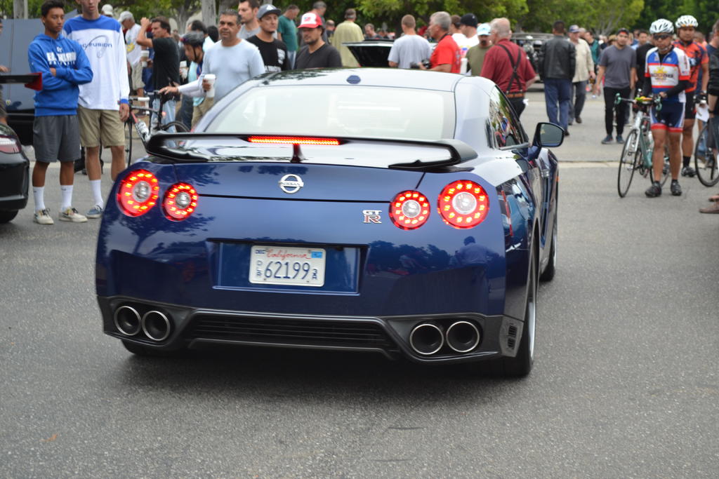

Hi everyone.
I apologize I should have provided some more info and an example as Gorf suggested.
The cars are usually static, I use my 18-55mm lense the most often at shows and meets.
But then something like this happens.
You'll notice there's a bit of blur. Which is a real shame because the pic had potential. The car was leaving the show and my positioning was advantageous but I had little time to act. My camera was also set to aperture priority since it was a car meet and they're static. Though it wasn't really moving fast it wasn't waiting for me either and as you can see there is a swarm of people so naturally I acted quickly without adjusting the settings and hoped for the best. I most likely zoomed in closer and the image probably suffered from the natural vibrations of my hand. Hence my problem. I need something to keep the camera stable. After reading some of the comments I'm leaning toward a mono pod. But of course I would love to hear more advice and suggestions. Thank you!
RocketCowboy
How do you have the AF system set for your pics? Granted I'm just viewing from my iPad, but the lower right side of the car looks sharper than the left side. Could the AF have locked on to something there since it was closest, so the problem is more DOF vs focus? Just a thought...
I'd opt for the monopod as well, for as quick as this shot developed, I don't think you would have had the time to get a tripod to and set and the shot snapped. The monopod would allow you to react quicker, although unless you had it set and ready there would still be some delay there too.
1/25 a second is really to slow to shoot this. Any movement from anyone is going to blur. Go to ISO 400 and shoot faster and that will solve your problem and you can shoot hand held.

Motion blur. A tripod or monopod is not going to help. You have to shoot at a faster shutter speed & if need be bump up the ISO to get you there.

search231GT
Thanks for the advice guys! I think I'm going to go with a mono pod. I'll also try working with the ISO next time I go out to shoot. Learn something new everyday!
