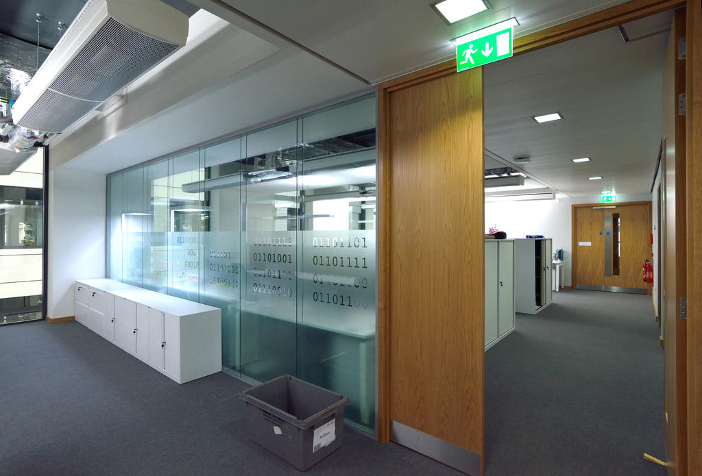

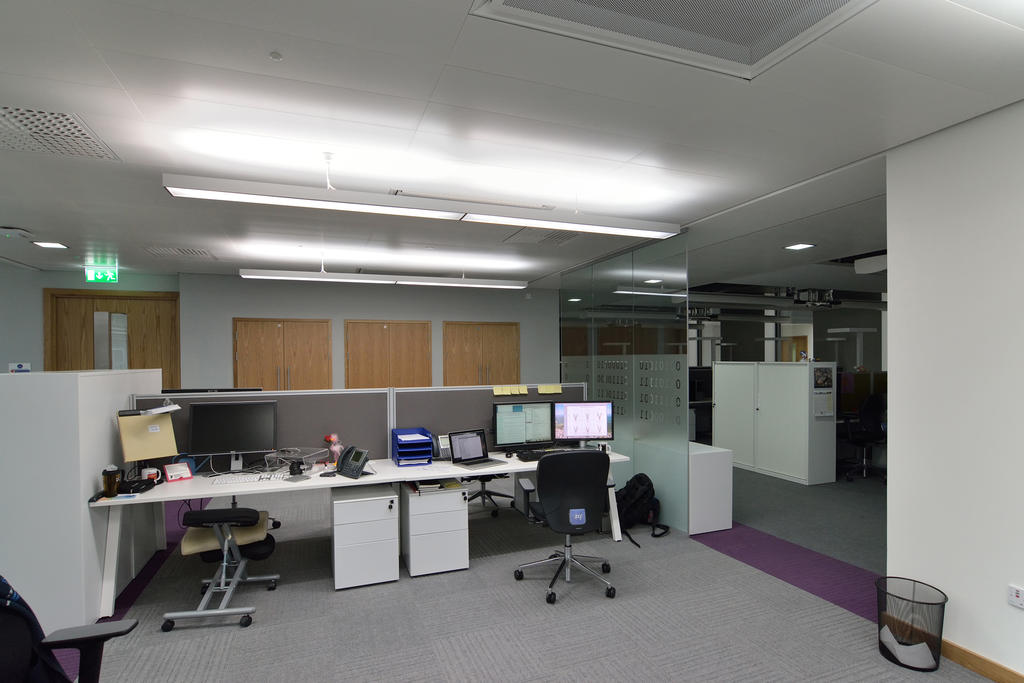

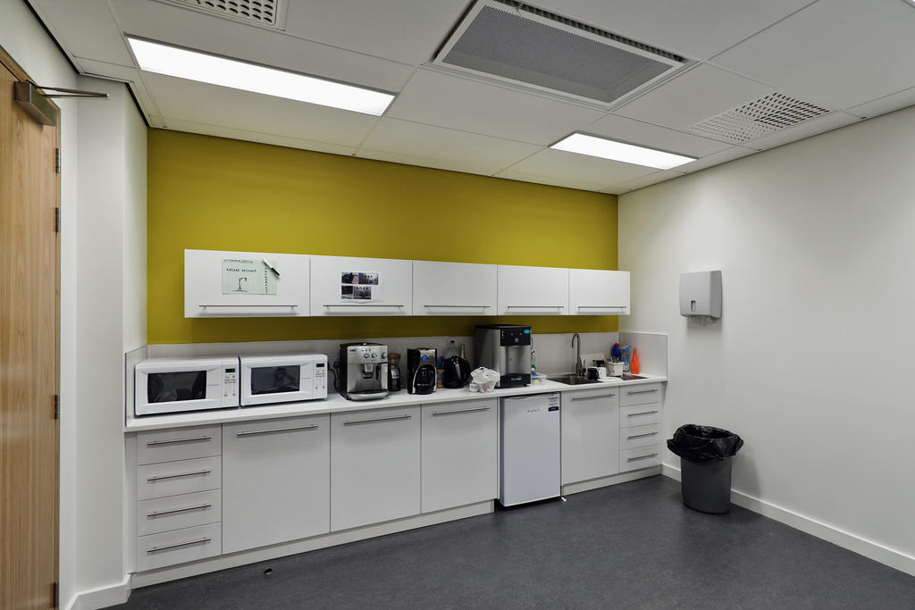

I used Tokina 11-16 mm f2.8 AT-X Pro DX II to take a few pictures of our office space. It has an advantage of being fast (f2.8), so you can take pictures in low light. When you use an ultra-wide angle lens for interior photography, make sure that you point your camera straight ahead, i.e., do not point it down or up. Otherwise, you will end up with distorted converging lines that are difficult to correct.
Here are a few pictures taken with this lens. I kept the camera horizontal each time and corrected any remaining distortion in Photoshop.
