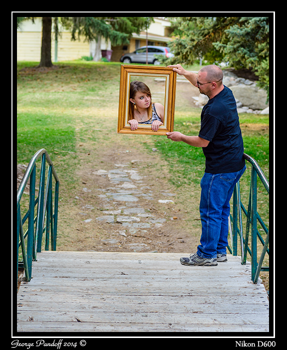

WOw sweet picture. How did you get the images lined up? did you hold the frame or was it mounted and you made it look like it was held? I like it. made me smile.
Moab Man
Really easy to do and I will gladly share.
1. Set up my camera to get the exposure and composition I wanted. No people just the bridge.
2. Daughter and I walked on to the bridge with me holding the frame.
3. She then put her hands onto the frame and leaned forward and through just slightly.
4. Snapped the second picture of the two of us.
5. Stacked the image and reduced transparency on the top layer (bridge layer) to see the bottom layer of my daughter and I.
6. Slowly erased the top bridge layer essentially erasing us INTO the photo. Using a hard eraser I followed the inside edges of the frame area to erase in the frame and its content but not her legs, body, or elbow.
7. Set the top layer transparency back to 100% and flattened image.
This was just a fun photo I did to try out this technique I had dreamed up. In the future I plan to do some more with this type of image, but at a much higher quality now that I have proven the technique to myself. It's truly a lot of fun to do and people get a laugh out of it.
From doing this... this is why I suspect he erased himself out of the architecture photos to an underlying layer. Stationary camera with no changes in each shot. Stacked two at a time, blended for what he wanted, and erasing himself out. Flatten layers, add a new layer, and repeat.

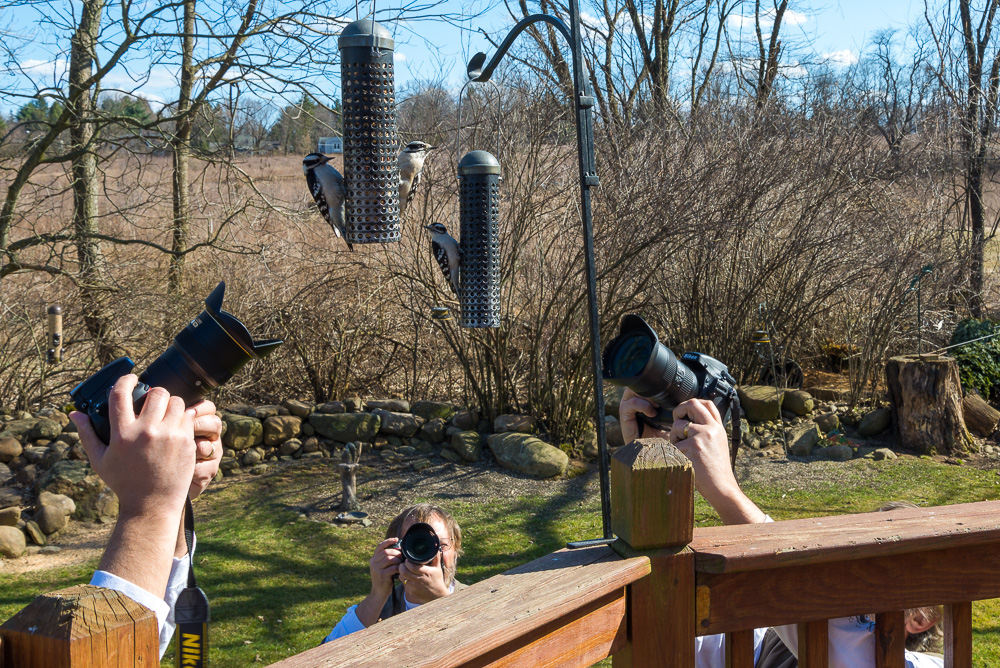

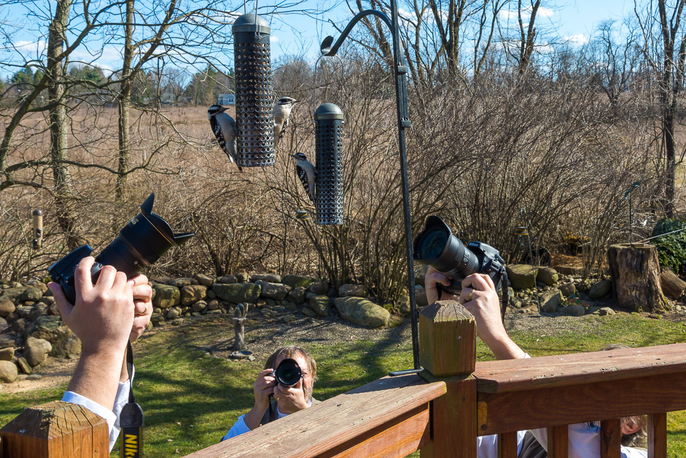

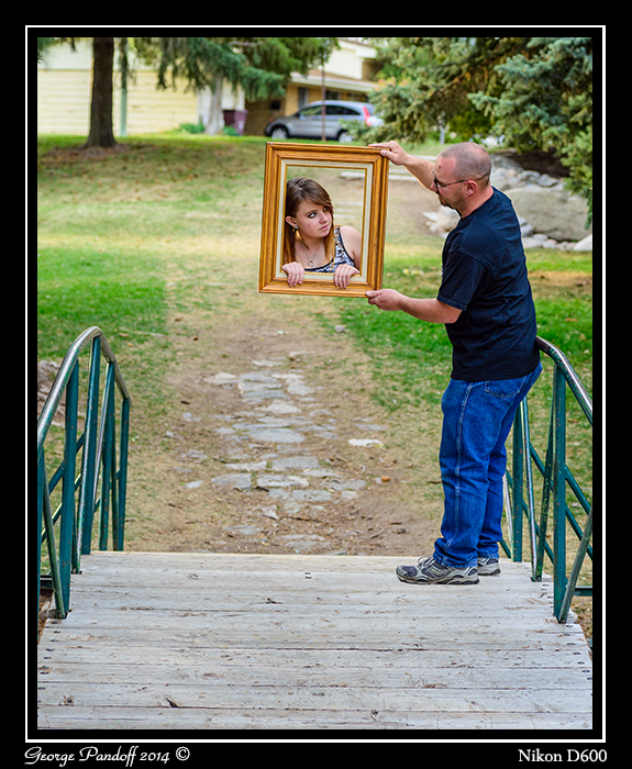

Basically the same thing I did with this shot.
6 frames, 3 of the birds, 3 of me, all taken with a single camera on a tripod triggered remotely. Pull them into Photoshop as separate layers, mask out all but the bottom layer and then use the masks to paint in what's missing - either with the brush or use the selection tool and create the masks from that.
Trial and error at first, but when you get the hang of it you can do all sorts of cools tuff.
