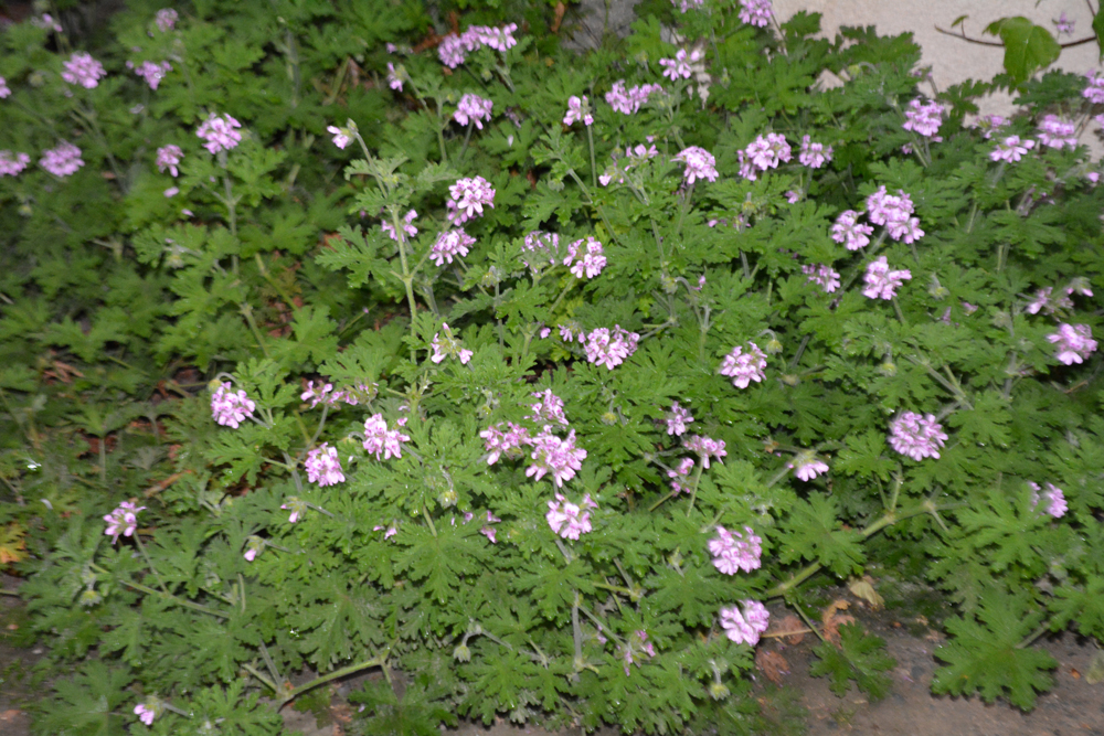

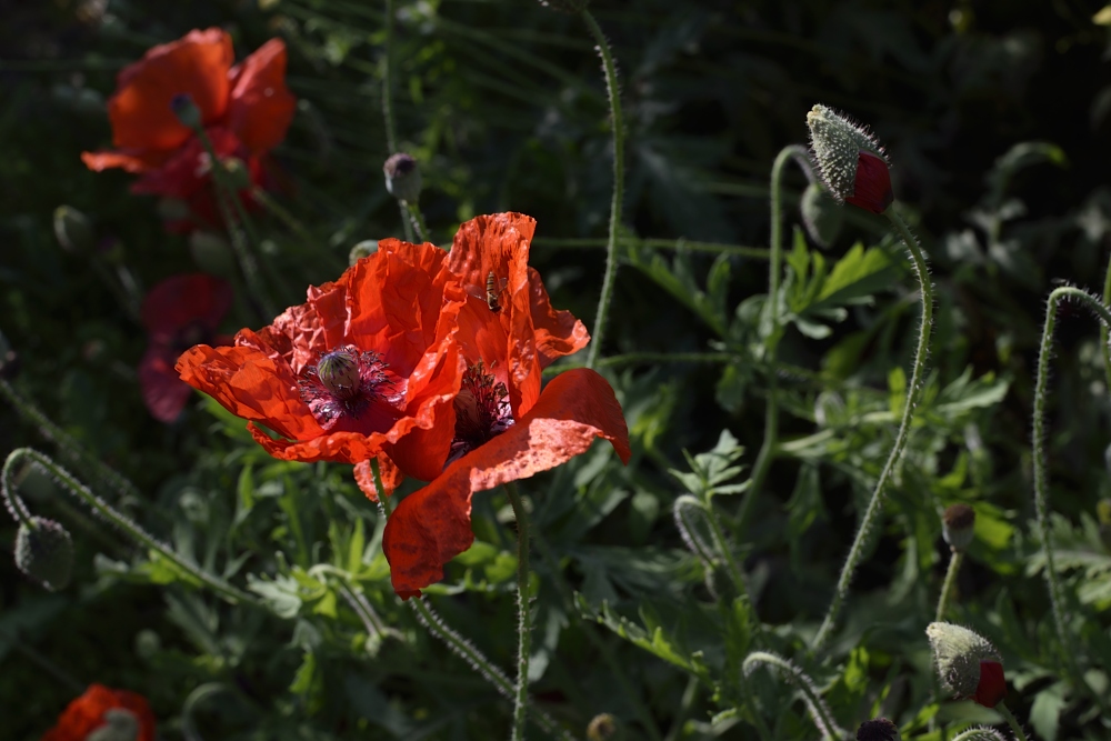

Here are 2 pics. You can see the blurry part on the edges
f/6.3
1/150
ISO-1000
55mm focal length
No flash
Max aperture 5
f/5.6
1/60
ISo-3200
55mm focal length
max aperture 5
flash auto strobe return

Try to get another lens from a friend, preferably a prime lens and do a few shots just to make sure that your camera's lens mount hasn't been affected. It could have mis-aligned the lens and could be a major fix... I would test the lens first to see if it's only the lens or the camera and lens.

I think it would probably be cheaper just to get another lens. You can get these under 100.00$ used. The estimate fee alone with Nikon is usually around $60 plus shipping and I seriously doubt that they could fix it for less than another one. Then if it's the lens and the lens mount of the camera that have suffered, you should have a look at your homeowner's insurance policy just to make sure you wouldn't be covered by chance.
