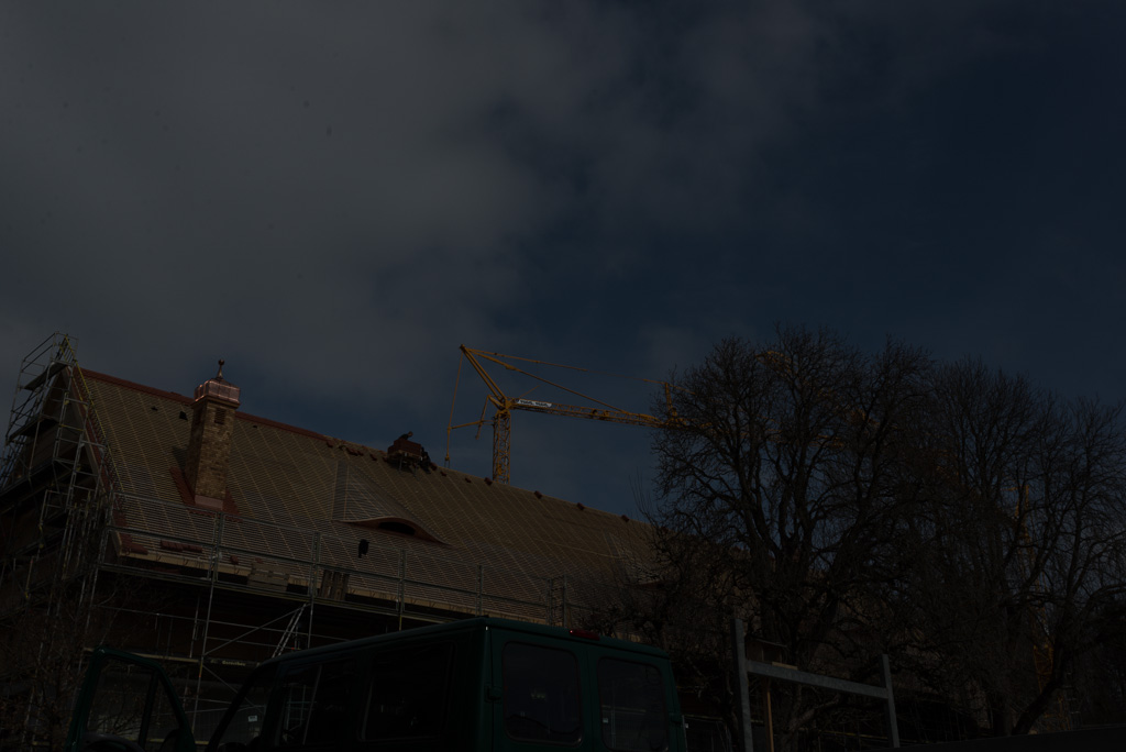

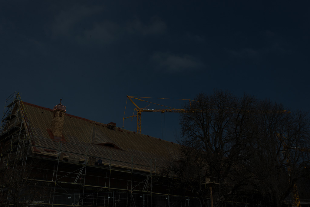

And here are 3 pictures: the first, middle and last. EXIF should be in them so if you want to have a look, please feel free!
Looking at them separated from the sequence now, it's obviously clear that the change wasn't so gradual. It darkened mostly across the first third of the images, and after that got a little darker, but only slowly.
The problem is the first image. Even with -2/3 EV compensation, the shutter speed is simply unimaginable for ISO 100 f/16 in bright sun.
So the problem is NOT so much that the later exposures improve (1/1600 sec SHOULD BE UNDEREXPOSED), but is that the first one is so bad.
