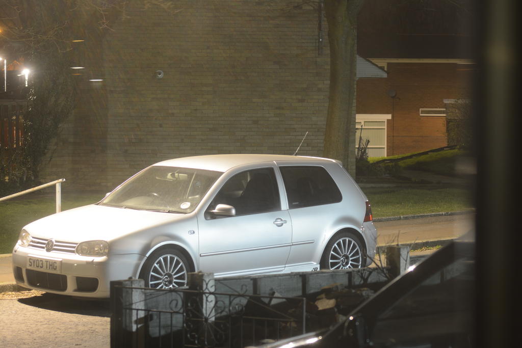

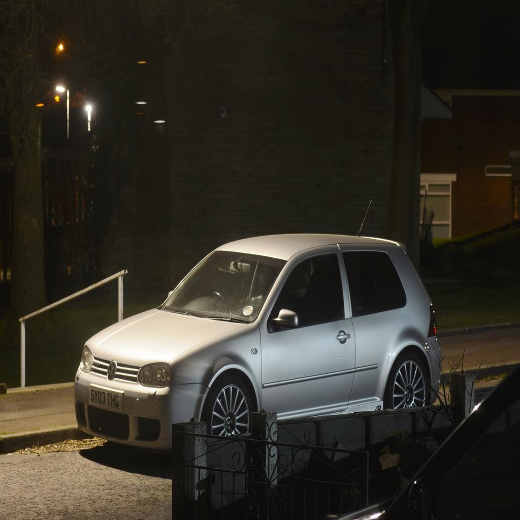

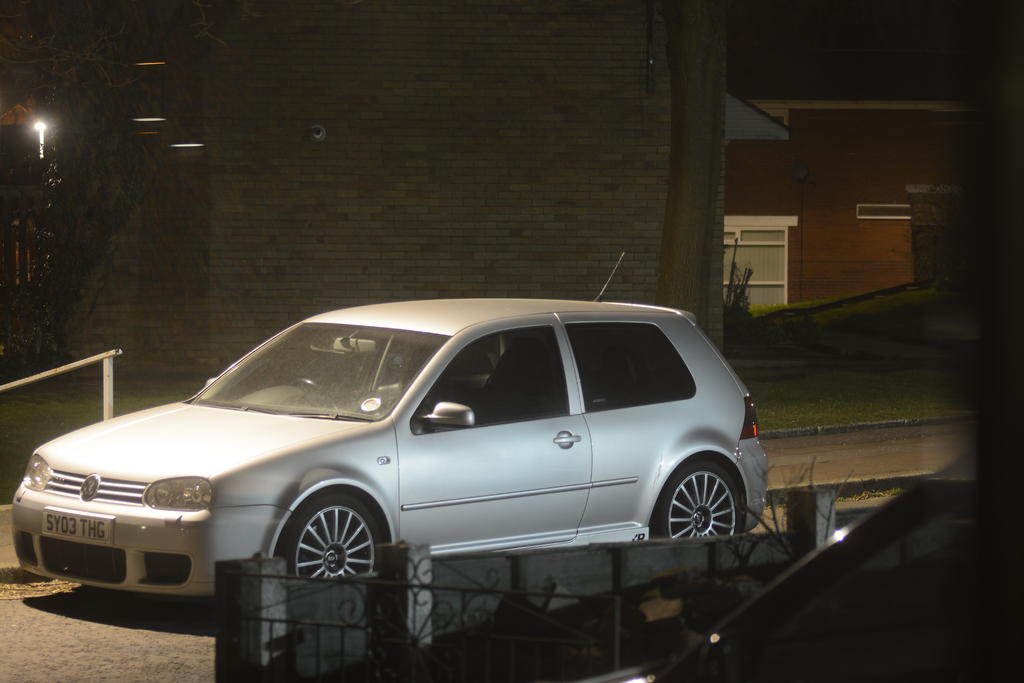

Ok its not the subject matter at the particular moment or the composition itself , I'm new to night and low light photography.
This shot was a few doors down from me and using a cheapo sigma 70 -300mm telephoto lens as well .
It not the best subject matter but its a start. 001_converted.jpg002_converted.jpg003_converted (1).jpg004_converted.jpg
These were taken from my living room window shot 3 was letting the nikon meter and was at 25 secs , my shots were under exposed according to the nikon by a couple of stops . 5 ,6 8 sec exposures .
which seems the best of the 3 . plus there is the window to take into consideration when metering .
Mike D90
I am not a night/low light photographer myself but I know this . . . you will not get good results unless you are exposing correctly regardless of subject and composition. Not sure what it is you are asking in this thread except you said "What's your verdict?".
I say try something a little more interesting and not in such a mixed lighting.
foo
What I'm asking is , is it correct to let the camera meter for you or in the case of the other shots use your own discretion .
I under exposed on the first shot then lifted the brightness a tad .
The second was untouched and the third was camera setting.
It seemed 25secs was an age for the 3rd shot. And if it had been my last camera it would have been daylight virtually.
So it seems the meter did a fair job on its own , but I preferred the last shot at 8 secs using f4 .others were at f5.6
I dont know if what I'm doing is right but I happy with the result.
