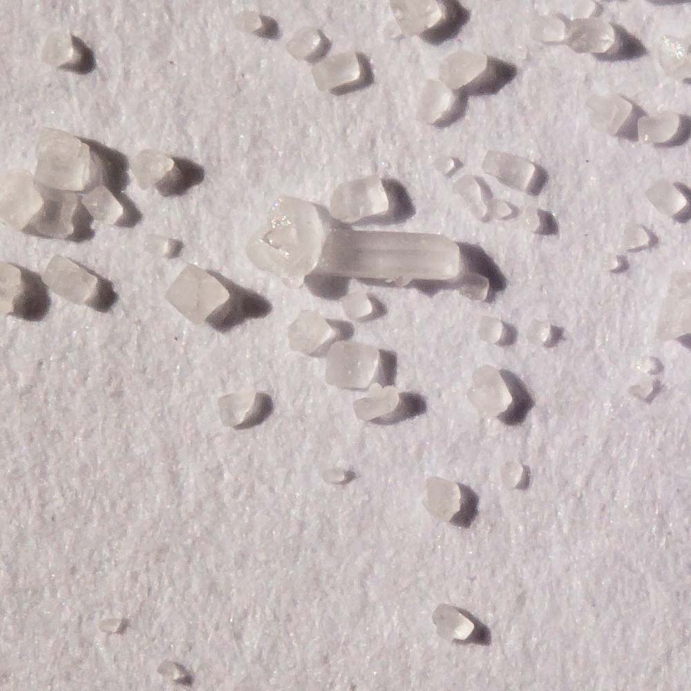

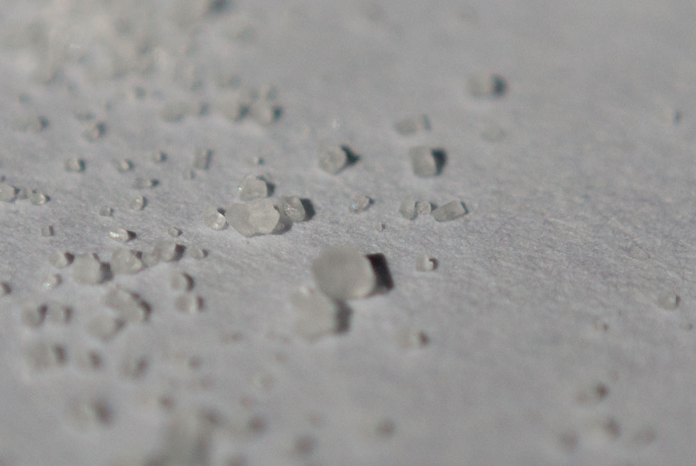

As you can see focus is kind of hard to get just right on a very small subject such as sugar crystals. Larger objects are easier and the smaller your aperture the more of the subject you can keep in focus.
On the series of shots below I was at ISO 200, I changed aperture from f/1.8 with shutter speed of 1/4000th, to f/8 at 1/2000th then f/11 at 1/750th second.

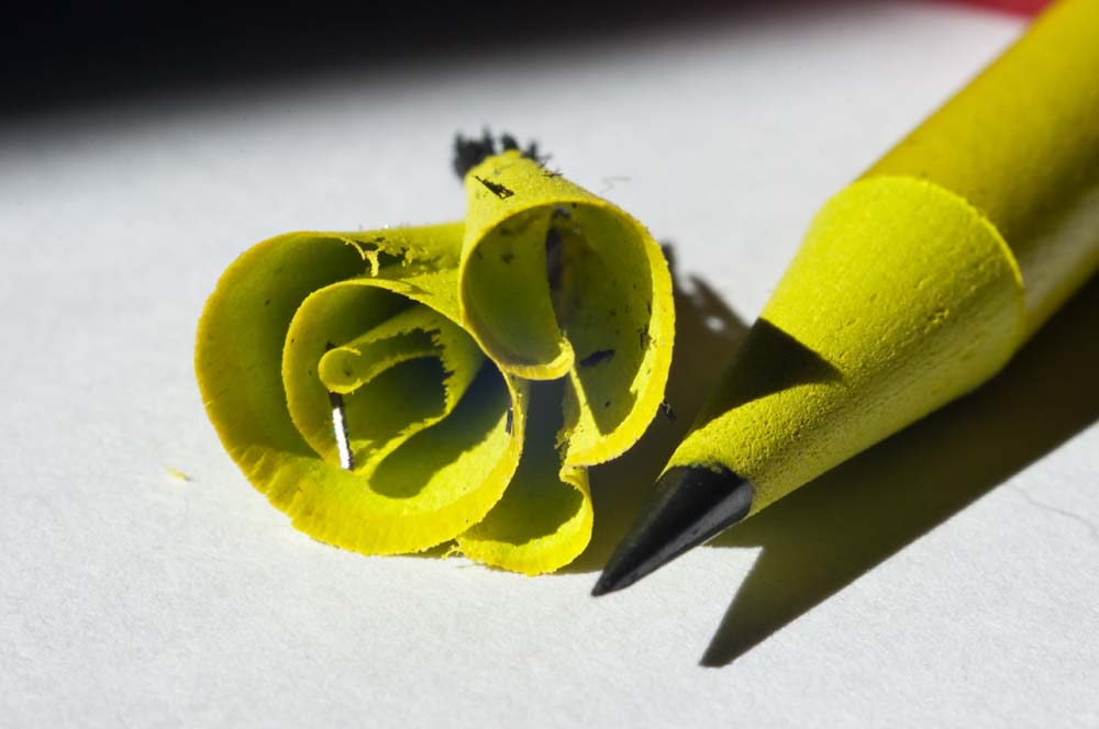

Here I used a pencil and a sharpener to get some shavings. This was easier to focus on and I did similarly with aperture to get less, then more, DOF at each shot.
The first shot is a 100% crop of the uncropped shot below it to give an example.

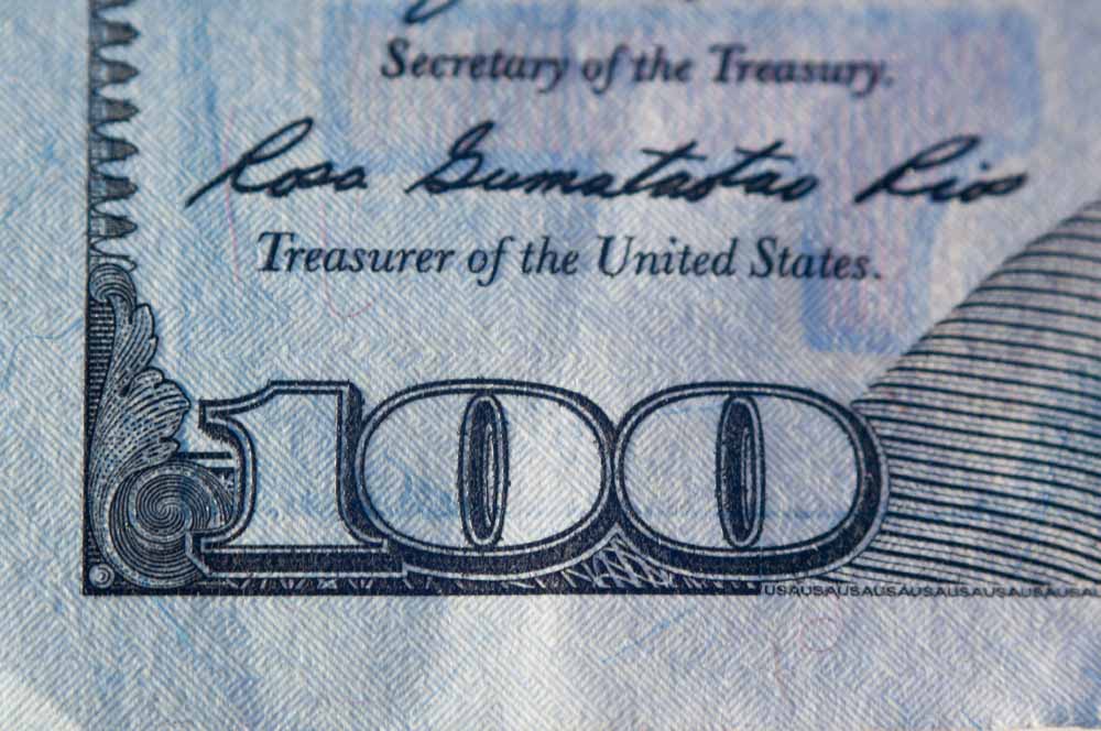

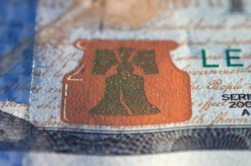

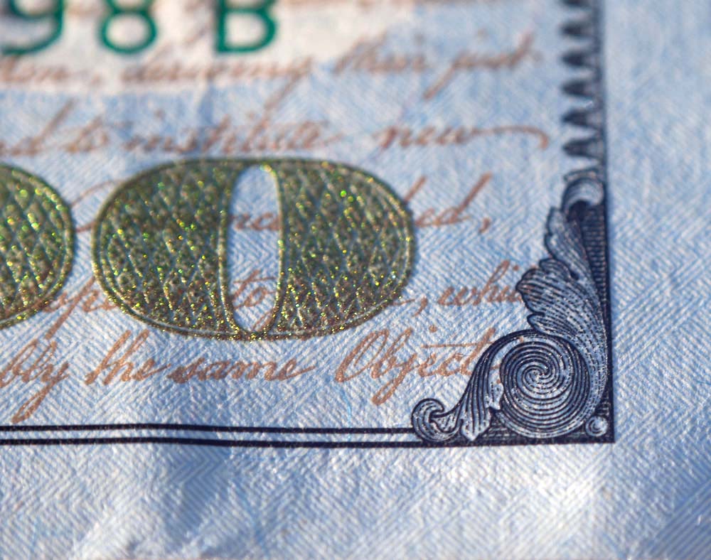

Here are some better examples of the detail that you can get with this reverse 50 rig if you are careful with the focus and have light without shadow.
This is the new $100 USD bill I got today.
None of these are cropped and none are sharpened. These are 100% out of camera, with minor exposure adjustments, and resized to 1000px on their longest side at 96ppi.
Mike D90
Bonus points if you know what the significance of the time on the clock is.

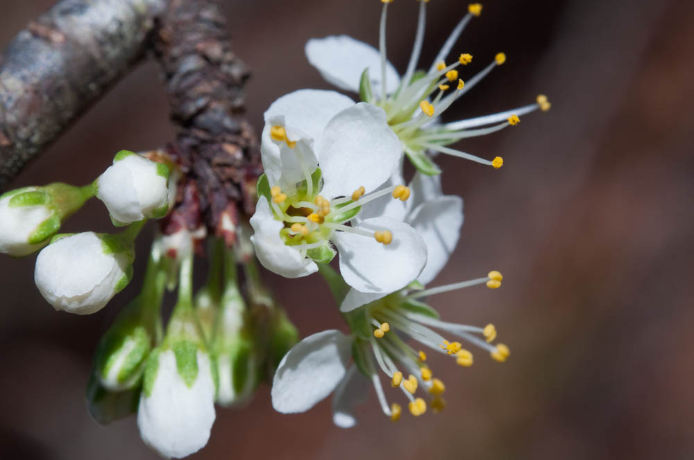

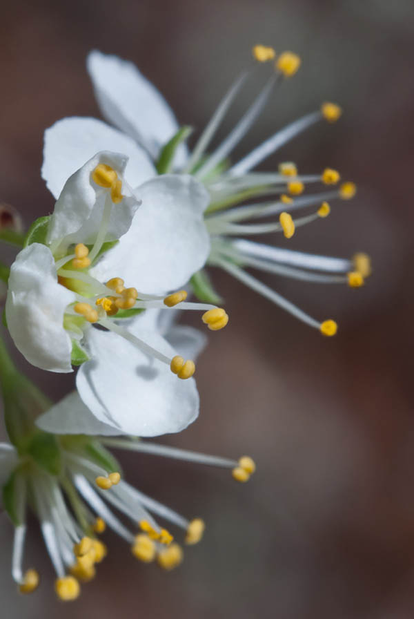

Here are some more shots with the 50mm reversed lens.
These are 100% crops or uncropped as shot.
These flowers are small. Maybe 10mm across in diameter.
