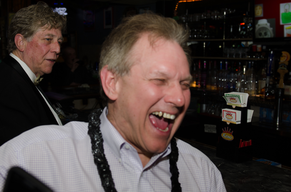

I noticed it this past week with my D7000, 24-70 and SB-800, shooting in my wife's bar. I'm using the D7K while my D600 is in the shop. I had much difficulty getting autofocus to work and had many shots with back focus issues. I don't recall having such issues with the D600 and 24-70 (or the D7000 w/17-55).Here's an example of the extreme back focus

What focus mode are you using? Do you find the problem to be consistent regardless of focus mode or number of focus points? I find the 39 point system to be OK in lower light provided you're in Single Point and work in the center. Get to the edges and it will hunt.

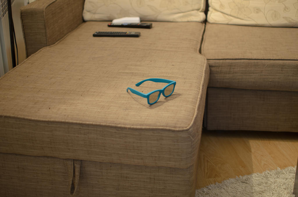

It is very bad with 35mm f1.8 G lens, 50mm f1.8 D works better, and 18-105 is even better on this. Yes, it is f3.5-5.6 and DOF is not the same as f1.8, but there is less back focus problems in low light.
It is very hard to focus manually, and Live View is really slow. AF Fine Tuning can not be used because it is not consistent.
This is taken with 35mm yesterday with a lot of light coming from the window, as you can see everything works as it should, I can focus on the eye.

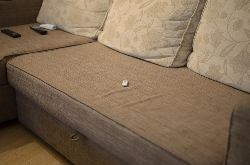

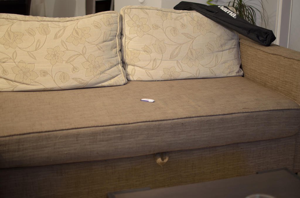

OK, here you have 15 photos taken with my D7000 and 35mm f1.8 G, all with a tripod and ISO100, autofocus on the center point.
Almost every time 35m is not in focus. My camera was calibrated few days a go, all together with all my lenses, 35m, 50mm, and 18-105, and all but 35mm works well with almost 90% accuracy. This 35mm does not focus at all at desired point when light is low, or with tungsten bulb.
There is so many people on the internet with this problem, does anyone have any idea what can be the problem?

I used timer, of course. :)
You can see focus point mostly behind the subject, there is no motion blure.
